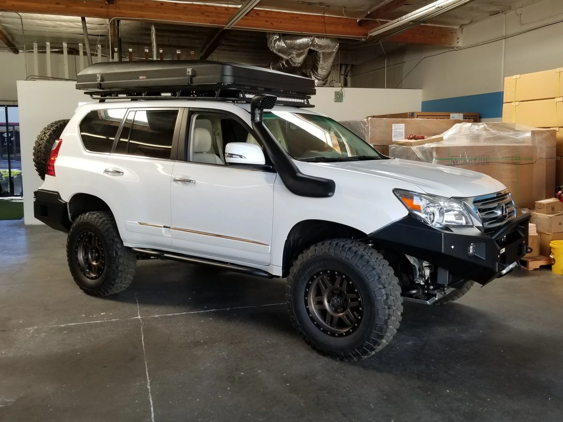

So, now to the good stuff. I purchased my armor, suspension and wheels from Metal Tech (in fact most everything was from them. I don't have time now to list everything, but I'll post more pictures and info as I have time.

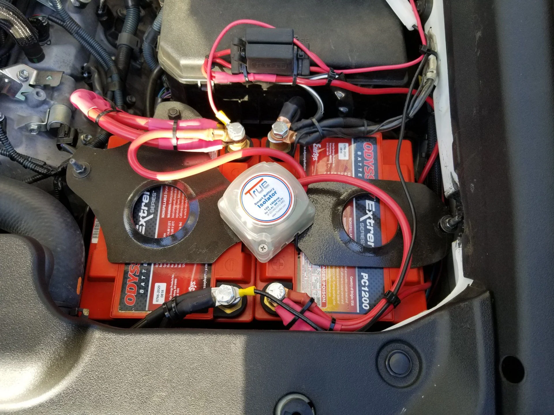

NOTE: YotaMaster did all the work!!! Owner Eric Hansen was great since this was their first GX 460 and there is NO dual battery brackets presently for them. His team had to fabricate one.
So aside from what is seen in the photos, here is the short list of what can't be seen. I have front and rear ARB lockers, re-geared (already forgot what the ratio is), dual batteries, ARB's twin compressor, Yaesu FTM-400XDR ham radio, front led light bar and proximity lights on both sides of the rack. Gamiviti roof rack. I-Kamper roof top tent.

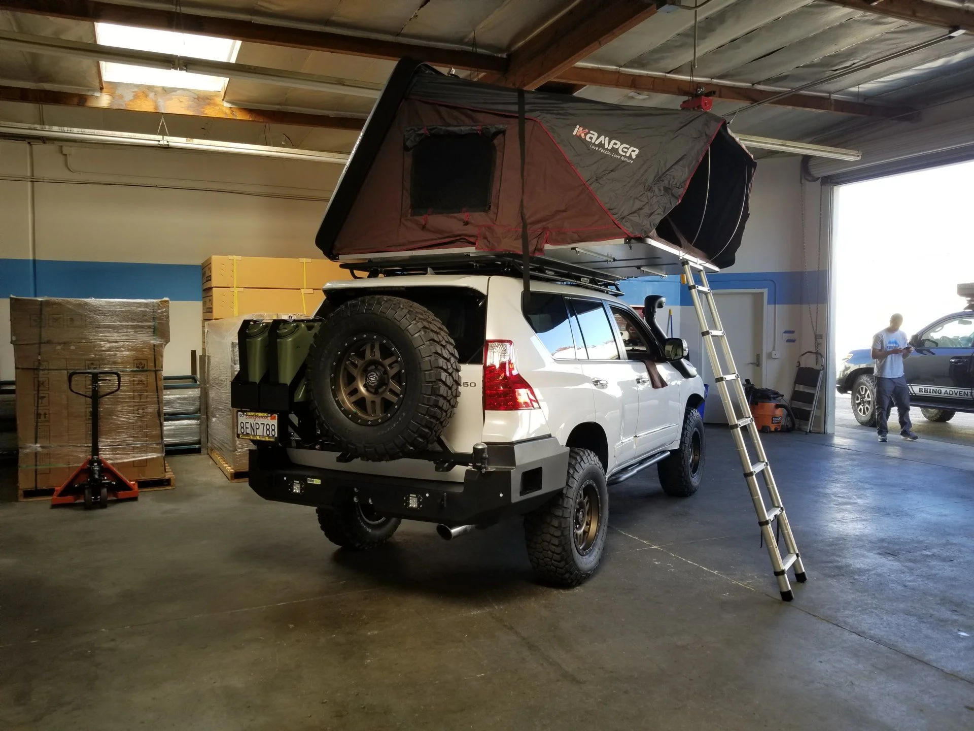

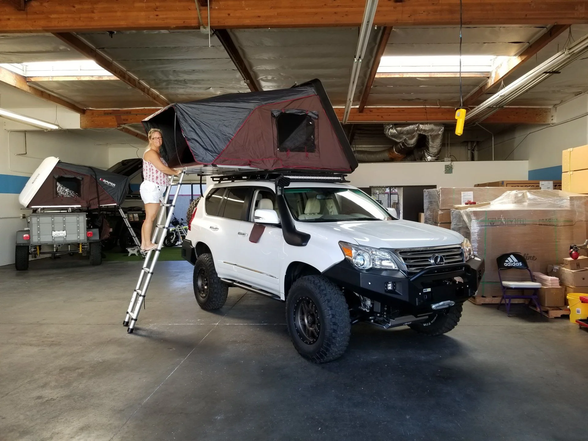

More pics, with the RTT deployed. I purchased the I-Kamper from Rhino Adventure Gear in San Marcos, CA. Joust, the owner is great to work with!!
Here's there link: Rhino Adventure Gear

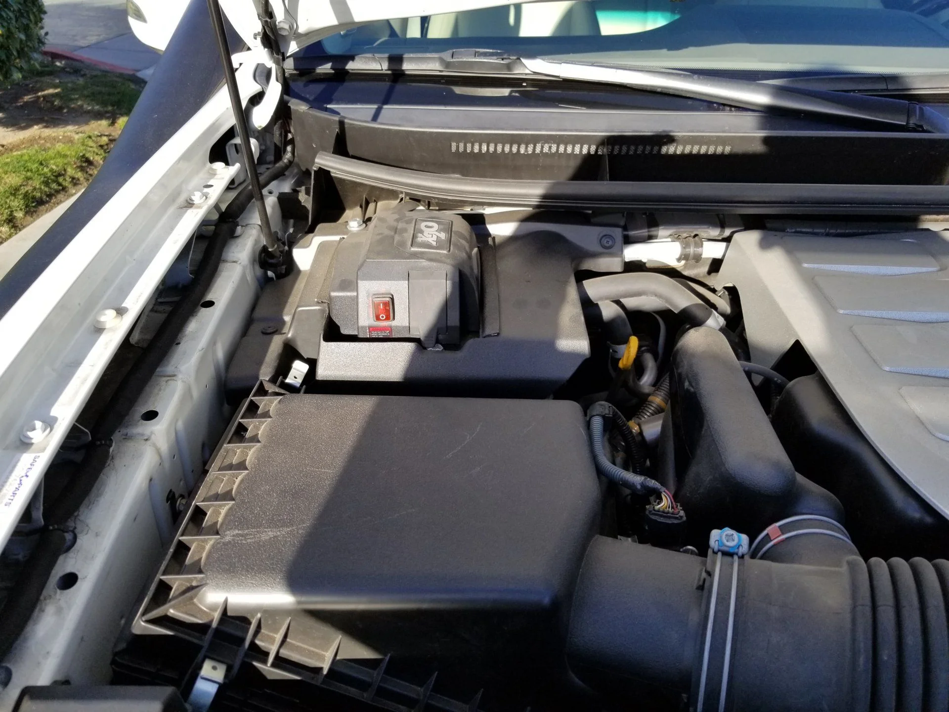

Here are some photos of under the hood.
Above is a shot of both my dual Odyssey PC122 batteries and isolator. I swear by the Odyssey batteries. I've used them for the past 20 years in all my overland rigs, my wife's cars (and the truck she has now) and motorcycles.

Above, at the firewall, on the passenger side (top left of the photo) is the switch and plug-in for the hand control of my winch

  • Racetec Coilover Spanner Wrench RACETEC-1000
  • Metal Tech 2003-UP Lexus GX470/GX460 Offset Rear Lower Links MT-120/150-44125
  • ICON 2003-Current GX470/GX460 Overland Series 3" Lift Rear Coil Springs ICON-52800
  • Metal Tech 2010-13 GX460 Talon Front Shell Bumper Stage 2 MT-GX460-33220
  • ICON 2003-UP Lexus GX470/GX460 Stainless Steel Lower Shock Shin Guard ICON-56100 2
  • ICON 2003-UP Lexus GX470/GX460 V.S. 2.5 Series RR Rear Shocks (0-3" Lift) ICON-57810P 2
  • ICON 2010-Current Lexus GX460 Extended Travel Front Coilover Shock Kit ICON-58647-700 2
  • OPOR 2010-Current GX460 Sliders Powder Coated OPOR-GX460-21100
  • ARB Skid Plates Toyota Prado 150/4Runner w/ KDSS ARB-5421110
  • ICON 2003-UP Lexus GX470/GX460 Delta Joint Tubular Upper Control Arms ICON-58451DJ
  • Metal Tech Lexus GX460 Lancer Rear Swing Out Bumper (2010-2013) Stage 3 MT-GX460-3423
  • ICON Six Speed 17" x 8.50" Wheel - Bronze, Product Line: Six Speed (qty: 5) ICON-1417858347BR
  • Six Speed
  • Specification
  • Color/Finish: Bronze
  • Material: Aluminum Alloy
  • Wheel Diameter: 17"
  • Wheel Width: 8.50"
  • Bolt Pattern: 6 x 5.5
  • Backspace: 4.750"
  • Offset: 0 mm
  • Bore: 108 mm
  • Load Rating: 2500 lb
  • Weight: 30 lb

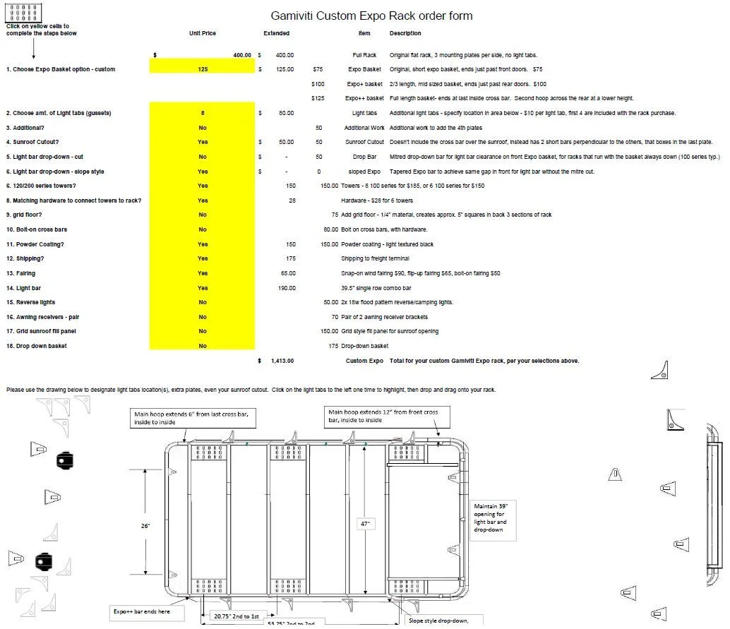

Gamiviti Roof Rack: Gamiviti
1906056

Looks great!!! One thing you might want to look at is a windshield wiper reservoir tank relocate. Heard of a few '10-'13s w/aftermarket bumpers with washer tanks that got damaged.
With all due respect, not sure what you mean about the wiper tank? It works fine now. Do you mean if I get in a minor fender bender, it'll ruin it?
Actually off-road it is out there and has possibility of getting snagged on debris off the pavement.... more than likely brush & sticks. Perhaps protecting the rubber hoses would be good enough?
full
Ahhh... The dimly lit light has brightened and I see what you mean now.
Thank you for the heads-up! I will be addressing that.

I would like to see what you did for a dual battery setup. I am working on a solution and would like to see how you resolved this issue.
--HitchCrack
--HitchCrack
Let me take a couple of pictures from under the hood and post them.
There is no dual battery setup presently for the GX 460. There is for the 4Runner and I think for the Prado, but because our GX's are v8's (unlike the fore mentioned vehicles), the layout under the hood is different and thus I do not believe any would work.
YotaMasters took three tries to make mine and it came out very clean.

Yes Veronica build has the 2nd battery behind the ARB bumper, which won't work for me since I have the MT front bumper. I have considered the Hewitt bypass and delete to gain that space. I picked up the dual battery kit from Shrockworks before I realized it would not work. Their kit relocates the secondary air injection pump up close to the firewall. This won't work on most 460 due to the hoses for the rear seat heater core being in the way. These are not present on the 5th gen T4R. Did they put two batteries in the same location as the primary just smaller size and turning them sideways?
