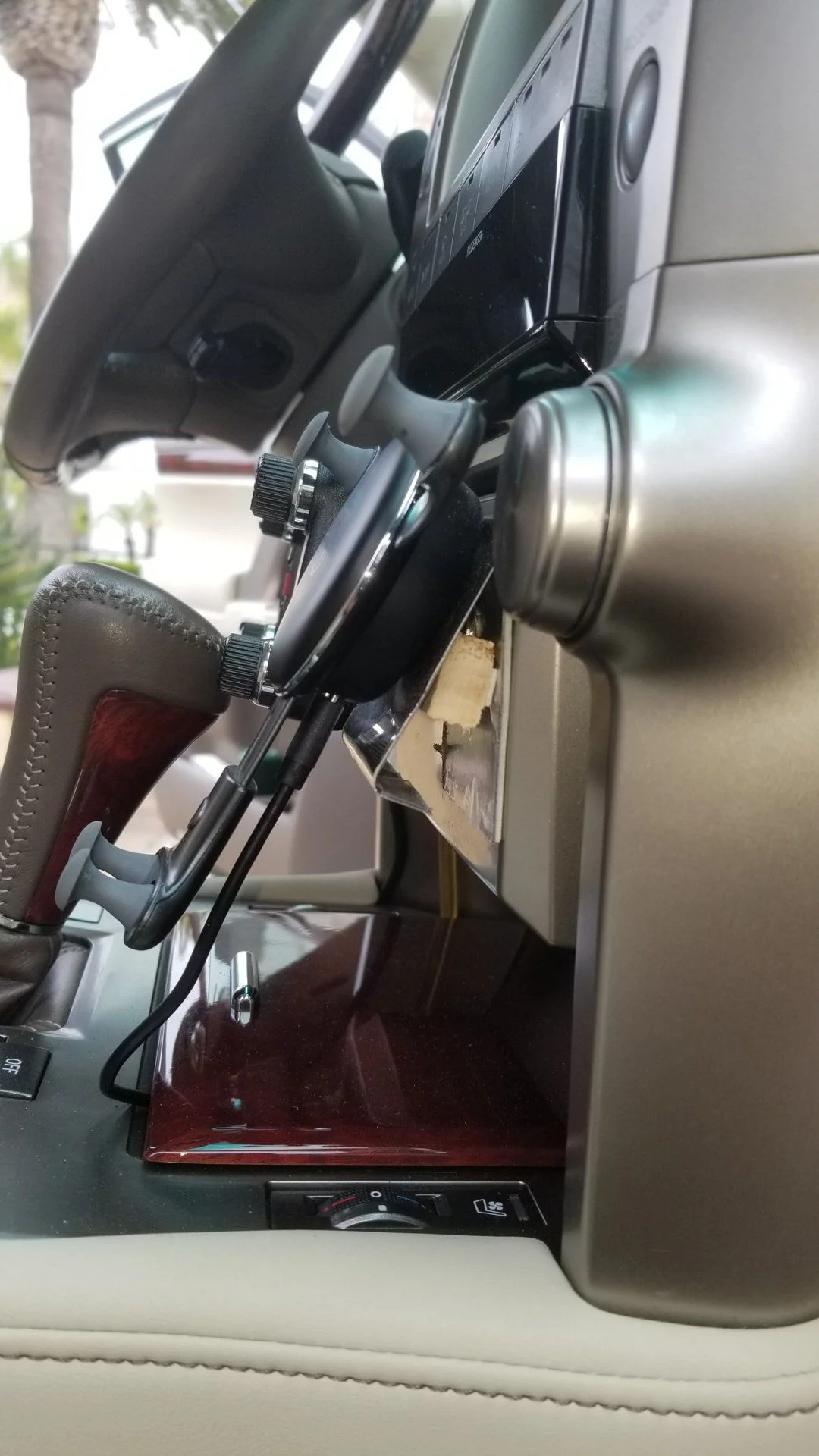

These photos will be of the console and mounting of both the head unit and phone charger.
This first one is a shot looking from the drivers side across to the passenger side.
2002900
This photo is the same as above except looking towards the drivers side.
2002906

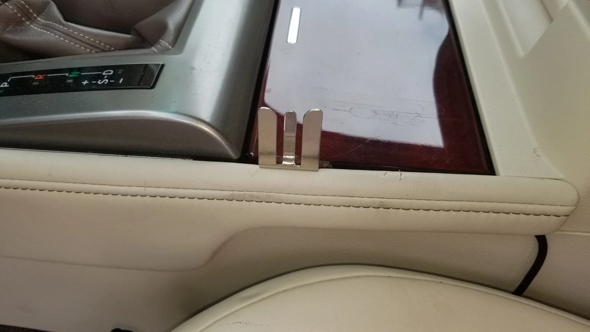

Next couple of photos are of the MIC clip.
2002901
2002902

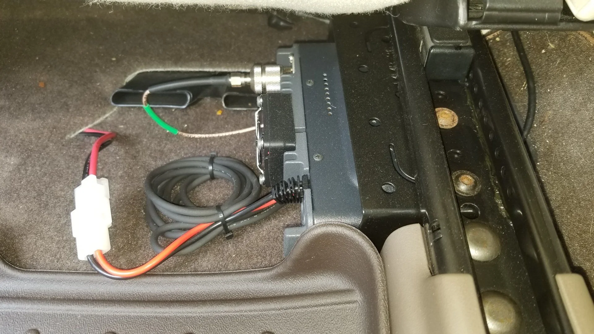

These photos show the mounting location of the unit under the drivers seat. Note the low profile allen head screws that mount the radio to the actual seat rail. They'll look a little rusty, but are fine. Also the holes are already in the seat rail and they line up with the threaded holes in the unit!
2002907
2002908
2002909
The photo below should give a good look at the exactly where I mounted the radio to the rail.
2002910
2002911
The last photo here is of the short length of polyimide rod (a type of plastic rod I had laying around) that I cut to length and wedged under the drop down face plate so the weight of the HAM face plate and phone charger would not cause the face plate to drop down.
It will be the yellowish looking rod on the left side under the unit.
It may not look like it the photo because I was purposely trying to show it, it is actually very well concealed and not noticeable.

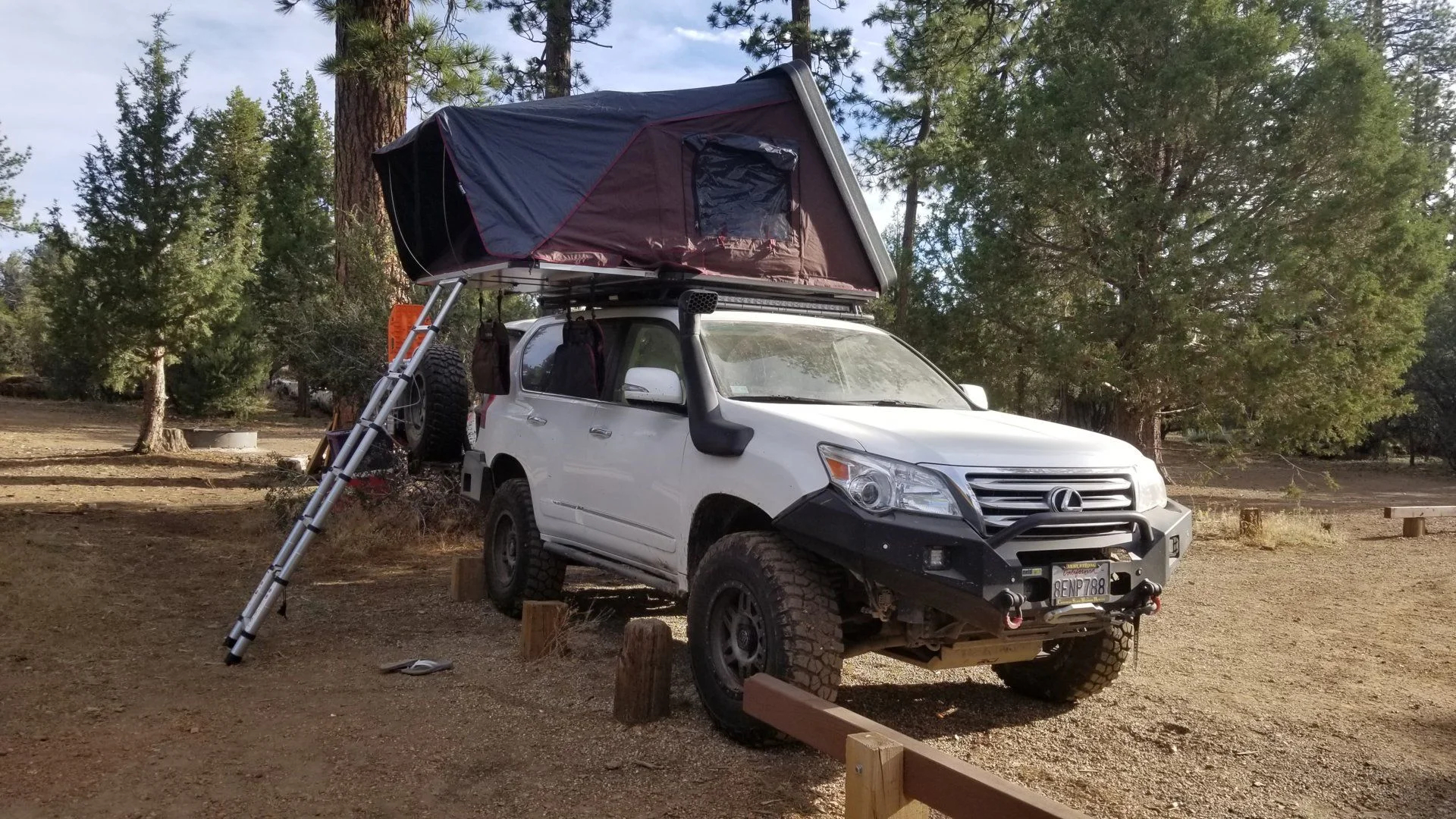

Camping and wheeling in Big Bear this last weekend with my 4x4 club!
Did a little damage, but HEY, that's what I built it for right?
Albeit, I may have been pushing it a wee bit trying to keep up Jeeps with 35" tires...
This first 2 pic's are at our camp site with the iKamper opened. My wife and I love this RTT!

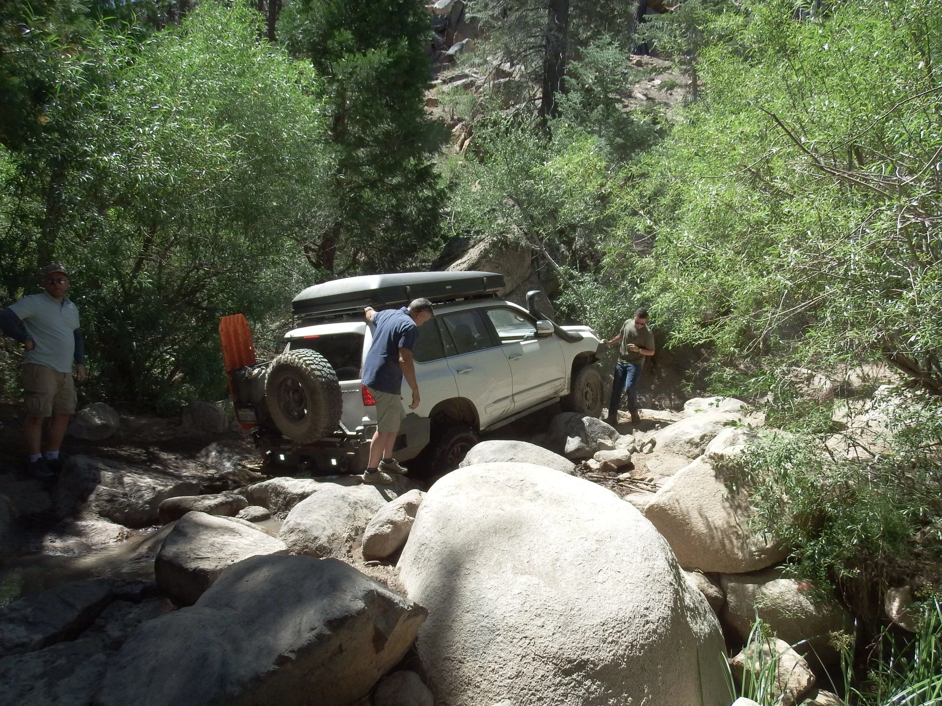

This shot below is what's called the "Gate Keeper" to Holcomb Valley trail in Big Bear. Even the 35" plus Jeeps were having issues getting through this. I was the only one with minor damage.
Attacking the first part. (below)
Stuck here, had to have a pull backwards to realign. (below)
Finally making through! BTW, those MaxTrax work great!
