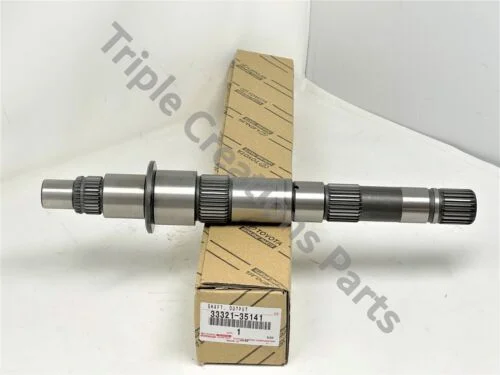

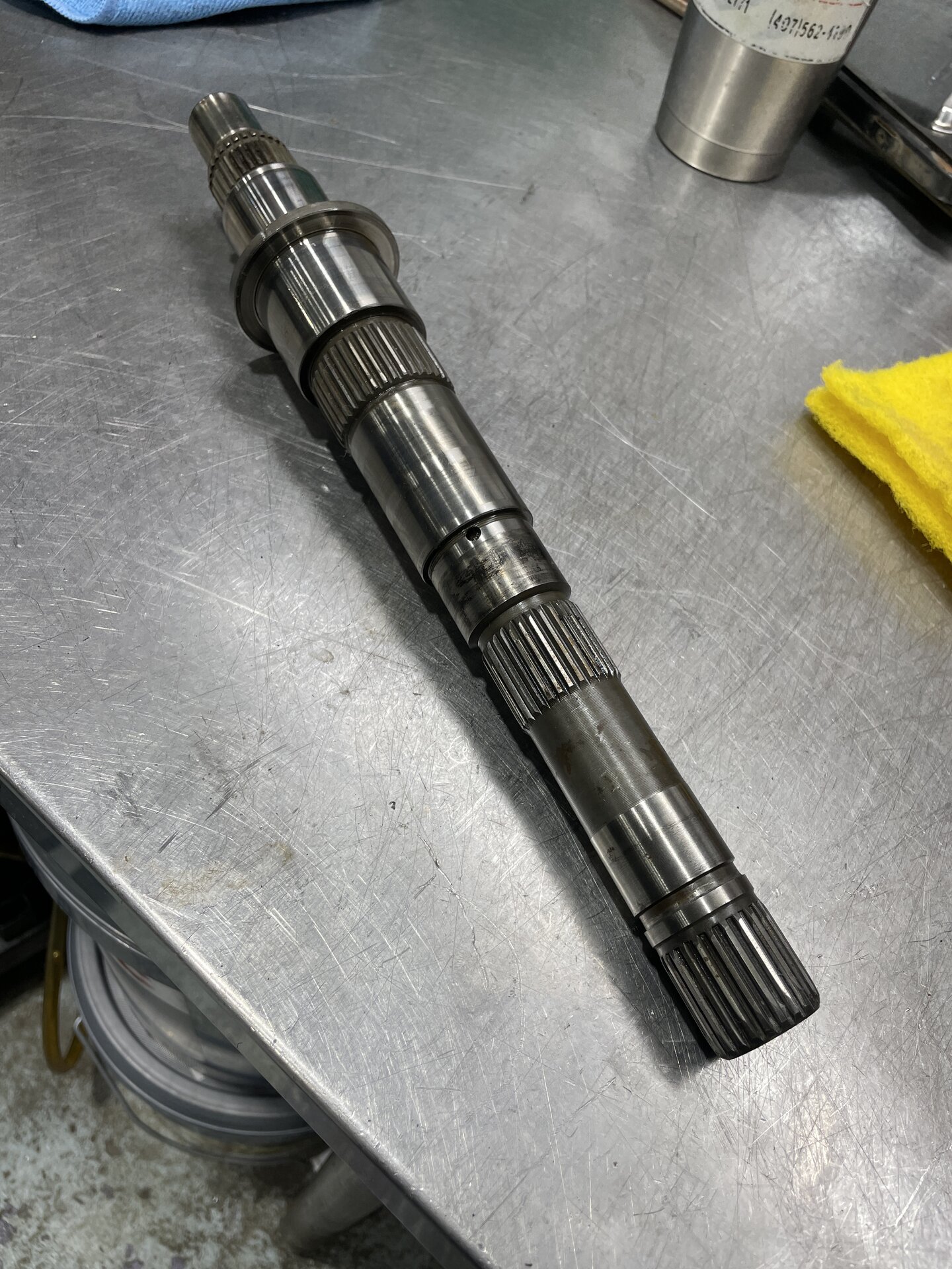

I was rebuilding my R151F (from 1986 22RET) and while pressing bearings/gears off, I broke a piece off the ring towards the back half of the output shaft. The Part looks like this looks like this:
Does anyone know if this is early R151F specific or if I could pull it out of any R series transmission? 3332135140, I think is the part number. It is showing replaced by 3332135141. It looks like it can be bought for $200 internationally but do the R150F and other R-series share the same part? If so I could probably get it for next to nothing from a junk transmission. I see a lot of cross-reference vehicles under those part numbers but could anyone familiar with these transmissions confirm?
r151f , has a nut holding on 5th gear . 33421-35130 sub to a 33421-60161, subs to a 33421-60162 which now is the updated final part number that does not use the nut to hold on 5th .. but takes a different 5th gear set . . r151f turbo first gear is lower so yes that shaft is a turbo only shaft . ( broke one myself in the past ) for the lower , if this helps you , dont know on the upper shaft
The superseeded one should be backwards compatible across all R151 applications. I just bought a new one for a R151 I rebuilt. I have the one that came out if you want to buy it for $30 plus shipping? It could go out tomorrow.
