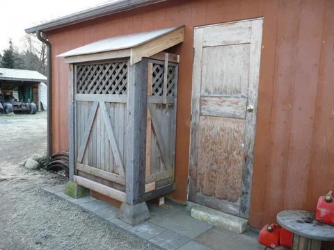

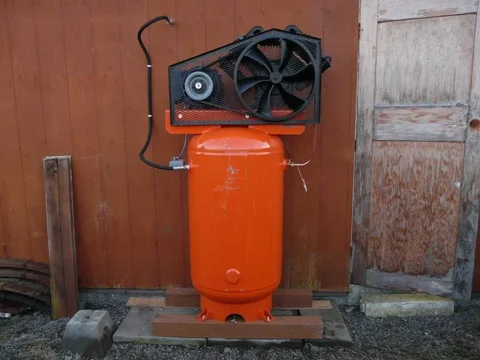

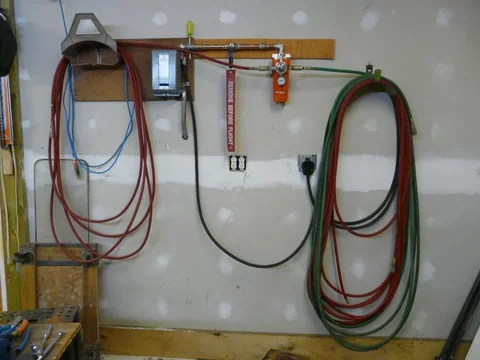

I thought of doing a thread on this, but here is a couple of pics of my installation. The electrical drops straight through the wall behind the motor. The reason for the highly elevated air line is twofold. It keeps all the stuff high on the interior wall, out of the way. I go away for months sometimes, and this way any condensation in the line drains back into the tank with gravity, helps keep the lines drier. The exterior air line is a custom hydraulic hose, no issues with vibration being a soft hose.

cruiserpilot, your compressor install is nice!
The "Remove Before Flight" tag is a good touch!
Thanks, I go away for long periods of time and the wife will in fact check and maintain the car tires when I'm away, so I put that there to help her find it. I use the second line on the left only for my plasma cutter so that hose has minimum amount of potential moisture in it. I also have a welding plug instead of a permanent install so I can switch in the welder without overloading the circuit.
