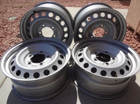

These wheels
With these tires [URL="http://www.tirerack.com/tires/tires.jsp?tireMake=BFGoodrich&tireModel=All-Terrain+T%2FA+KO&sidewall=Raised%20White%20Letters&partnum=77R8ATAKORWLV2&tab=Sizes]BFG 275/70/18[/URL]
Under a 2.5" lift.
Any objections before I pull the trigger?

Anyways, I don't see anything wrong with your setup. It should look cool. In my opinion those are the best looking 18" wheels that fit the 100 series.
How you going to lift the front 2.5"
My only objection would be those size tires (33") under a high lift will look small. But that is more of a personal opinion.
Slee/OME medium kit. Yeah that's my real concern, is the tires might look a little on the small side. Planning on stripping and painting the wheels black, so that should help.

FYI. BFG AT's have poor options in 18" diameter when going above 33". You really got to switch to a different tire, or likely to run spacers...
why not run a 34'' tire? BFG makes their AT in a 305/65/18. The KM2s also come in a similar size.
Price difference. The 33s are 800 for 4 the 34s are something like 1300. Plan is to run these until they're spent and by that time have everything else built up to run 35s. Re-gear, front locker etc...

Yes they are. I have the seller talked down to $200 for the set. Did they ever make a 16" wheel in the same style? I'd rather have these in 16 but all I've seen is 6 lug versions.
I believe you can find a 16" split steelie, but i have read there are some tire shops that won't install/balance a tire on a split rim In the middle east the 70 series (same lug pattern) got a 17" steelie wheel, but i have read you cannot get it over here. I think both of those are only middle eastern spec wheels.
There are 16" steel wheels. Maybe Proffitt's Cruisers can get some?
