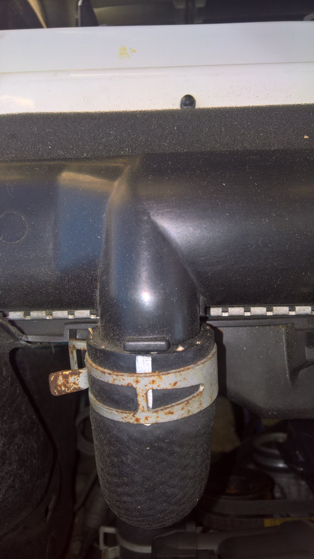

Here's some photos from a FZJ80 (1FZFE), all the stripes are white and all
are upright. Also note that two of the hoses (white stripes) line up with a tab or bump. One doesn't appear to have a specific tab, just some bumps from welding the bracket.
First photo shows the top radiator hose with tab on the radiator:

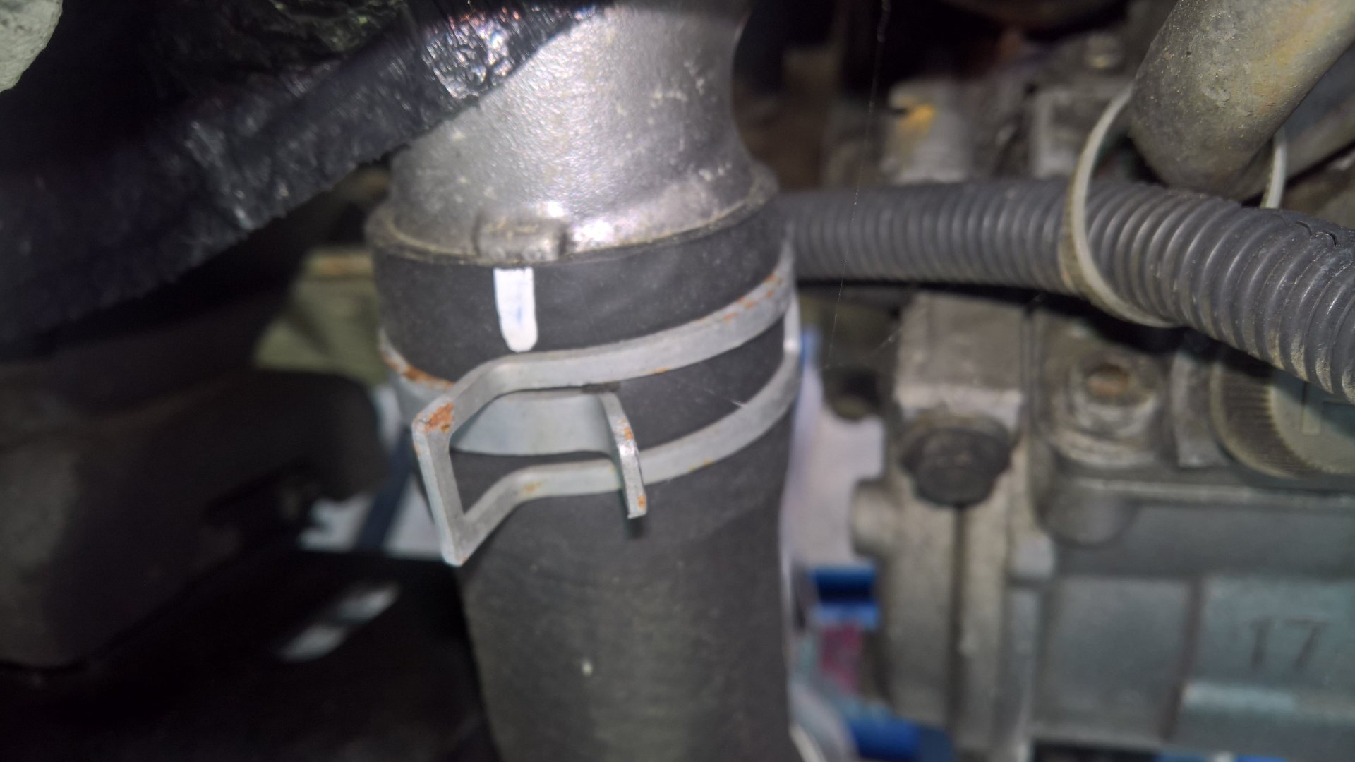

Next photo shows the stripe upright but on the end facing away from the radiator:

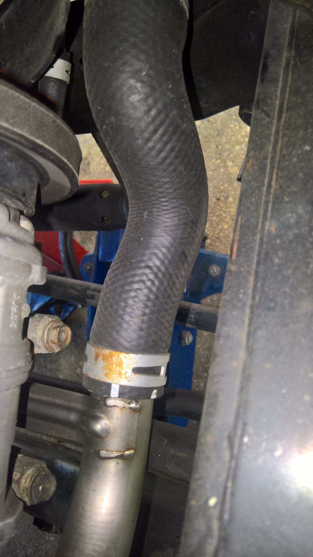

Last photo shows lower radiator hose #2, stripe on the engine side lined
up with a tab on the Thermostat pipe/housing

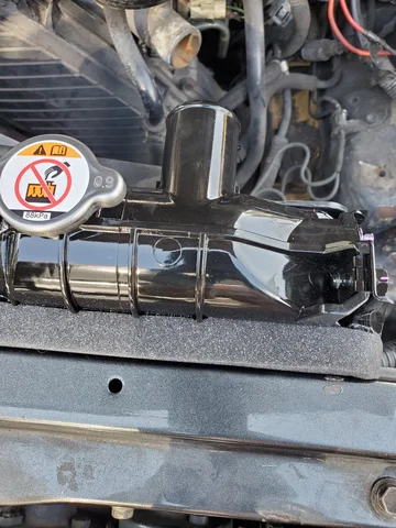

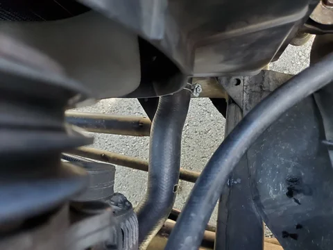

A bit different on this radiator. As you can see in the lower hose installed, there is nothing in the way.

I always thought thats where you line up the pin on the clamp. Pull the pin and 💥, you are in business.

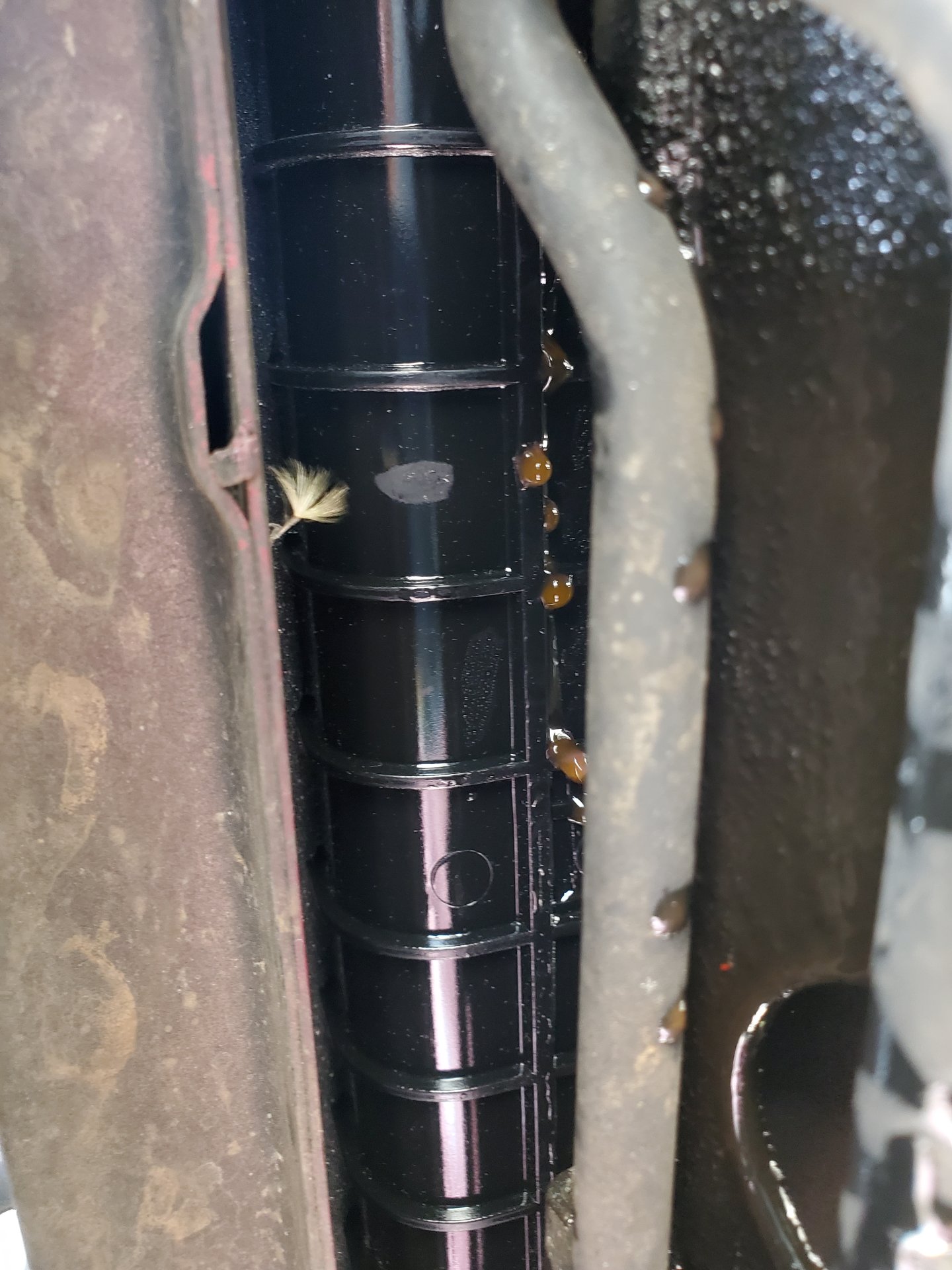

For the first time I've had an epic fail on a toyota radiator. It's leaking worse than the Exxon Valdez. The radiator must have either a Crack or a bad seam job.
I'll call the dealer tomorrow to get another one on order and remove this one.

Yes. Oem purchased at S.F toyota. The funny thing is when I was done Installing it, I was "it hope it last another 15 plus years". The damn thing didn't even last one hour.
FWIW, when I replaced my radiator about 5 years ago I took the new unit (Koyo) to a radiator shop and had it pressure tested before I installed it. It was $25, as I recall, and my thinking was that it came all the way from Asia and had been through a lot of hands. They're kind of a hassle to install, and I wanted to make sure it wasn't DOA. So, for other Mudders, that is my suggestion. It only works if you have another vehicle to use, you're not in a time pinch, etc. YMMV.
The petcock/drain plug is installed correct?
That was the first thing that I checked and it was on pretty tight. Checked it prior to install and when I saw the leak I immediately checked it again.
It was on so tight I needed a plier to back it off in order to get the remaining 1-3/4 gallon of antifreeze in a bucket.
It's so strange to have a new radiator have aleak. I'll remove it and look at it closely. The parts guys at sf toyota are cool so I'll call and have them look it over and replace it.
