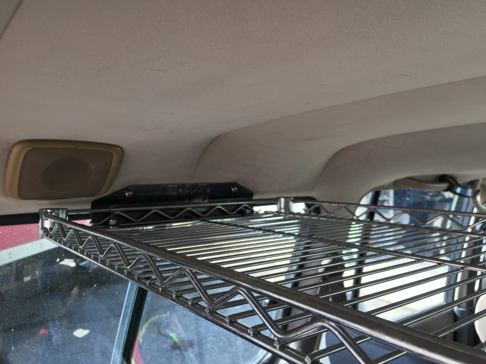

Yesterday, I stopped by the scrap yard and lo and behold, there was the exact style/size of stainless kitchen shelving Cruzilla had used to make his sweet shelf. I had like what I saw so I was already on the lookout for one. Turns out the scrapyard only wanted about treefiddy for it, so I was happily on my way.

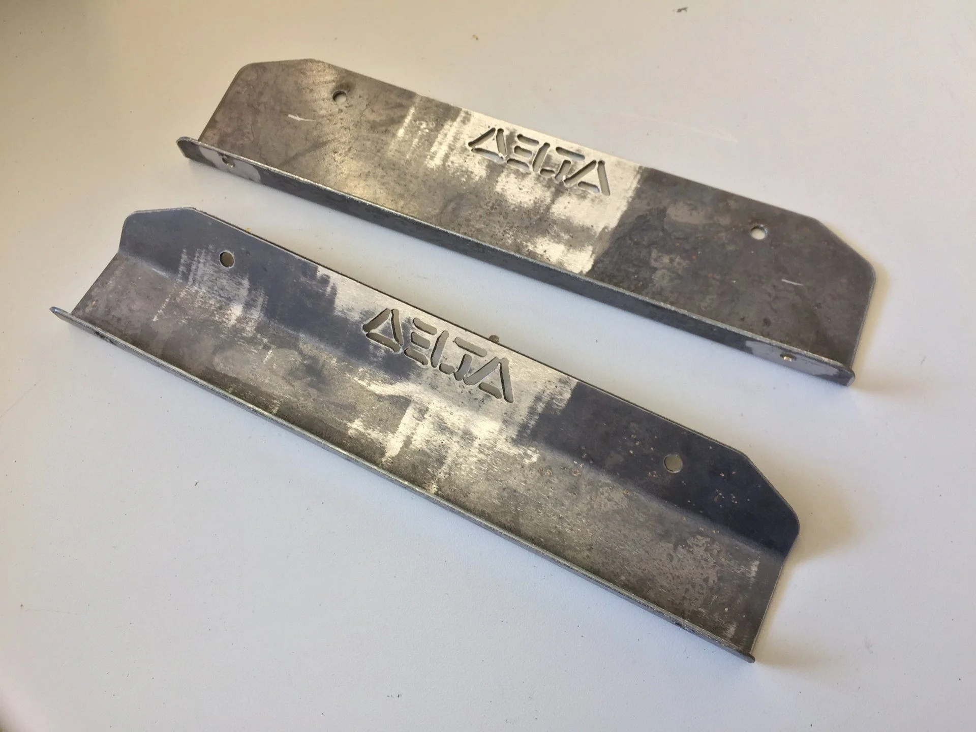

Yanked the rear handles off, measured up the hole distance, drew up a quick model, and cut one out of super thin material to give it a try.
Had to try it a couple time because I got the holes about 1/8 off, and then forgot to save the file correctly (I guess that's what I get for doing stuff after work on a friday...)
After a couple attempts, got it right and it went right in there. As I was sliding things around and fitting them up, I started to worry a little about the potential noise level I just introduced to my rig. Once I got everything locked in place though and went for a drive around the block, I didn't notice a thing. Pretty stoked! Next up will be making a little "crescent moon" piece for the front of it so sudden stops don't send anything flying. The reality of the situation though is it will be storage for when actually camped, not for driving around.

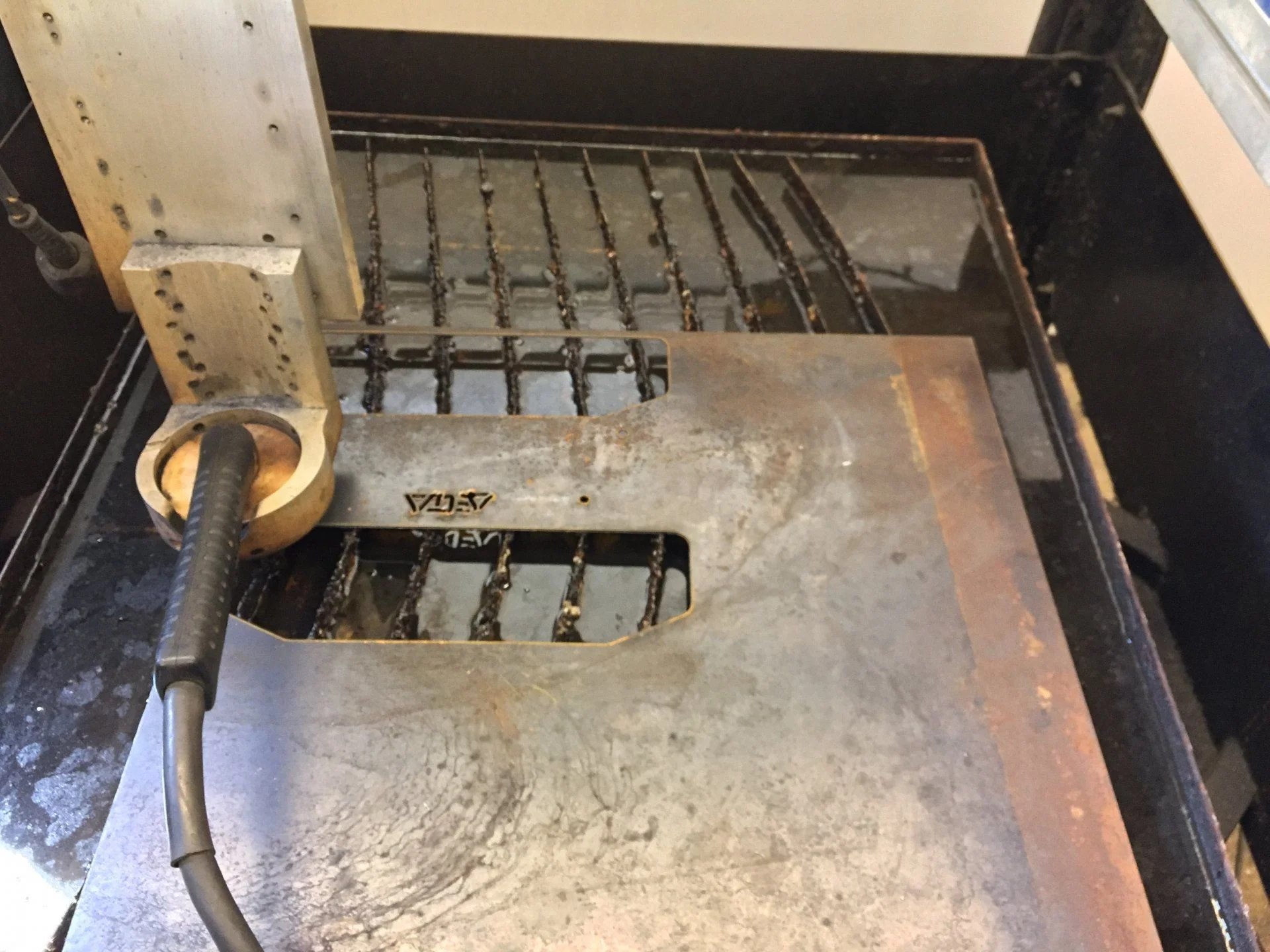

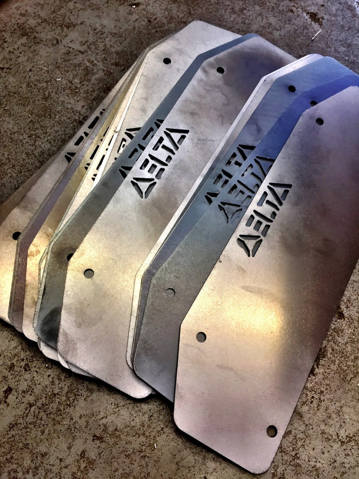

Had a stack laser cut, enough for 10 sets. I'll sell them either powder coated or raw, but I'm not going to spend the money on powder coat up front, so if anybody wants those I'll wait until they are all sold and do a batch.

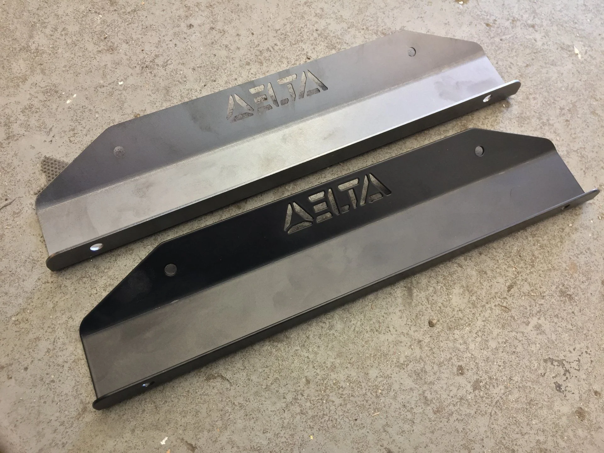

Had one piece test coated before bending (the final product would be coated after bending). Bent one of each up:
