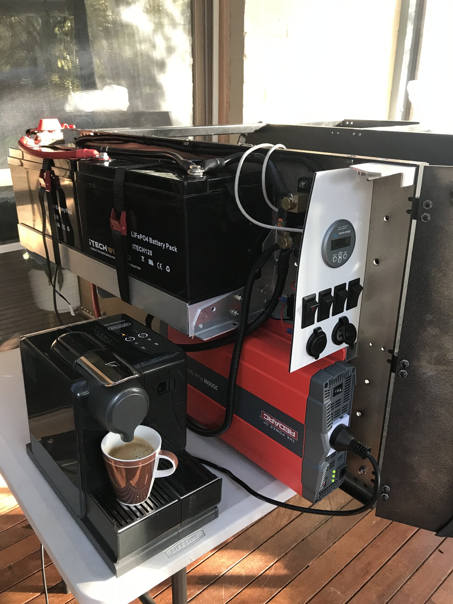

In Australia for touring I am using 240 AH of Lithium mounted in the side of my drawer system charged by a Redarc 1250D and recover the power consumed ( Induction cooking, coffee, fridge, lighting, assorted charging and Starlink) in the first hours the next day, for base camping definitely have to run 300-400W of solar to maintain the lifestyle.
The take up here has been slow on Ecoflow / Bluetti style battery pack chargers because of the difficulty recharging in the field and then initial cost and value $/AH

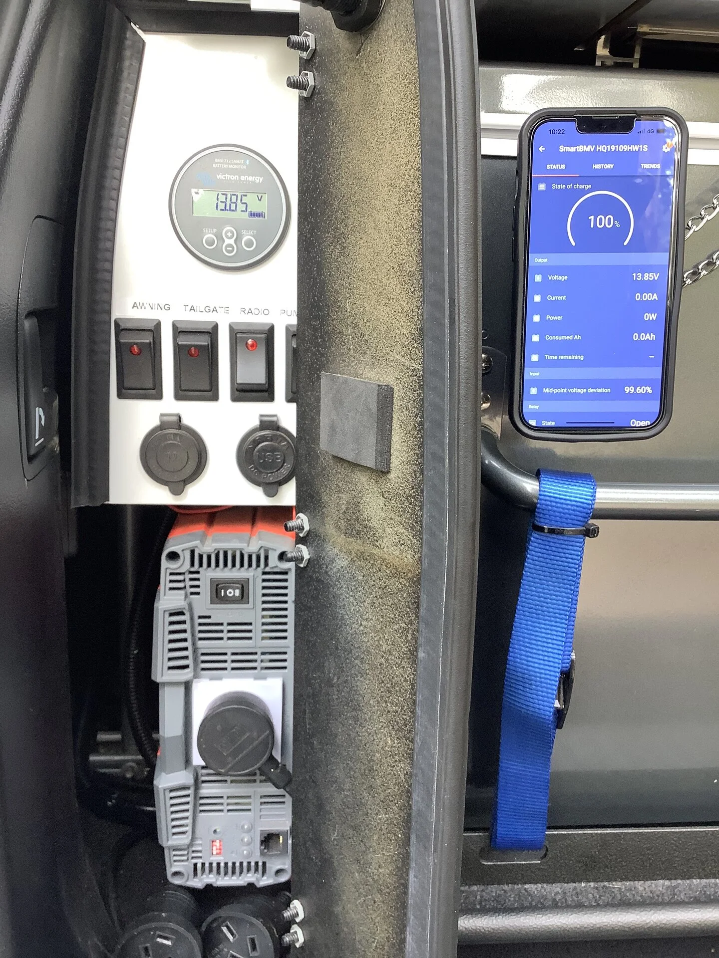

Nice setup.
What’s the larger grey circular device on your control panel? And can we get a closeup of that?
@Fisher23
What DC DC is that? All the ones I have seen are 30amps.
Thanks!
Victron BMV-712 or the like

Nice setup.
@Fisher23
Thanks!
As above a Victron Smart BMV 712 shunt which I monitor on my phone in the car or mounted on the fridge whilst cooking, coffee etc. as I get a handle on consumption.
The Redarc BCDC comes in 25,40 and 50 here in Australia mine is the 1250D which has a solar input, mine runs around 48 amps input so does not take long to replenish the power consumed for dinner and breakfast.
