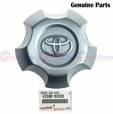

Recently, I was able to acquire a set of OEM 17x8 Steel Wheels for the 200 Series. Unfortunately, they no longer came with the original hub caps. Would the part TOYOTA 4260B-60020 (photo included for reference) be the correct part number for the hubcap cover?

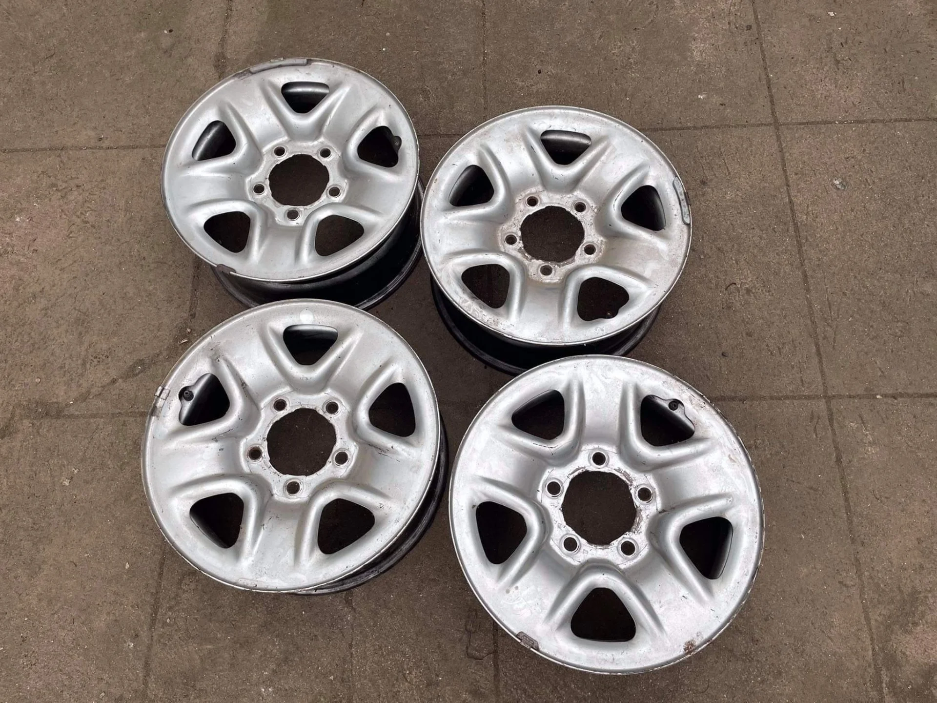

The wheels I was able to acquire. They are a set of 5, 5th wheel not in photo.
The part in question. TOYOTA 4260B-60020

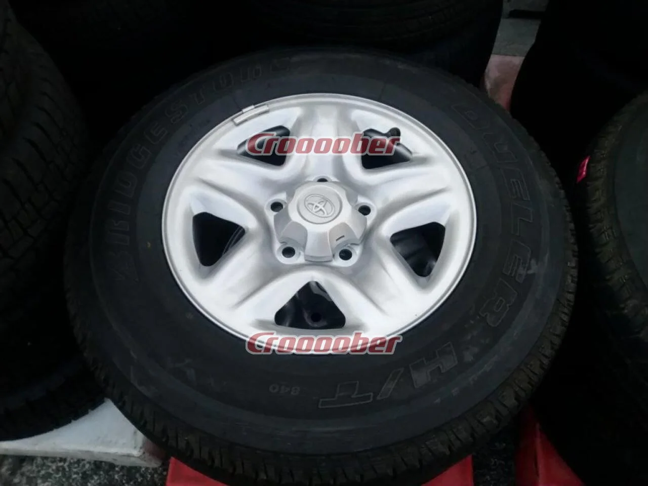

A sample photo of the steel wheels with the hubcap grabbed from CROOOOBER.

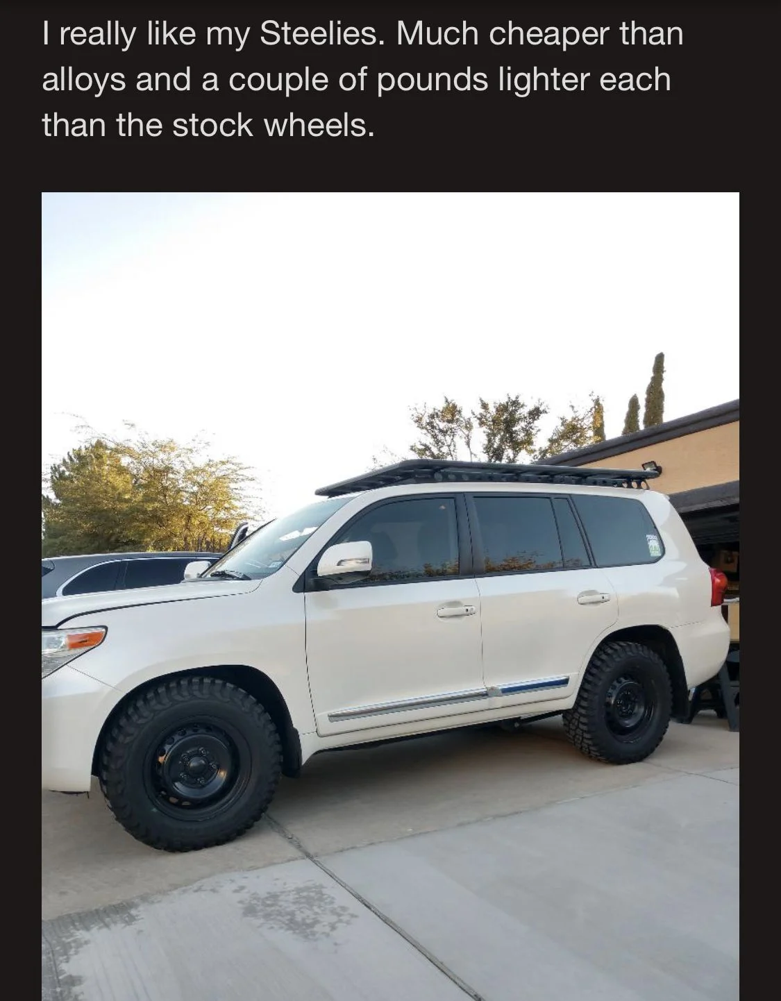

These are the wheels I'm running on my Lx, bought from a Tundra owner. He just included the Tundra lug nuts. I know its not much but its a start. I can vouch +1 that the factory LX lug nuts did not fit.
Did you notice if the Tundra lugnuts were longer than the factory LX lugnuts?
