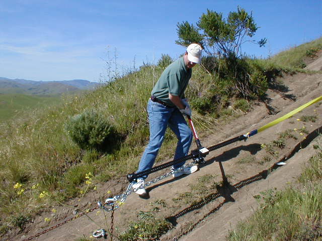

A friend picked up a "hand winching" kit for his Hi-Lift. We tested it out by pulling his 80 Series up a hill. It worked OK, but after watching the demo I decided to buy a winch. :D
If you decide to try it, be sure to pick a scenic location, it's a S L O W process. :flipoff2:
A few more pics HERE

i already got a winch so im hoping i wont be out there trying to hi-lift my way out of a situation like is illustrated but you never know...its pretty hard to winch a car backwards when the winch is on the front bumper and i never was good at figuring out angles to get clever in winching something in an angle to the gear...
