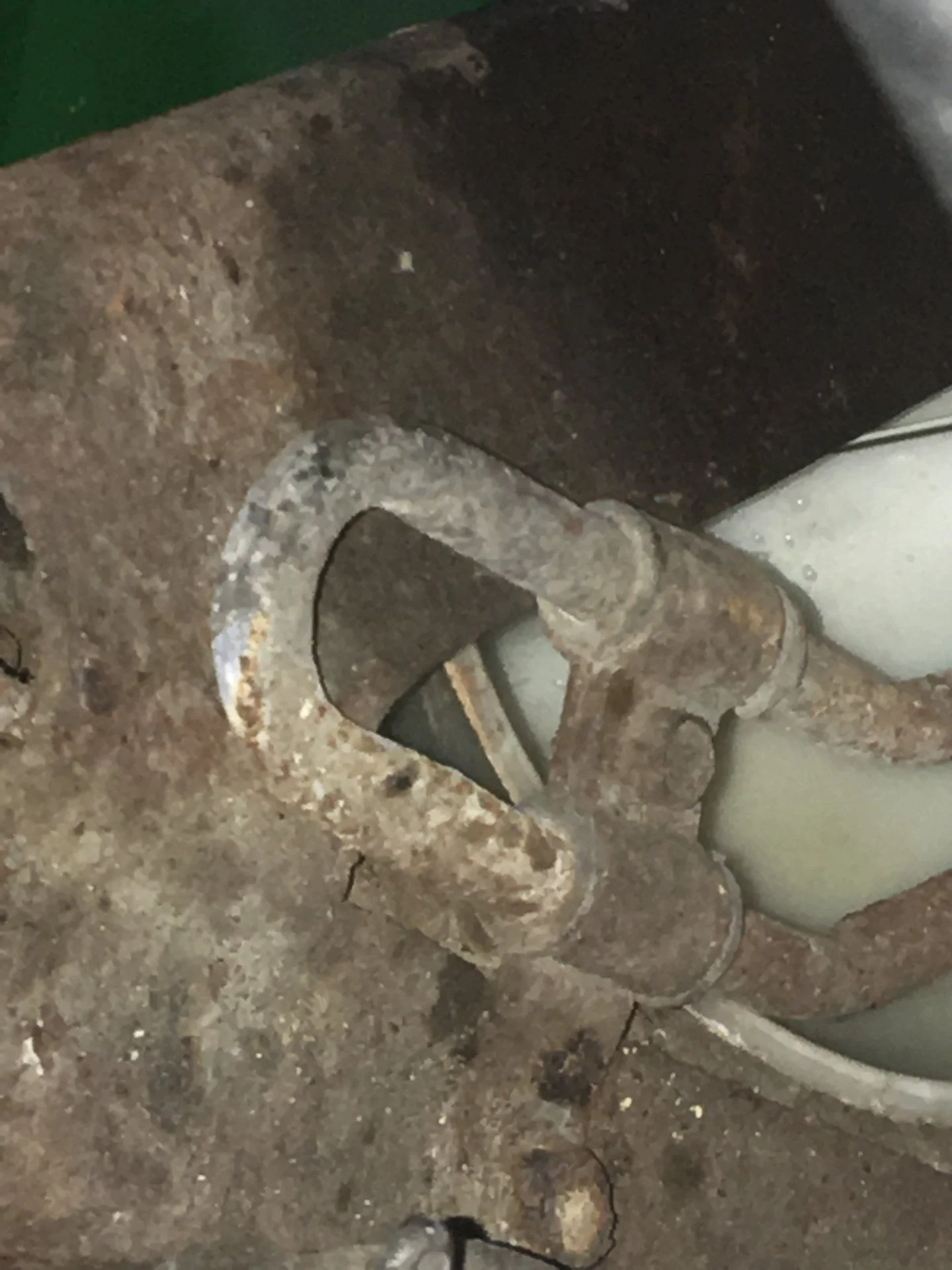

Does the cooler pipe have an indentation in the loop on the passenger side of the pipe by design or is mine just in need of repair.
The pictures I took dont show the indentation well because of the rust, but here is where it is:
Any info or pics of a cleaner line would be appreciated.
Normal. It's the result of compression bending to prevent wall thinning of a tight radius bend. It's not like that location in the tube could have been damaged by anything being tucked under the radiator like it is.
