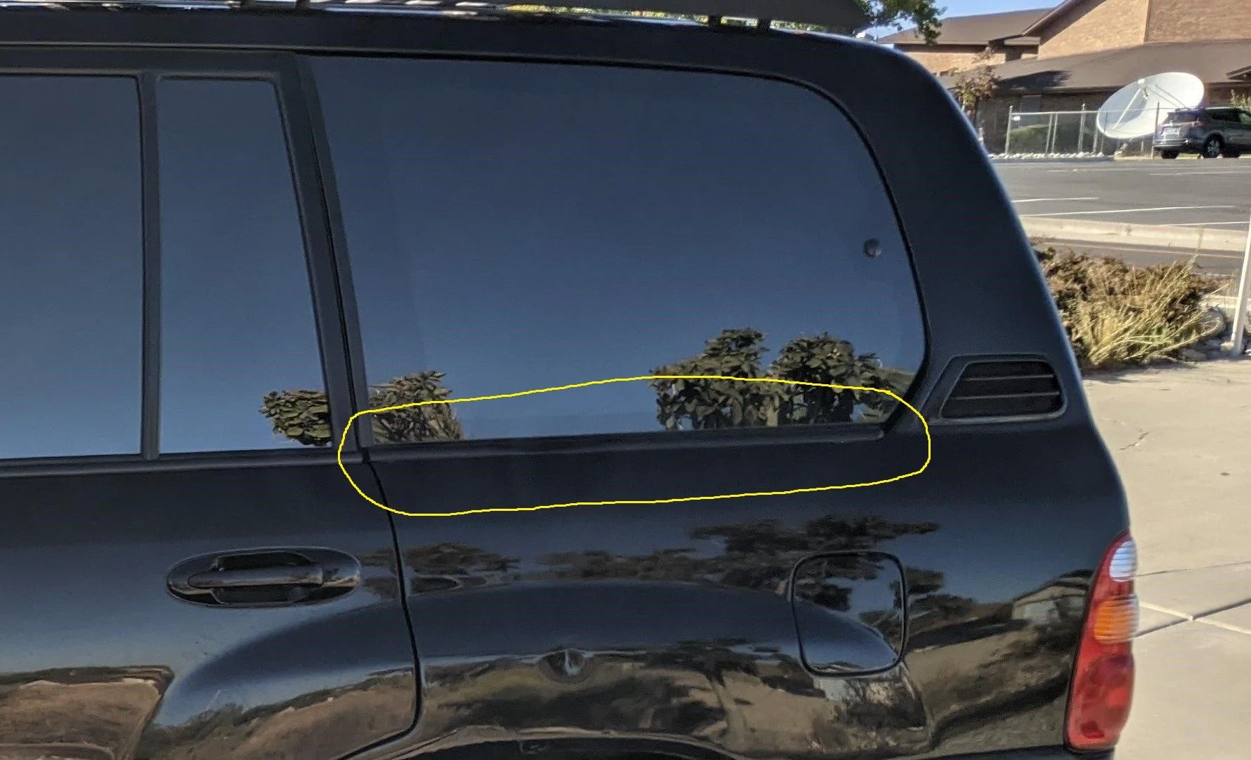

Mine looks like someone used a prybar on it and damaged it. I think this is the right part number ( 7567060040 ), from Partsouq its $45 with shipping. I can get a used one on eBay for $35 but it says its for 03-07 LX. Did this piece change on the later models? What is the best way to replace it? I assume the whole window needs to be removed, correct?
don't buy a used one, they are almost impossible to remove without bending up the bottoms of them.
I don't see why it would have changed at all from 98-07, just check partsouq
Hey jerryb, do you know if the same goes for the moulding on the doors? All four of mine need replaced and there's a parts rig local that I was considering pulling from until I found this thread...
Hey, I'm about to replace this same exterior moulding under the rear quarter panel window. I've been looking for a youtube on how to get the window out of the way in order to remove the screw at the front, and pop up the 4 nylon snaps. Can anyone point me in the right direction with a very basic step by step. I'm relatively familiar with how to remove panels, etc, but have never touched those rear windows.
Answered my own question, for anyone that comes along later. This video gave me the info I needed to know how to remove the rear windows:
