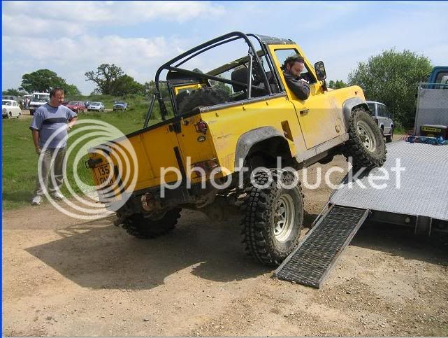

Are you suggesting that 'post lift' I will not be able to compress the front suspension? I have to say that is not my past experience. After a good lift I could still bury my wheel in the wheelwell with ease. That means I have the diameter of the tire still trying to fit between the same area of the wheelwell that is causing the problem. Unless we aren't expecting to be able to compress the fronts that far.FJCruiserOwnersGroup said:You put on that sexy lift and your front and back measurements are now three inches higher...and, without getting into measurements of pi, a circle is the fattest across the diameter.
