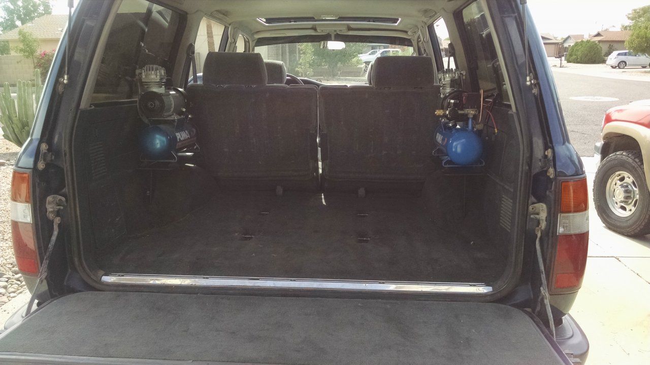

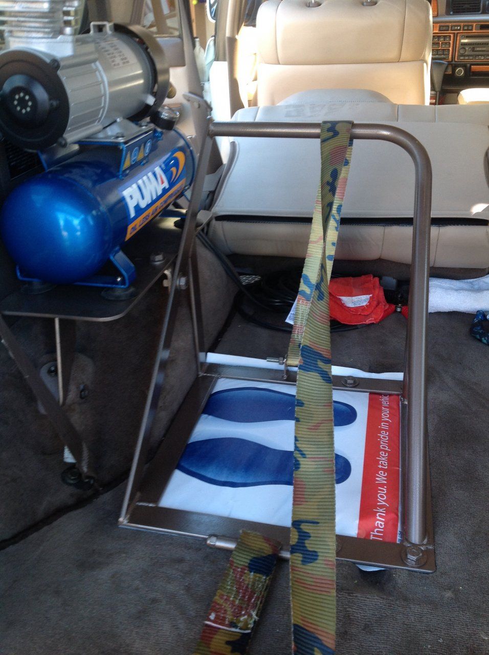

Bought the Puma, never looked back. You won't regret the Puma, match it with a mount from LandCruiserPhil and you have the perfect air system.

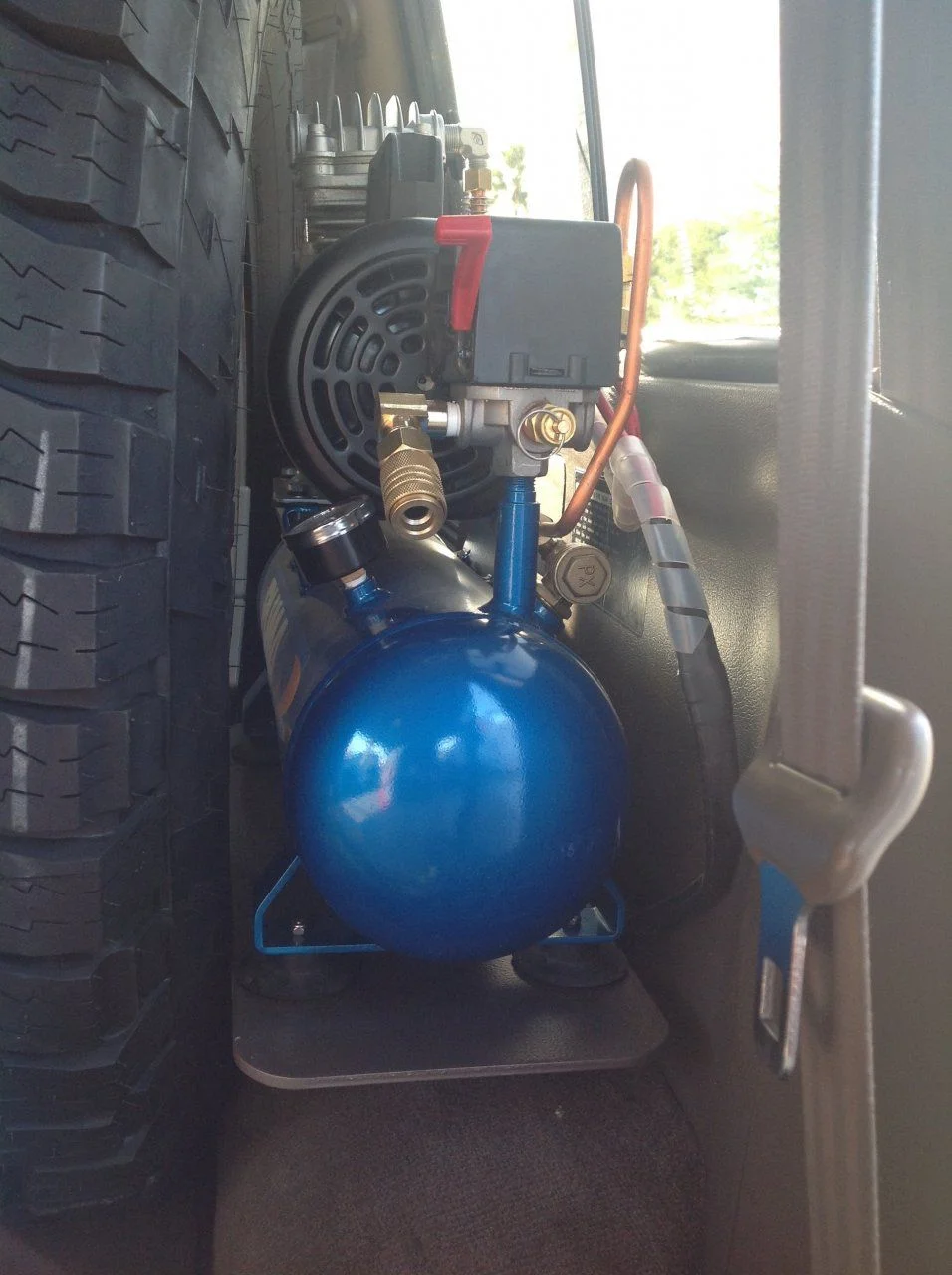

Looking from the back seat towards the rear.

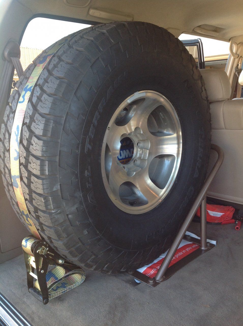

Saddletramp, what wheel mount are u using next to the puma mount?
The Puma mount and compressor have been my plan all along. There was a guy here who made a mount with an integrated tire carrier. I contacted him via PM and it does not seem to be something he is interested in doing at the moment, its a shame cause a lot of people want this other than just me. I would love to know how that tire is mounted next to the puma (In Saddletramps' post), as I currently don't have a rear bumper mount and carry inside.

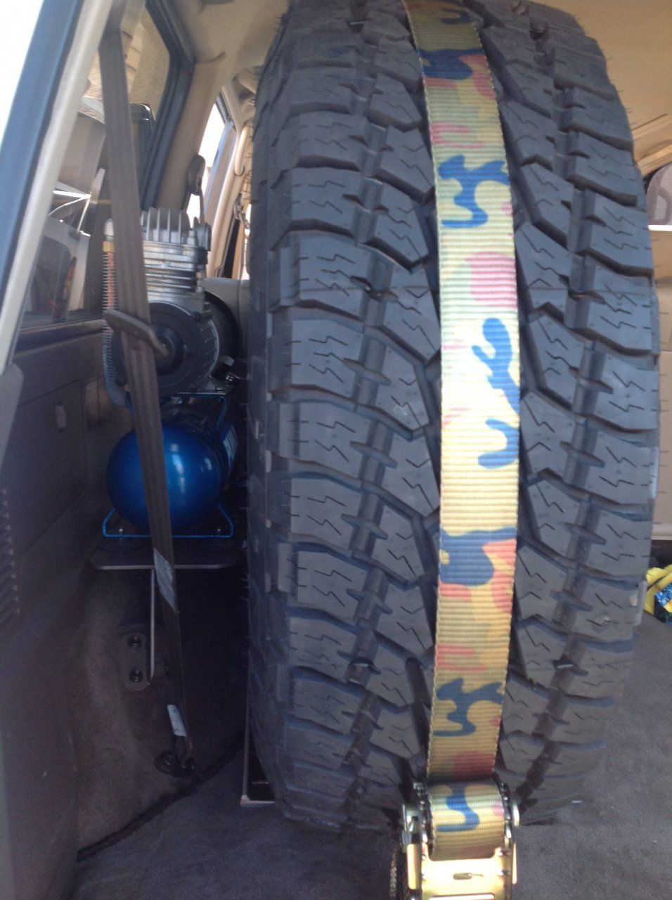

I am using the ratchet strap method discussed by A few of the CopperState members. I'll try to take a picture this morning.
Some prefer the Slee stripper pole. I've been discussing a modification with a local fabricator to make a mount to bolt to the existing floor mounts and using the Puma mount for a veritical anchor.
Update, I'm now using a tire carrier manufactured by LCP as an addition to the LCP Puma mount. It really is the best install for the person needing to keep their spare inside once you add a Luke's bumper.
