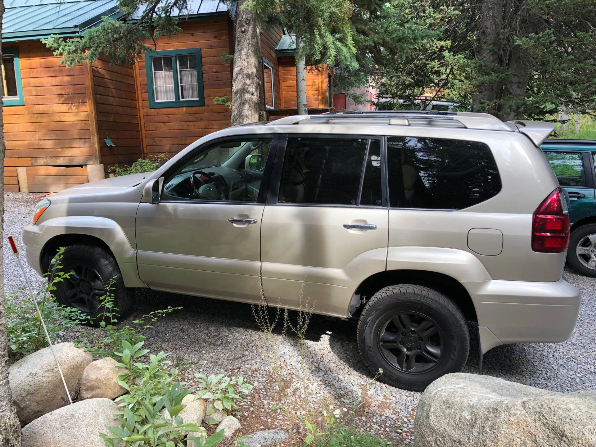

I'm the new owner of a 2009 GX 470. 105k miles on it. I'm thrilled with it, and makes trails seem easy that would have given me enormous amounts of heartburn in my old Outback. Everything is in pretty great shape, except I hear a pulsing in the driveline at any speed. I don't feel any vibration or pulsing until about 55 mph, then a small vibration through the wheel and seat (maybe 2mm of movement on the wheel at 75 mph). I don't know if those are related.
I can add that the sound is most noticeable when *rolling* down a hill. Under power, the sound is much quieter. It's loudest under engine drag, which is what makes me think it's somewhere in the driveline.
(Also, I just had new tires put on with a mount/balance/alignment, so I can rule that out. The brakes are also good, no warped rotors.)
Does this sounds familiar to anyone? I'll try to get a video with the sound uploaded soon.
I'm mostly concerned this is a symptom of a bigger problem, or that this is an imbalance that could cause problems if I don't address it soon.
Thanks!
