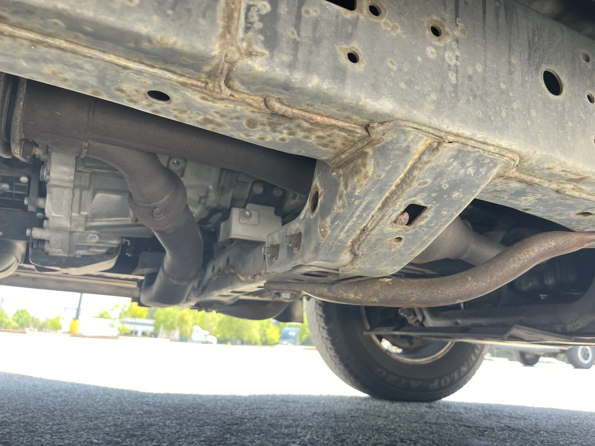

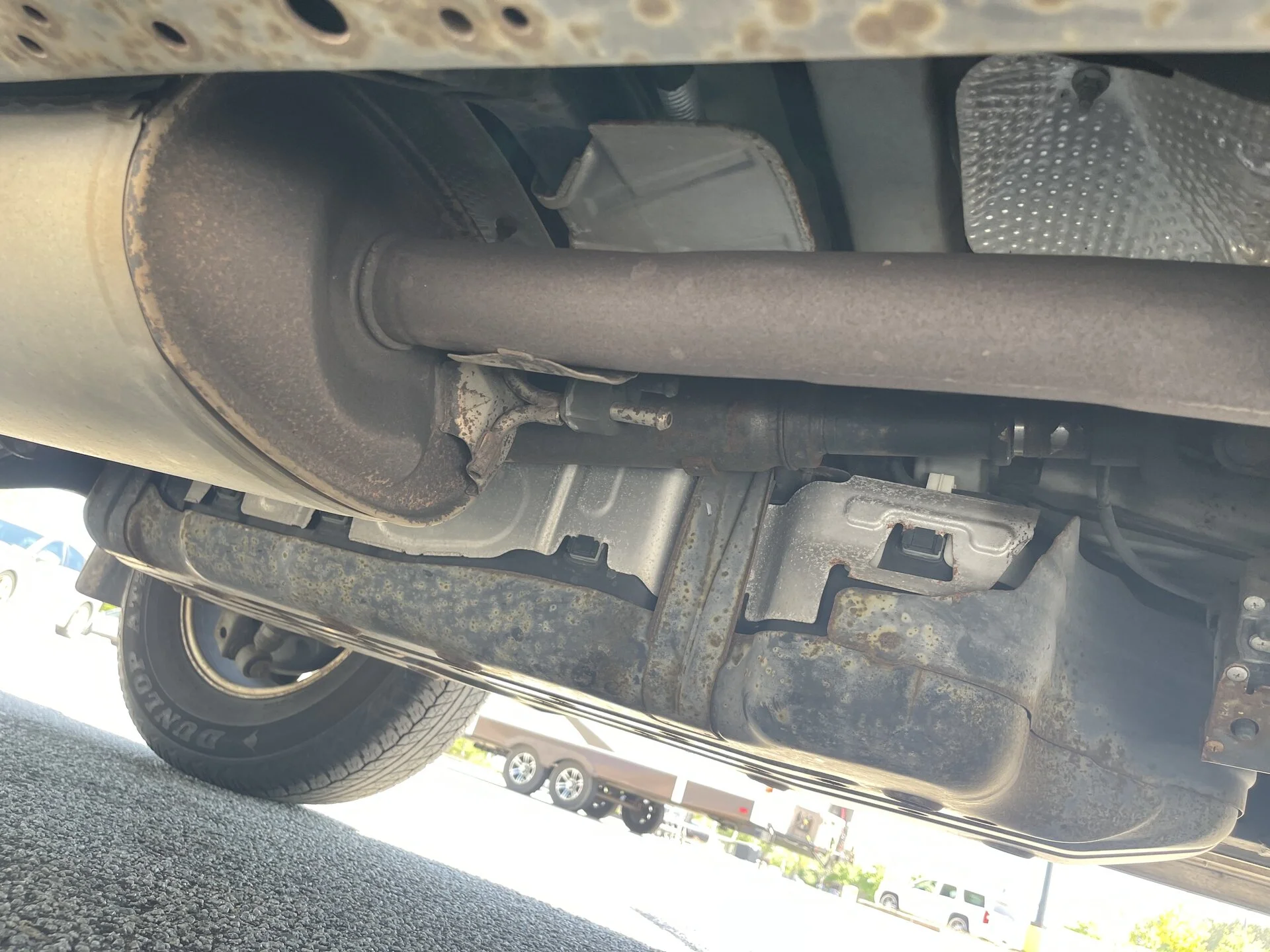

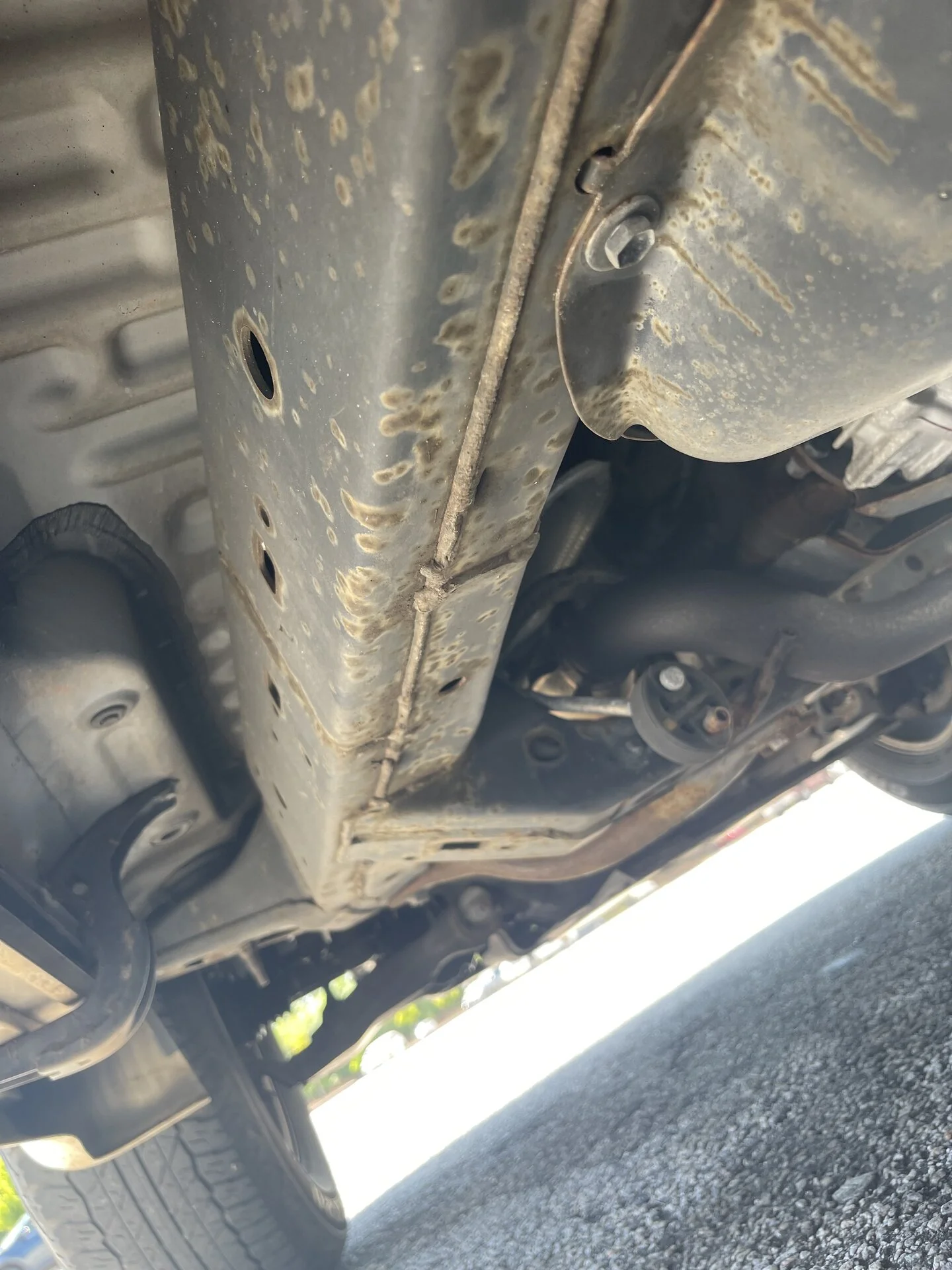

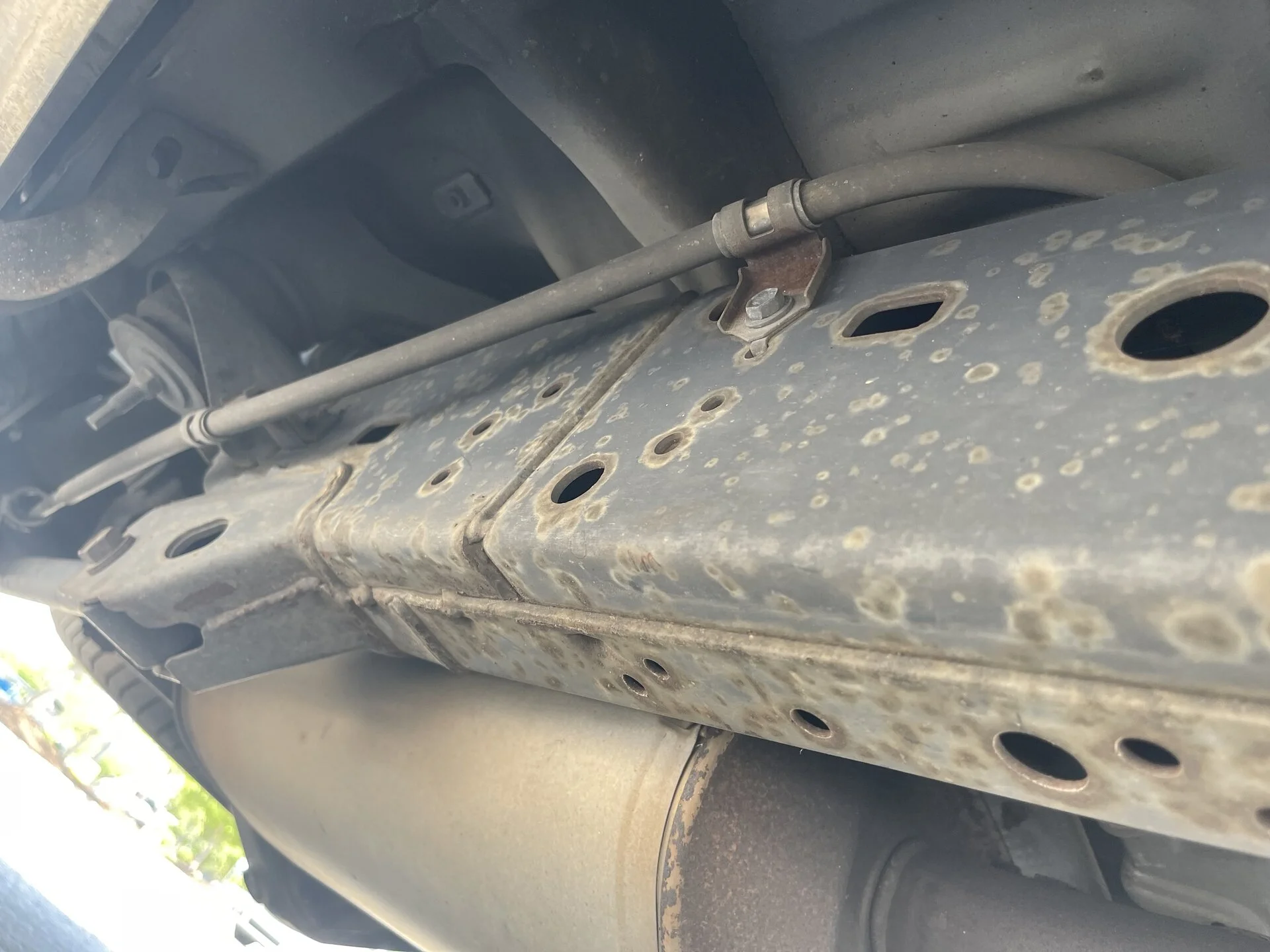

2. 07 GX with 210k, timing belt/water pump done at 170k. A few records here and there - spent the majority of its life in Orlando/St Augustine. I'm a little bit concerned about the rust on the seams?
Am I going overboard here or does this one look G2G from a rust perspective? Would like to keep this thing forever.
P.S. only attaching images from #2 - not a single spot of concern on the 04.
Thats basically zero rust IMO

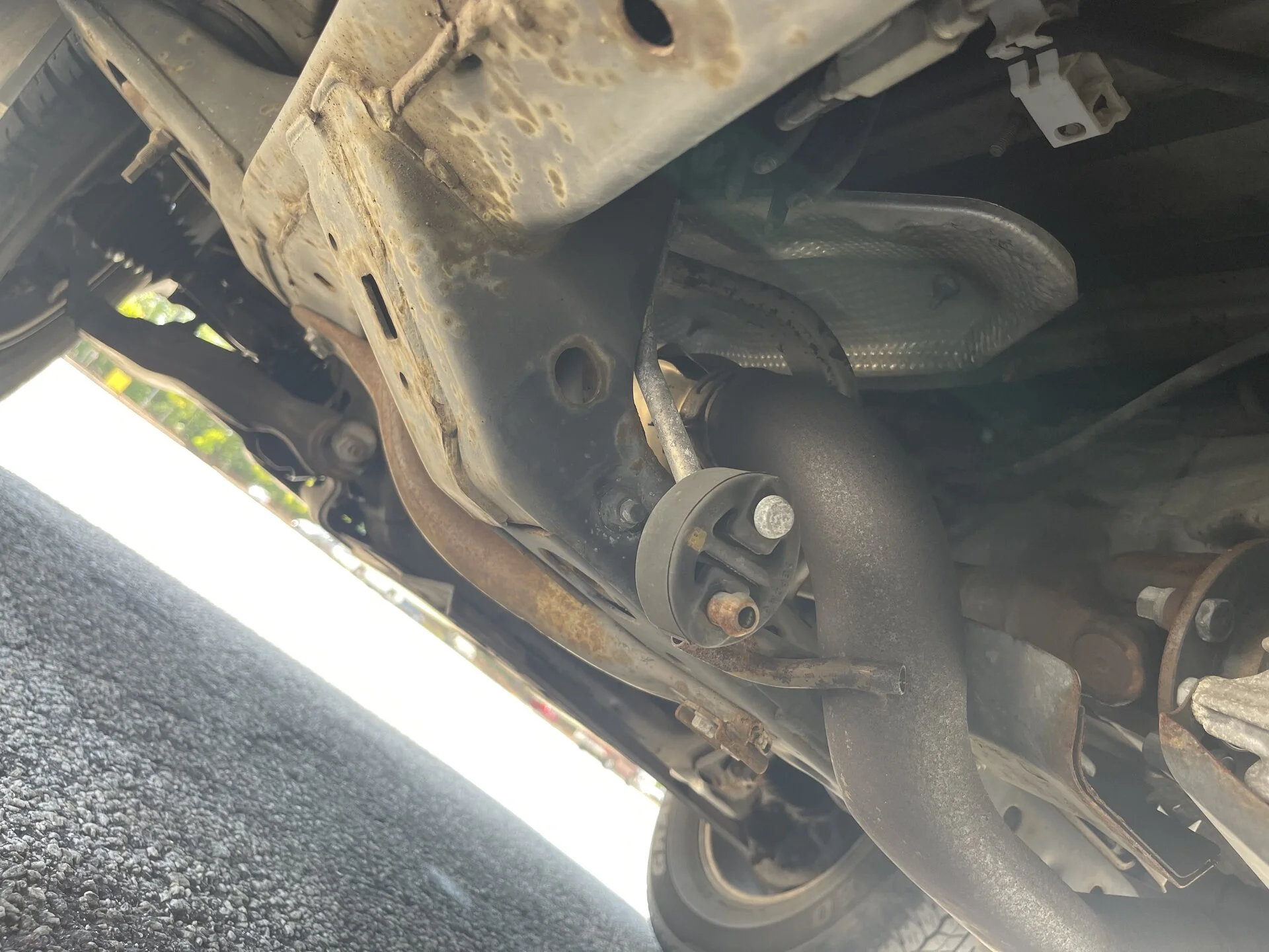

Not something that if I bring it back to upstate SC I'll have to have treated or anything like that? I know I'm probably going overboard but holy crap after I missed it on that first one, I'll need rust therapy to forget it.
The seams will surface rust a bit with time and use in any climate pretty much. You could certainly rust convert and paint it, or film it, or whatever to slow it down, but that frame has most of its life left in it.
How does the rear most part of the frame and rear axle look? If they are about the same as above, I wouldn't worry about it in SC.

Yup all looks like that.

Wouldn’t hurt to hit it with a converter spray or some rust encapsulating paint. But really, that frame is very good and has tons of life in it.

Rust of "02" is not bad at all. However, I'd still look inside the frame to verify that it is OK, paritucalrly just behind the PS front tire where the AC drain line drips down.
If the inside checks out, I'd powerwash the underside and hit it with a DIY coat of Woolwax Black (outside) and Fluid Film (inside the frame) and touch it up every 1-2 years after that. My '07 definitely looked worse than that, the same treatment has totally stopped the rust for 2 years. I have not touched it up in ~18 months but will this fall.
Do you mean NW Arkansas by "NWA"? If so, that is a moderate rust area, so any GX you bring home should get a undercoating treatment, even if it is pristine, just to keep it from ever getting bad. If you don't undercoat a Toyota in an area that uses road salt, it absolutely will start to rust within a few years due to even minor salt application. I really like the lanolin based Woolwax/Fluid Film products as they are so cheap/easy to apply and work well.

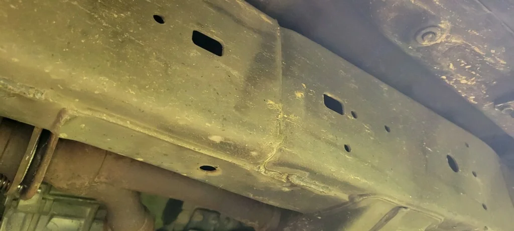

Found one more that has two minor accidents on the carfax and it spent its first few years in NY before ending up in Roanoke, VA. 170k, no indication on when timing belt was last done, but it's probably the cleanest truck I've seen so far. At least I think it is? The owner bought it one year ago as a secondary vehicle and only put 2k on it. He noticed a whirring noise from the rear end and had that replaced during his time of ownership. Receipt shows $2k for that. Disabled and doesn't need two vehicles. Anyone care to give their two cents on the photos? 06, 170k, $9500
Also, I'm not even in the rust belt or anything like that so it's not like I'm limited to rust vehicles or anything like that. I'm in SC, originally from Texas. I check Dallas, Houston, Austin all day. Any other markets I should be checking? Would rust like this be normal even for those markets and I'm just paranoid as hell?
