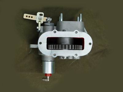

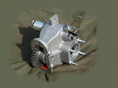

Hi there,
I know somewhere a Landcruiser PTO for sale. I try to find out on what kind of cruiser it was mounted, but at the moment I still don't know.
My HZJ79 is built in 2002, are all the PTO's the same or are there different types of gears etc? On the internet and on this forum I see every time the same mounting plate with 6 holes, so at least the all look the same.
What is the max speed and the max output power of the PTO? Is it possible to use all 5 gears? And is it possible to use the PTO while driving?
And the output shaft also reverse when you put the transmission in reverse? I want to mount a hydraulic pump on it for a salt spreader/sweeper/crane or something else. Has anyone experience with a hydraulic pump on the PTO? Will there be some problems when you reverse? I don't think that the hydraulic pump likes it a lot...
And does someone have pictures of the control lever inside the cabin?
Thanks in advance, and greetz from Holland

It looks like you'd have to get a crankshaft driven PTO to be able to drive and operate the PTO at the same time. Typically you would engage the PTO drive and that disengages the drive to the axles.
the HZJ 79 may mount a bj or an hdj mechanical winch , with some modification on the front part of the frame .
however it can mount ONLY the bj PTO , made for the 5 speed gear box.
all other are NOT adeguate as they are , or must be heavy modified.
pls note there are 3 bj PTO versions.
the 5 speed has only 1 gear faceing the window-
the toyota 80 PTO is definitive NOT suitable , because it has a 10 bolt window , against a 6 bolt widow of a HZJ transfer case.
hope this will help.
rgs Renago
He doesn't want a winch. He wants to run a hydraulic system using the gear from the PTO drive.
Like that...
Buy the mating gasket for the unit that fits your truck and compare it to the unit that is for sale. That will get you started.
Pete
It is possible to use all 5 gears but I don't know if they have a recommended maximum rpm on the PTO. I think you would have to disengage the PTO while you are reversing.
Another way of powering an attachment is an electrically powered hydraulic pump. Its what most operators use now to power small cranes and pumps on landcruisers.
In Australia ,they use a lot of Landcruiser utes for lawn mowing ,spraying weed killer and other things like you want to do and that's what they use. The fire brigade also use electrically powered hydraulics.
The PTO has been deleted from the V8 models I believe because of this.
You can mount the unit anywhere and the end price is probably cheaper than what the PTO set up will be.
