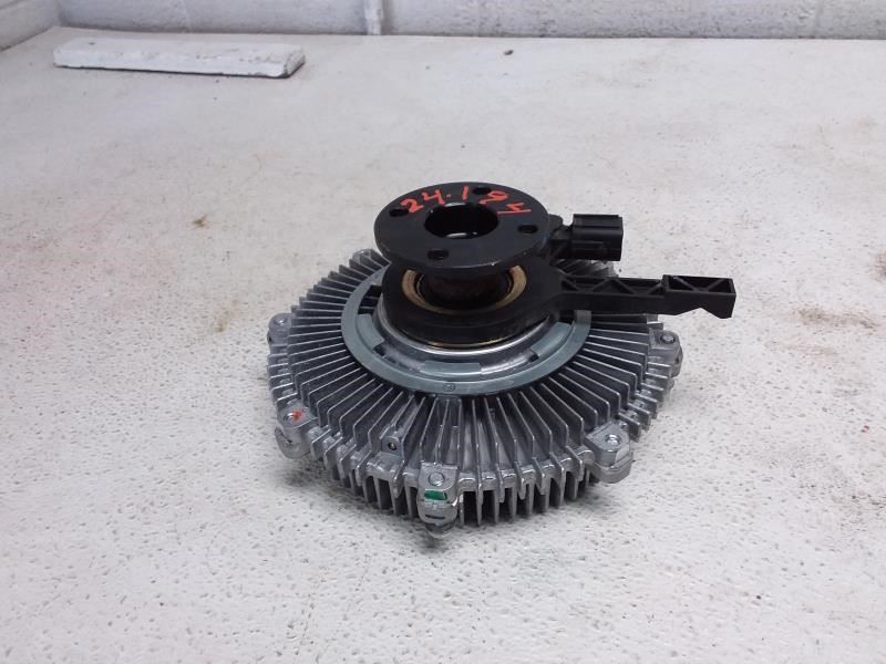

IF I crossed water frequently, I'd consider adapting one of the new fan clutches on the '22+ Tundra. It is has an electric actuator instead, which means it can be disengaged for water crossings. Haven't compared them side by side to see spacing and fan compatibility and such.

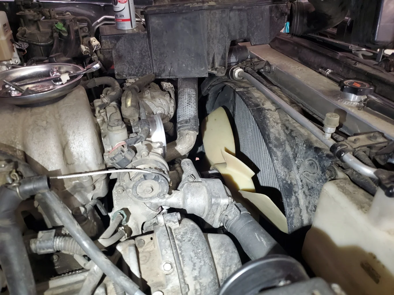

A part of the fan blade broke and struck the radiator causing a coolant leak.. all happened at home while I was working on something else on the engine...
It is VERY important to inspect the fan blades for ANY MINOR CRACKS.. this is where the blade broke!.
