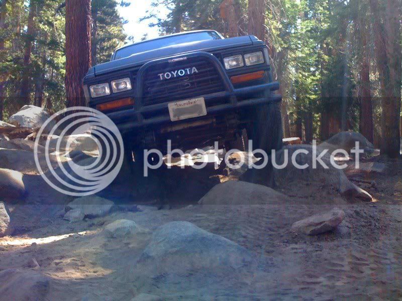

This weekend was the maiden voyage for my stock rig. I met up with a friend in Fresno and we hit bald mountain and camped at red lake in the western sierras. It was a lot of fun but I have many scrape marks under the vehicle.
33 in tires and 2 in lift in the future.
Question: Other than a little lift, what can be done to protect the under belly of my truck? I scraped everything on this trip. Do people modify the position of their shock mounts since they are so low? I want to look into protection through modification to minimize trail damage. I might throw in some better skid plates but that’s just a start. I’d rather fix things now than get stuck on the trail with broken parts.

Rock Obstacle
Leaning Shot
Leaning Shot #2

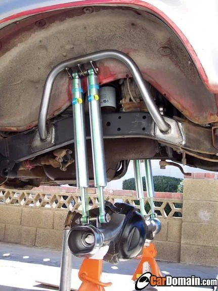

Shock mounts
If you have issues with the shock mounts move 'em! You have the equipment! make some shock hoops while your at it like I did.:clap: Good luck.
Rondog,
What size tires / lift do you have? Great setup!
