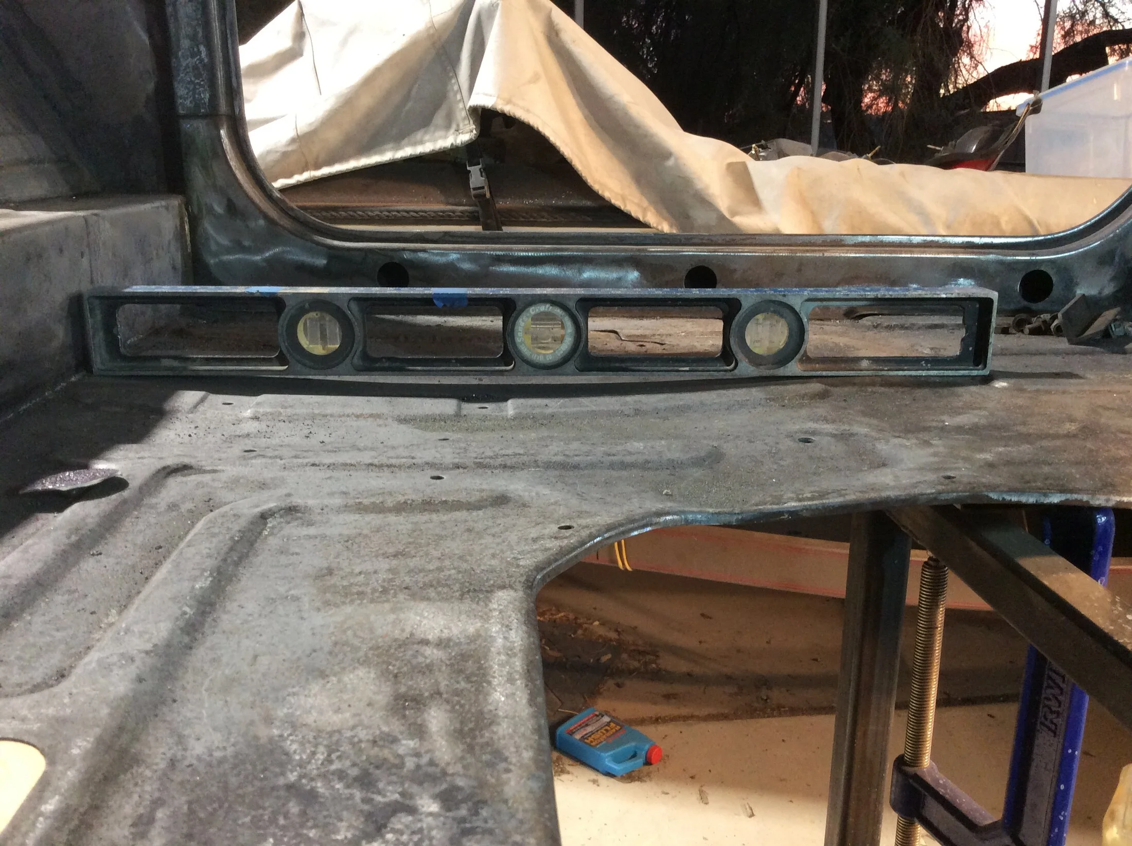

Greetings from Phoenix! I'm the owner of the ashes from a 1977 FJ40 (OME 2.5" + OME shackle reversal, 1998 EFI 350 swap, Saginaw PS, 35" tires). In the fire, I lost every non-metal component in the vehicle, including the engine's air intake and EFI system. At this moment, I have the body fully disassembled and will be fixing the warped floor pans.

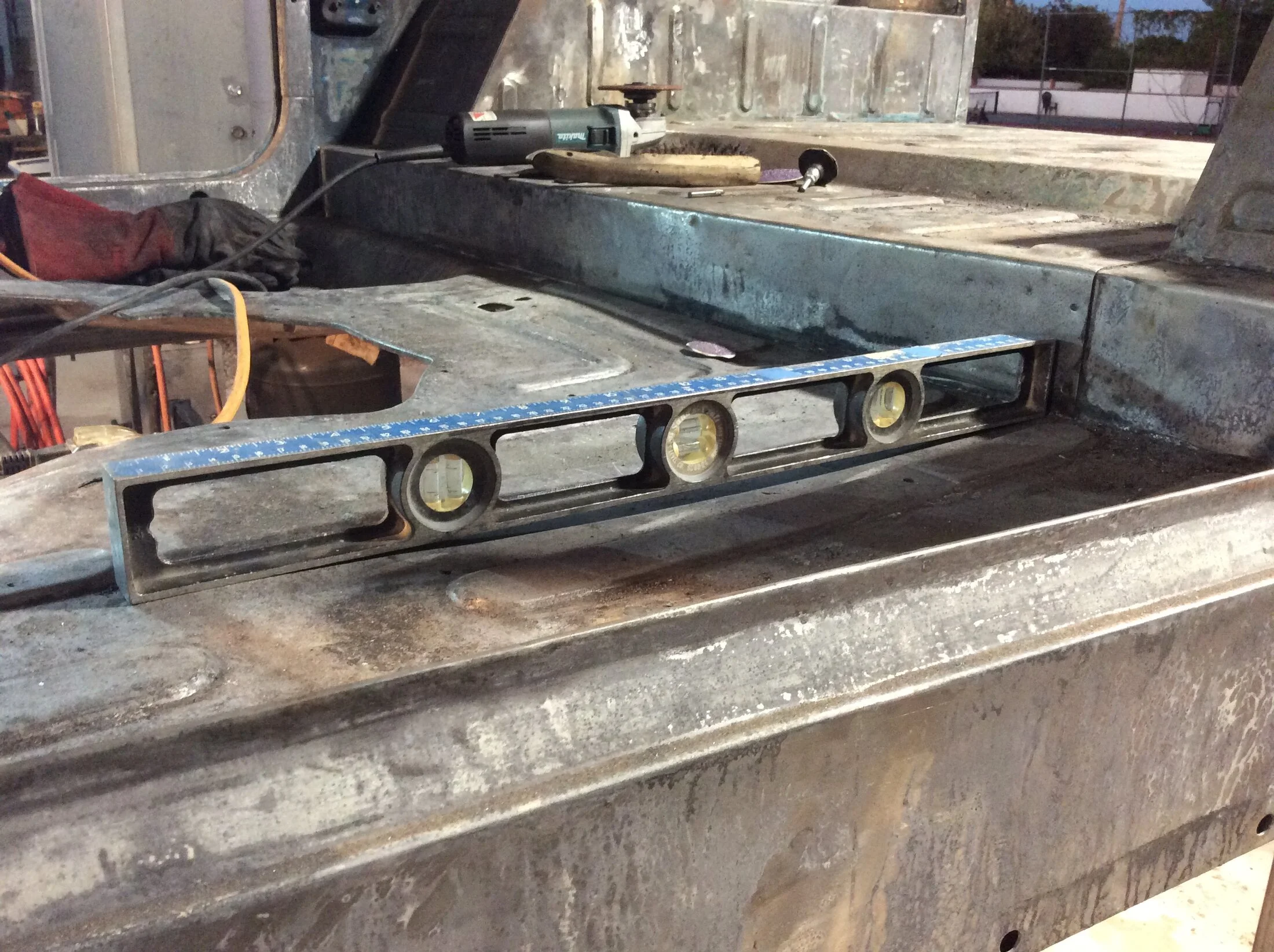

Issue 1: I don't have much experience with sheet metal work. I was thinking about welding the large cracks first, then use a combination of heat and a mallet with a couple of 2x4 boards. Is there anything I could do different that would make it easier? I'm also seriously considering a 28 gallon saddle tank and would like to know how others have reinforced the floor pan in the past. With a couple of fatsos in the seats and 28 gallons, that would come pretty close to 1000 pounds.

Well....the metal there appears stretched (by quite a lot by looking at your level). I don't think you'll get that to come
back truly nicely by pure bend back alone (could be wrong). Hitting it with a mallet may even stretch it more.
I think I'd cut a "T" in it along the two axis that are stretched. Pull everything back to level and remove any
overlap in the T after you get it flat. Then weld it back. Basically I'm suggesting you "remove" metal.
I do not think you can get this stretch out of it with a shrinking disc. There's just too much warp there.

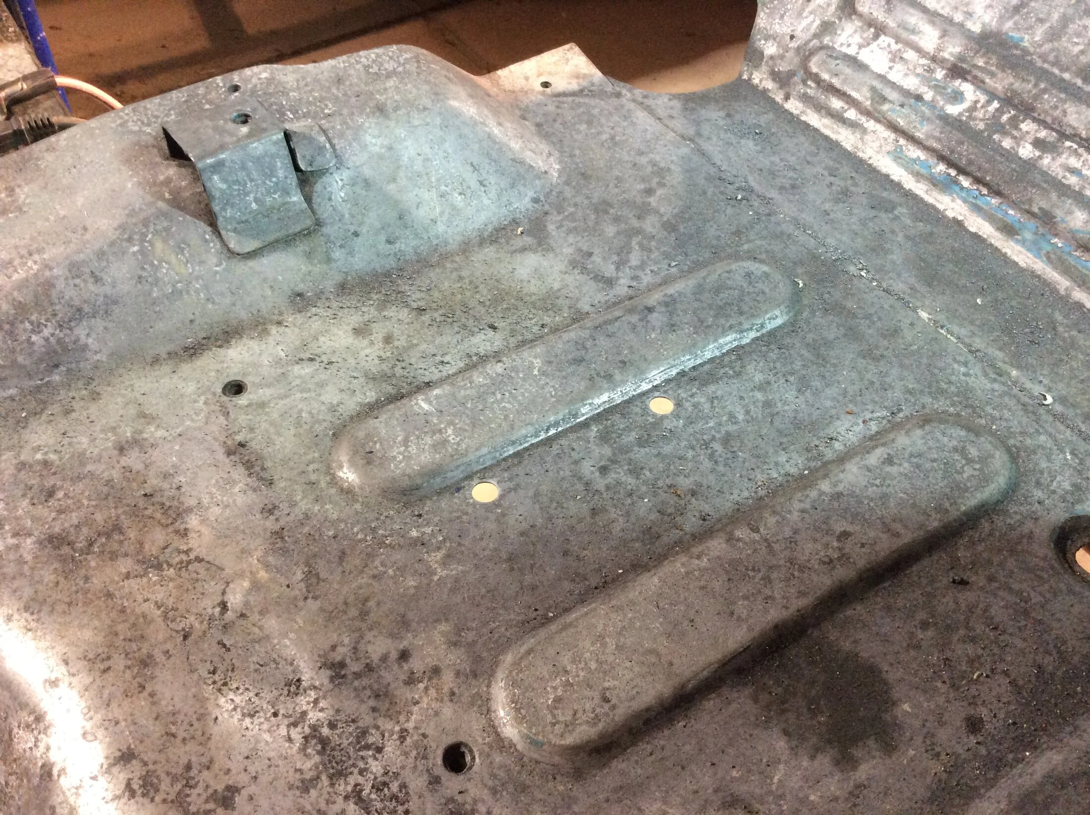

Actually I think they were drain holes. Had rubber grommets in them to you could open them up.
You can buy replacement floor pans from Cool Cruisers of Texas. For the cost and time saved on pounding
heat twisted metal, that would be a better option in both for end result.

Thanks for the advice on floor pans. I think I'll try cutting into it just for the experience of trying. CCOT sells a $400 driver-side pan as a back-up.

Have you tried heating it up then cooling it down quickly. I've only played with this a little bit. I worked on a jeep fender that was oil canning, I used a propane torch heated an area and then cooled it a couple of times.
