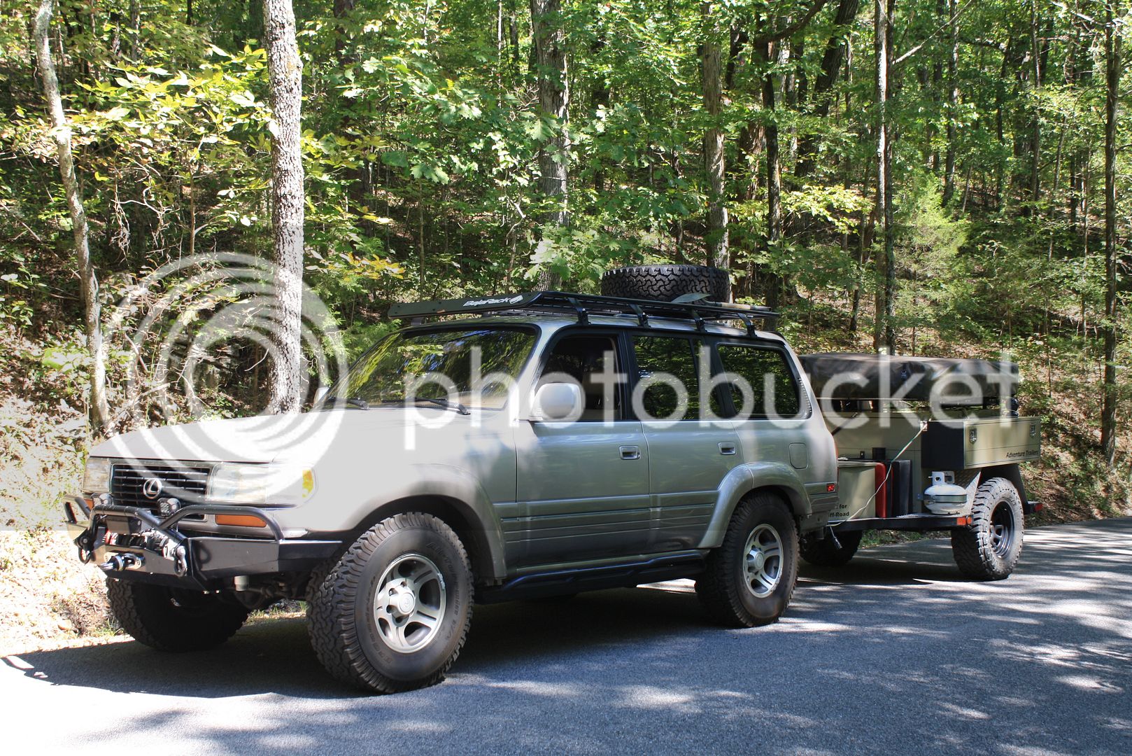

Been a while. I guess it time for an update.
Mounted new bajarack
New slee front bumper
New 12k winch with synthetic line
Had to replace radiator with a new metal one from Onur and fixed my temperature gauge.
Dual battery system is almost done, just have to hook up the batteries.
Hopefully if the weather allows I will install the OME 2.5 lift and the 4x4 lab rear bumper this weekend.
Here is what it looks like now.
It is unfortanate that the radiator went out right before my month long trip out west. I had to leave the Lexus and take my F250.
I have to get better pics of it and not just in the driveway.
By the way while out west I picked up this cool little trailer.
Now I just have to get the rear bumper welded up so I can tow it and go camping.
Small update
Been daily driving the 450 for a couple months since I have been home with zero issues. Took it on a 700 mile trip to an ORV park and did most of the easier trails (was by myself so did not want to do anything more challenging) without any issues.
Took my boys to explore some caves as well
It pulled the trailer with out any issues other than slowing way down on any type of hill climb.
Some pictures.
