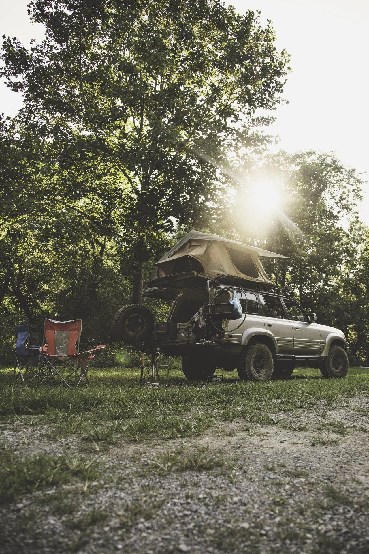

Camping in the mountains of Tennessee near the North Carolina border

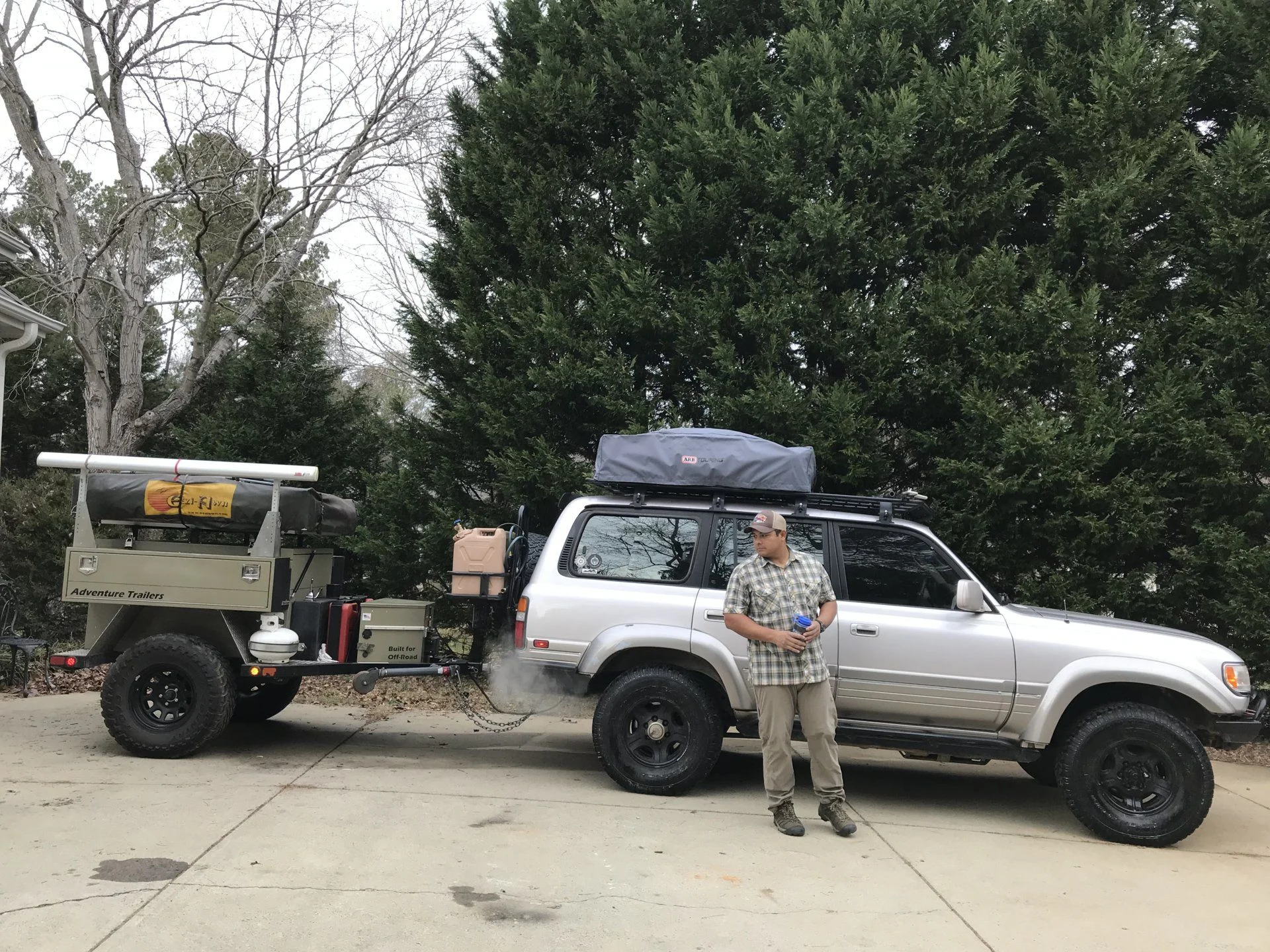

Packed and ready.

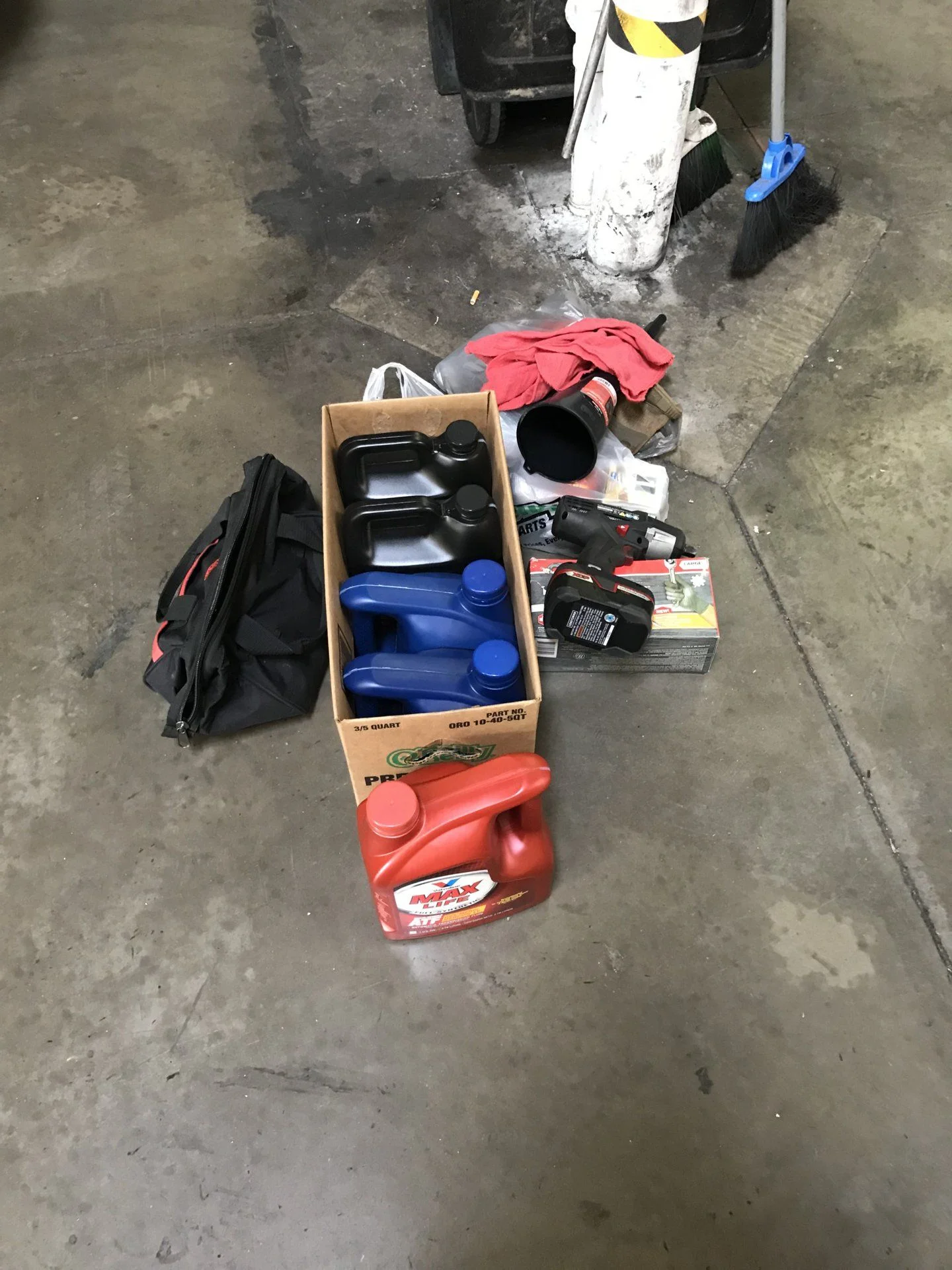

Trip preventive maintenance included
new EBC brakes front and rear. Flushing old brake fluid out.
New power steering fluid.
“1 gallon” transmission fluid change
Motor oil and filter change.

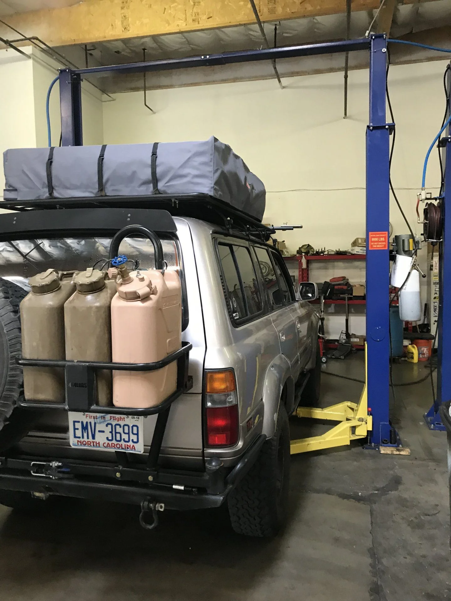

Half way through my trip and after the Mojave portion we headed back to Vegas. While I’m vegas I found a DIY garage and decided to rent a lift for 2 hours to inspect the land cruiser and do some maintenance since I was already close to 3k since the trip had started.
I went ahead and changed the engine oil again as well as another 1 gallon transmission fluid change. I went ahead and drained and filled the 3rds and transfer case since I hadn’t done gear oil change in 30k miles. I also crossed the Mojave River the day prior and wanted to ensure there was no issues with the water getting in there somehow. The Fluid in the front and rear looked brand new but the transfer case fluid looked pretty dark.

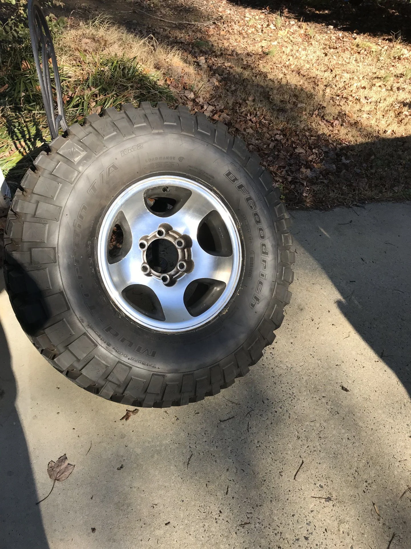

But today I picked up some 315 bfg mt km2 tires. which will get mounted before the rubicon trip in June.
Still have to find a spare but I have plenty of time for that.

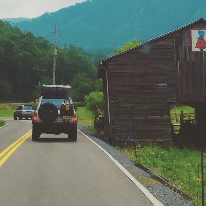

Is this picture near Boone? I went to college there and swear I've driven on this road before, I think there was some mini-horses in that pasture.
I believe that picture is on the Tennessee side on the border between NC and TN.

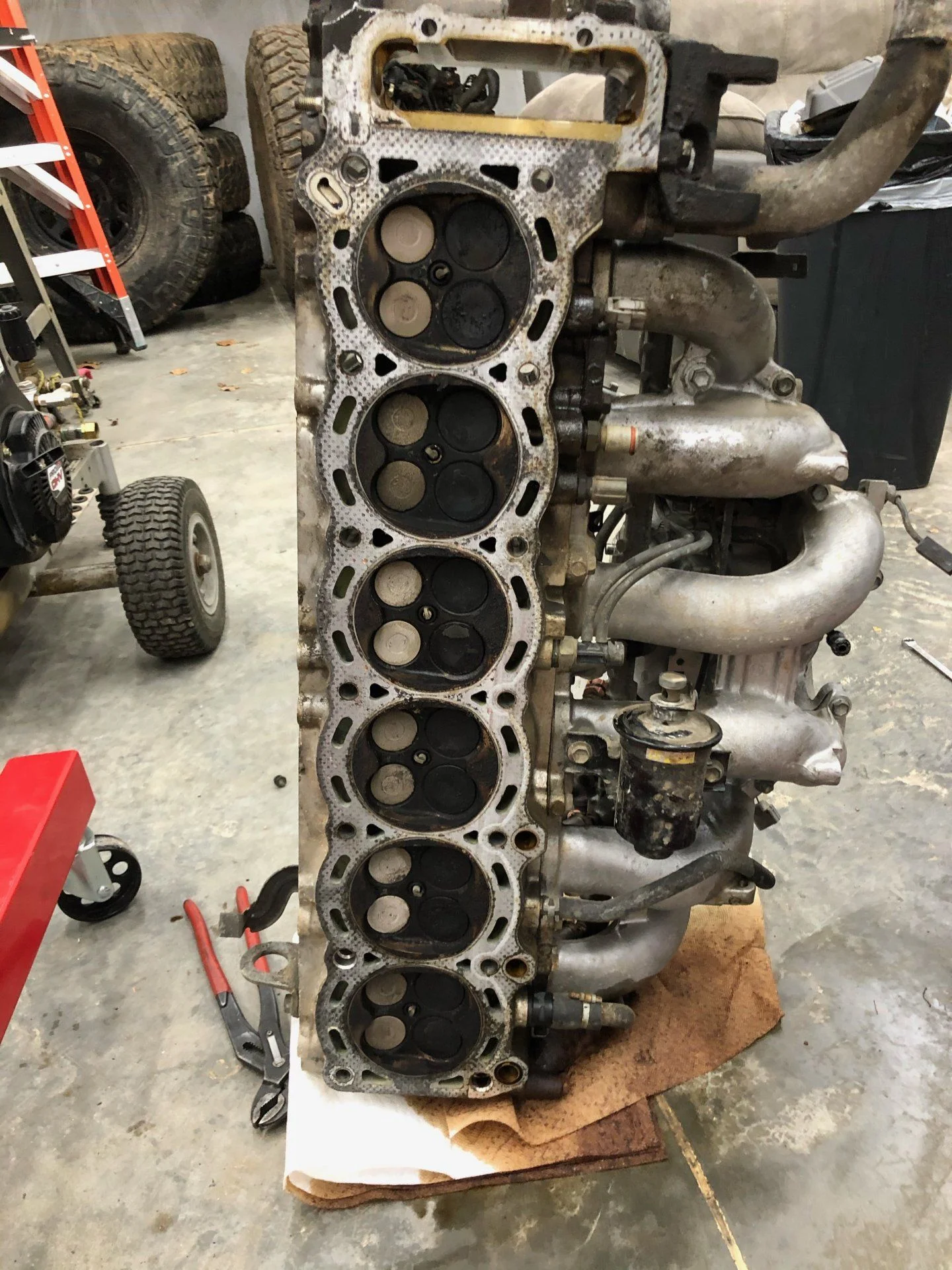

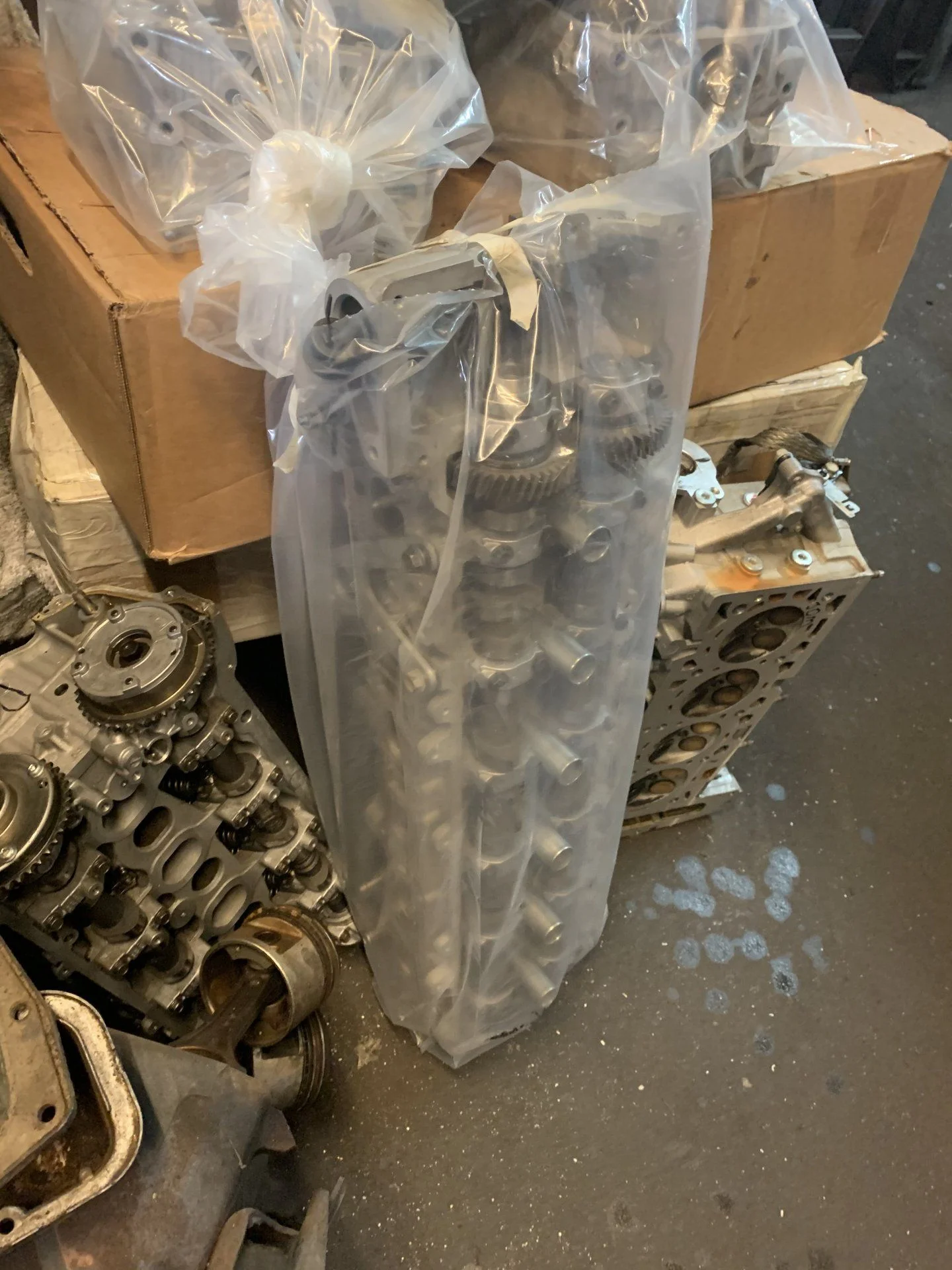

just got done having the head gasket replaced. The machine shop left my head looking better than new. Wanted to knock out the head gasket aa preventive maintenance.
