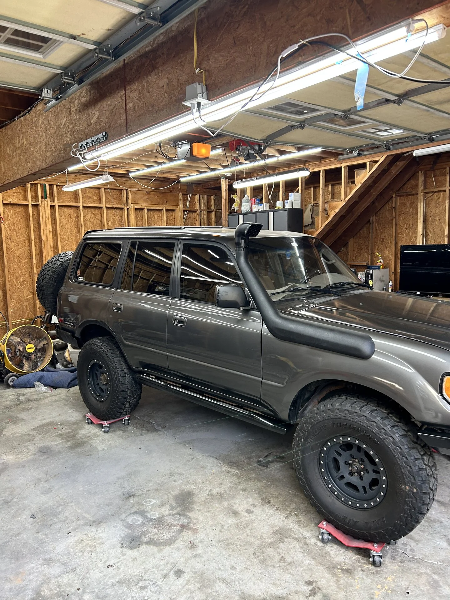

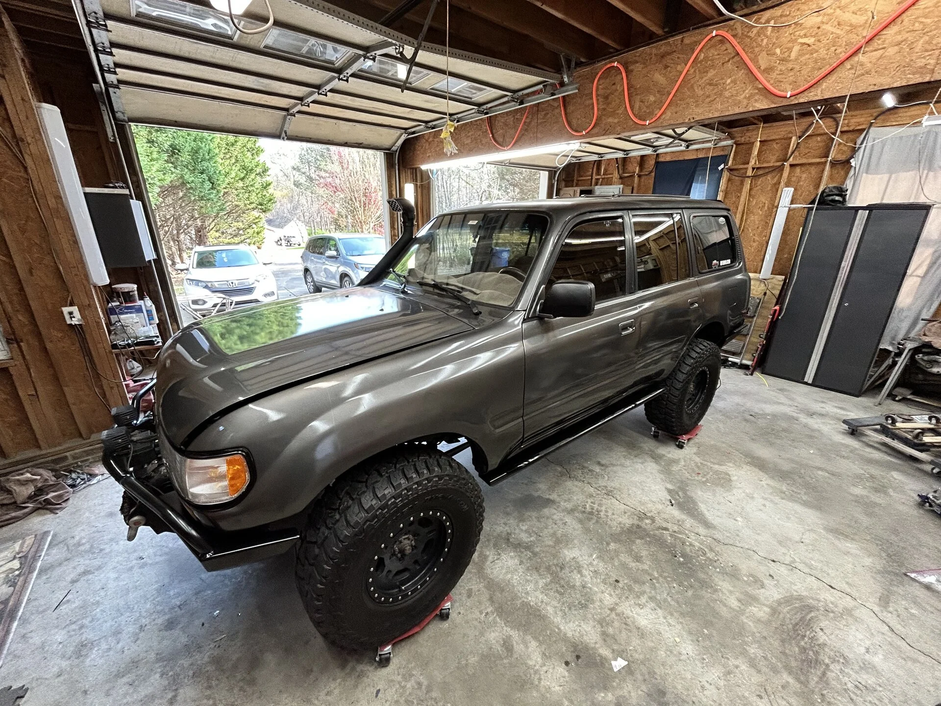

So this is what the 80 looks like now.
I still need to color sand, cut and buff the paint but I will do that at a later time.

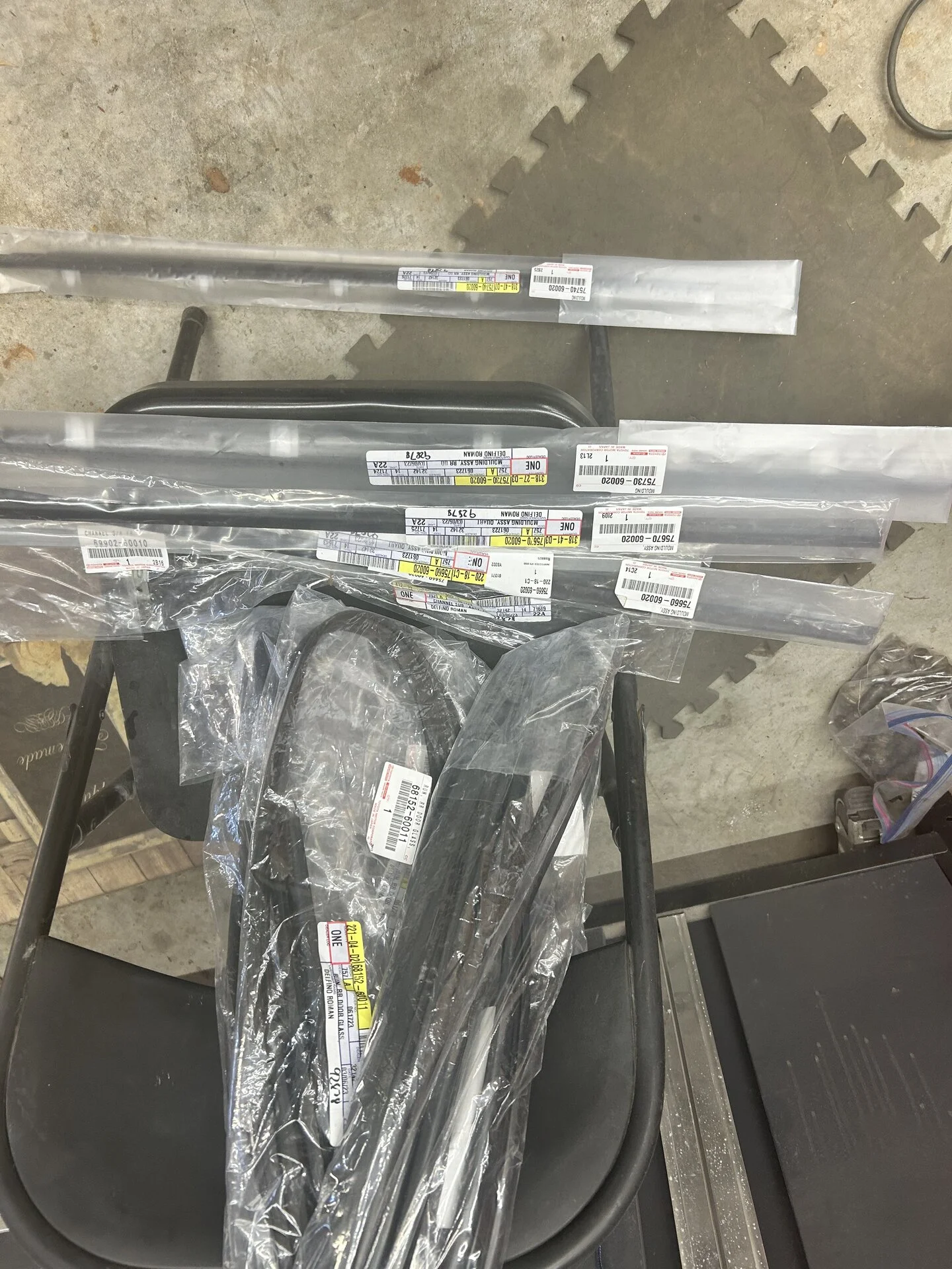

I just ordered all 4 window runs, and exterior window trim since all of mine have seen better days.
My driver window fell off the track. Wanting to repair it is what prompted me to just go ahead and replace the window track for all four windows since the other 3 are also super slow.

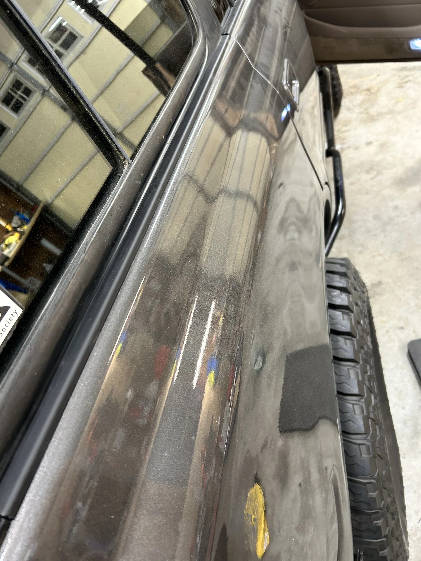

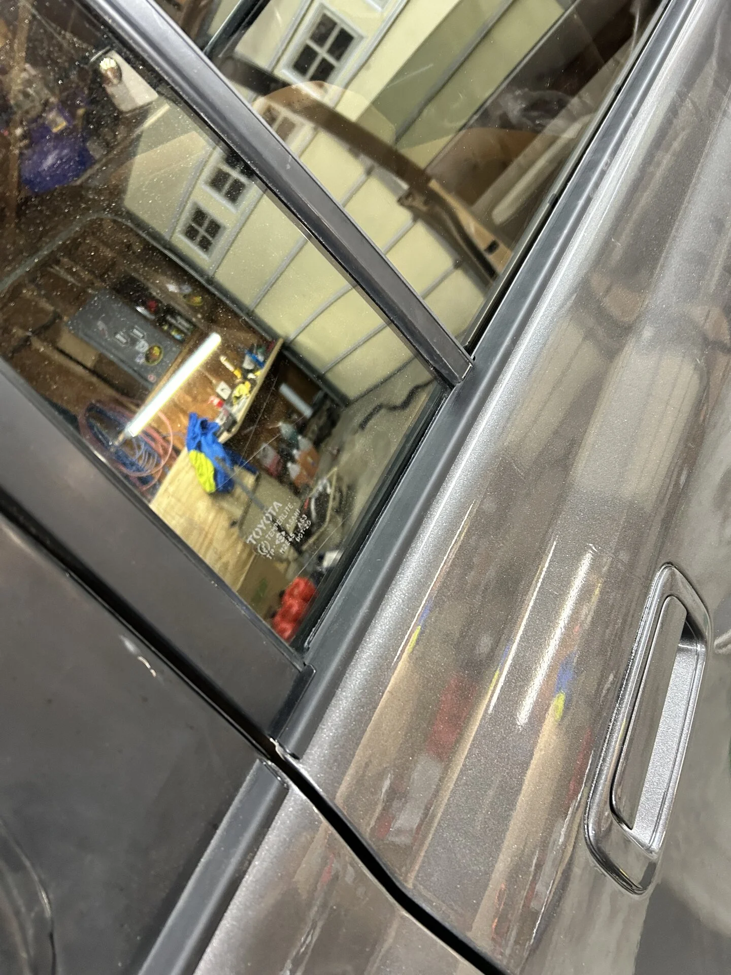

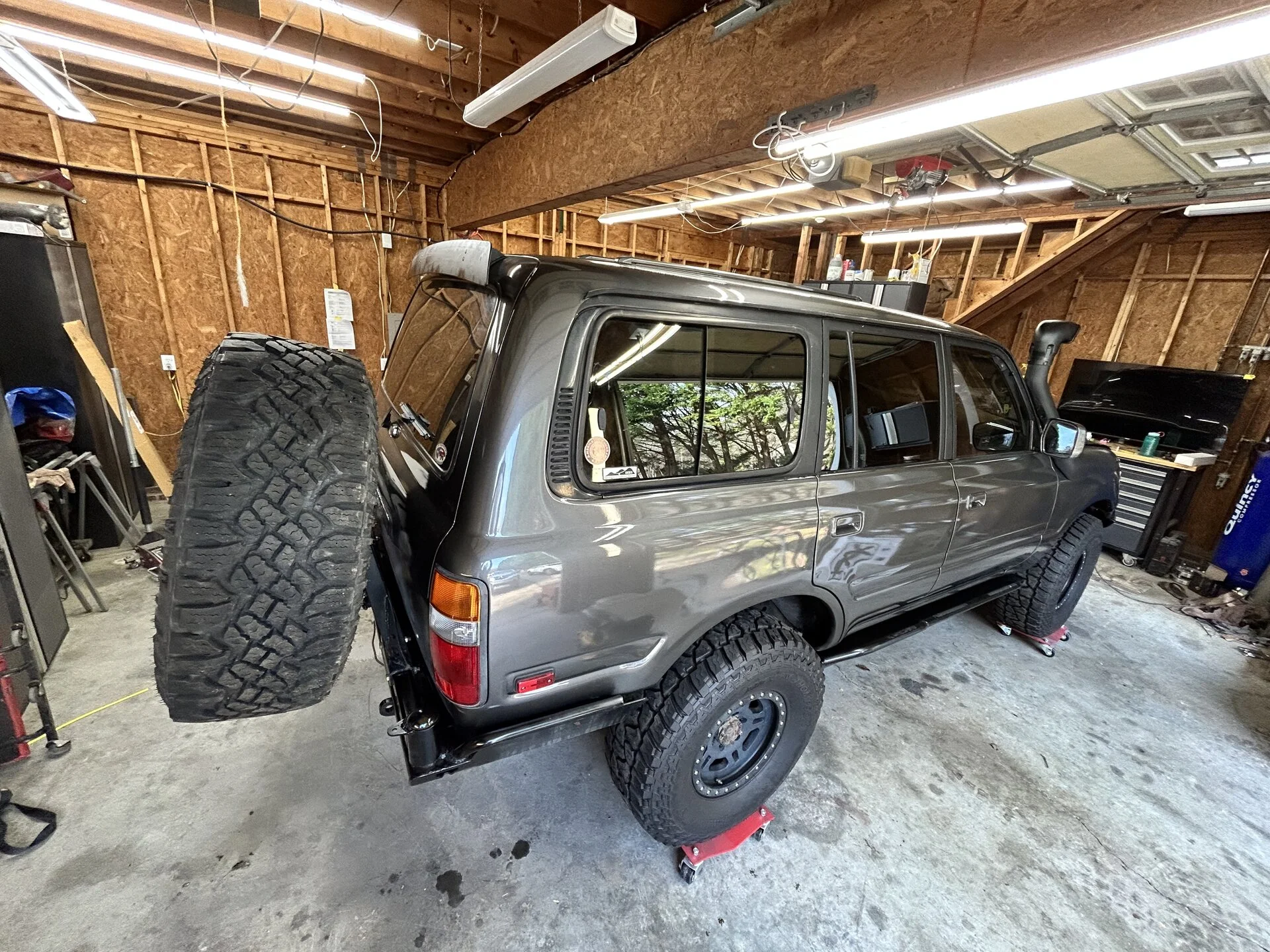

Well, here I am again. Updating my build thread which I keep forgetting about.
I finally finished up covering up all the holes remaining from pulling all the plastic cladding.
I documented how I did it here:
View attachment 3266065View attachment 3266067View attachment 3266066

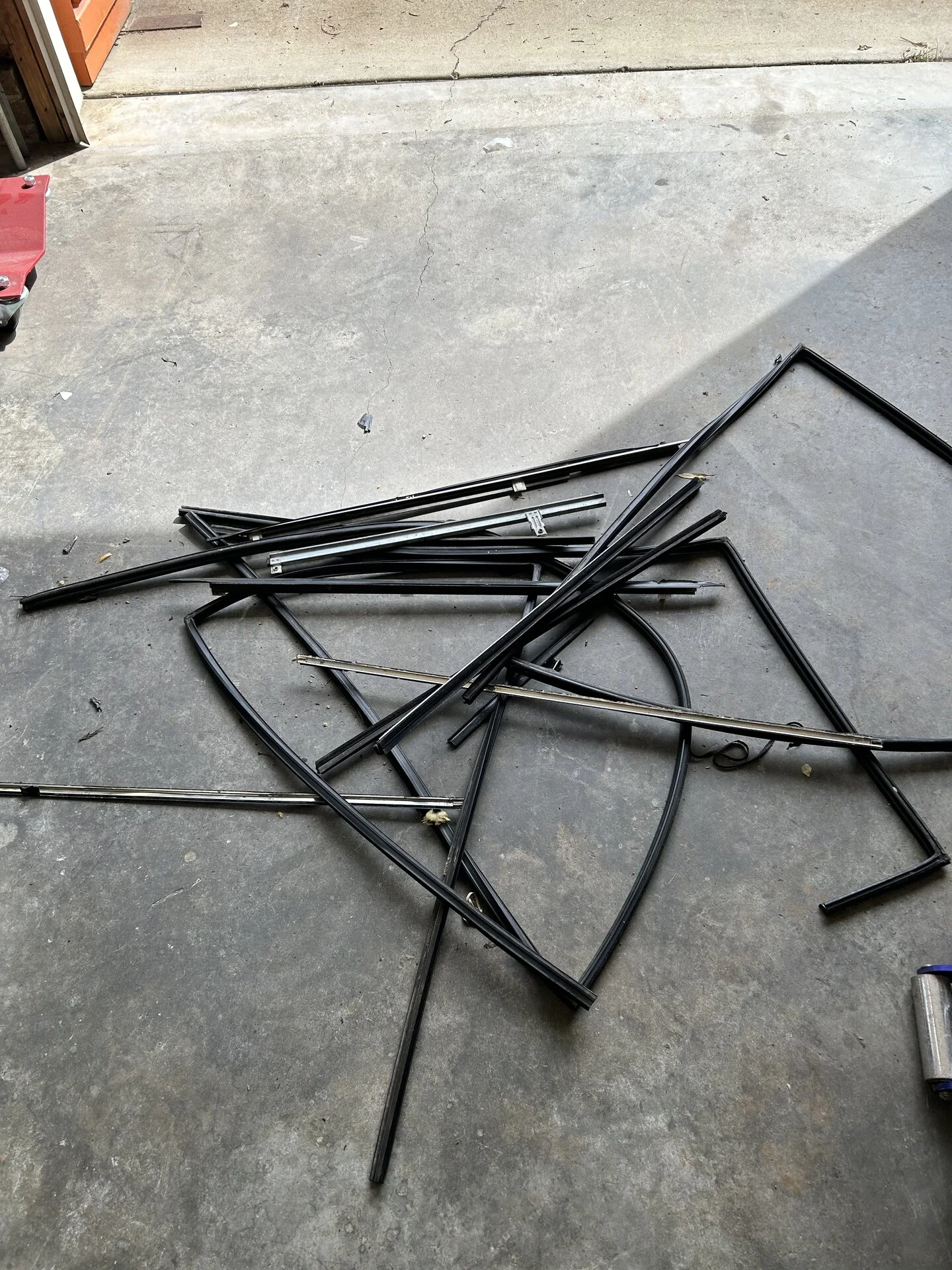

Replaced all plastic And trim pieces from the windows and doors.

All the old crap going to the trash.
All 4 windows are running smoothly just like new. No more issues.

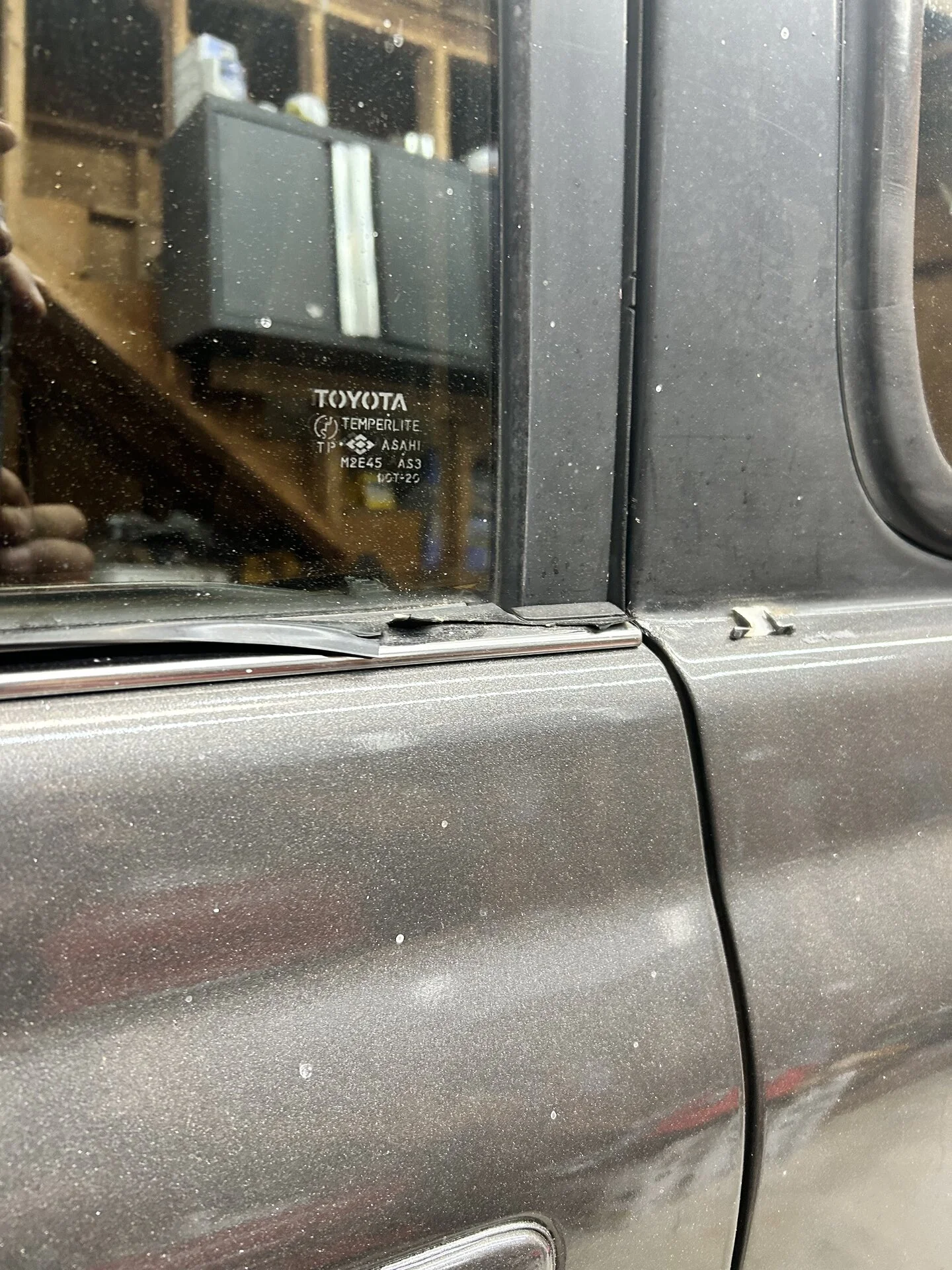

The small trim underneath the windows. Sorry for not being so specific.
No problem.
The small trim is super easy. The new one comes with its own clips.
Pull the old one off. The plastic clips are likely going to stay on the body. Just use a small pick to pry them off and toss them.
Line up the new piece of trim under the window and adjust the small
Plastic clips to match the holes on the body. Once aligned snap them into place. Those were the easiest out of all of them.
