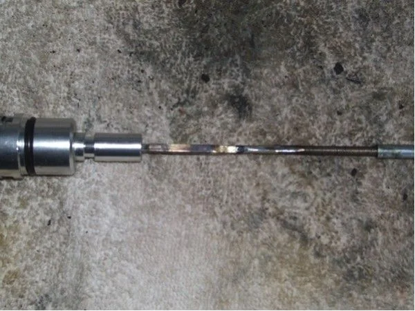

With a propane torch and some brazing rod I solidified the cut end of the speedo cable.

Little bit of fancy grinding of the cable end and it fits into the copper tubing..
I also brazed the speedo cable to teh square tubing. This way it won't come off easily and I can still replace the VSS without issue.

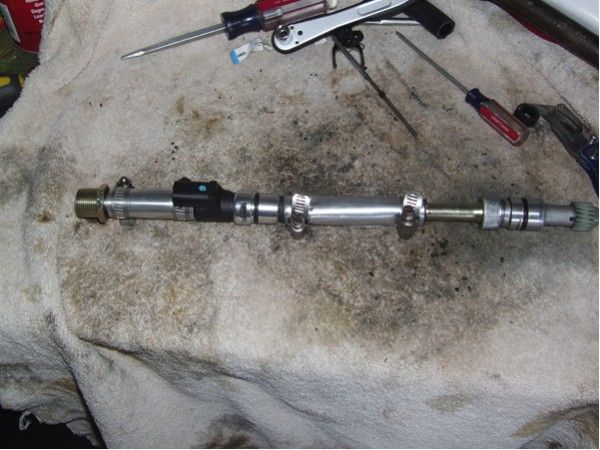

I brazed the other cut end of the speedo cable just like I did the first, ground it into a square tip so it fit into the opposite end of the VSS.
Add the rubber tubing to protect the spinning parts and roll the sheetmetal around it to add some rigidity/protection.
Done..

BTW, if I were to do it over again, I would make the tcase end of the VSS flexible. Anyone have a spare speedo cable they want to donate??
