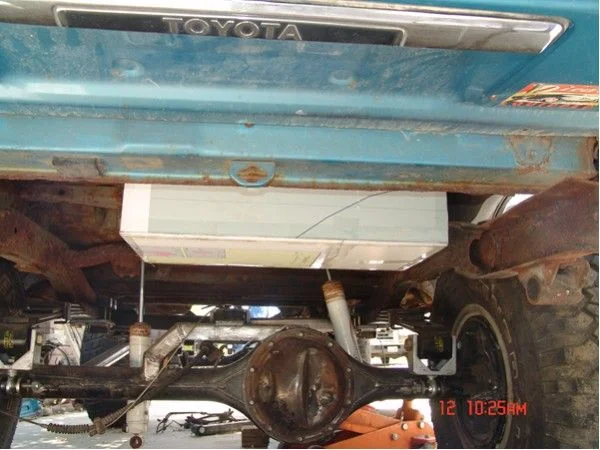

But I did get the fuel cell mocked up and the fule lines ran.
Pics in a sec.
Got the fuel tank mocked up. It is a bit over 25 galls and goes from the inside of the bed through a hole to the underside of the truck.
4" into the bed of the truck,
9" below the bed of the truck.
With allowances for a muffler system or underbed air tank on the other side.

The stock filler turned around worked perfectly.. A bit of 2" hose and 2" AL tubing and away we go..
You can also see the dimensions of the tank and the hoe that was removed form the bed of the truck.
