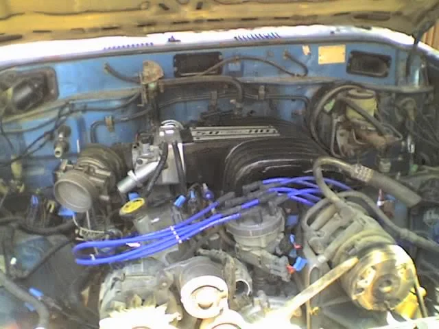

Got a bunch a litle stuff done today.
Replace the EGR spacer with one that was proper for this application
Installed the Tranny kickdown cable. Wired it..
All I have left to do is the fuel cell, finish the radiator mounting/fan shroud, driveshafts and run a couple of brake lines..

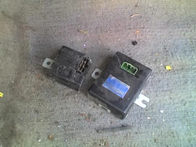

The ford ECM mounted in place of the stock door (or seatbelt) buzzer and the carb fan controller. Doubt I am gonna miss either ;)
fit right behind the kickpanel ;)
