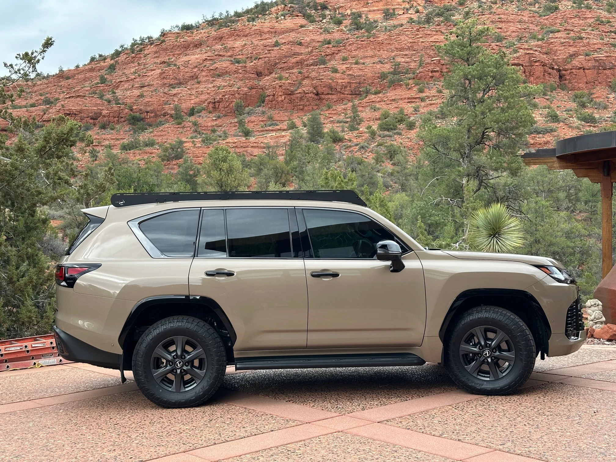

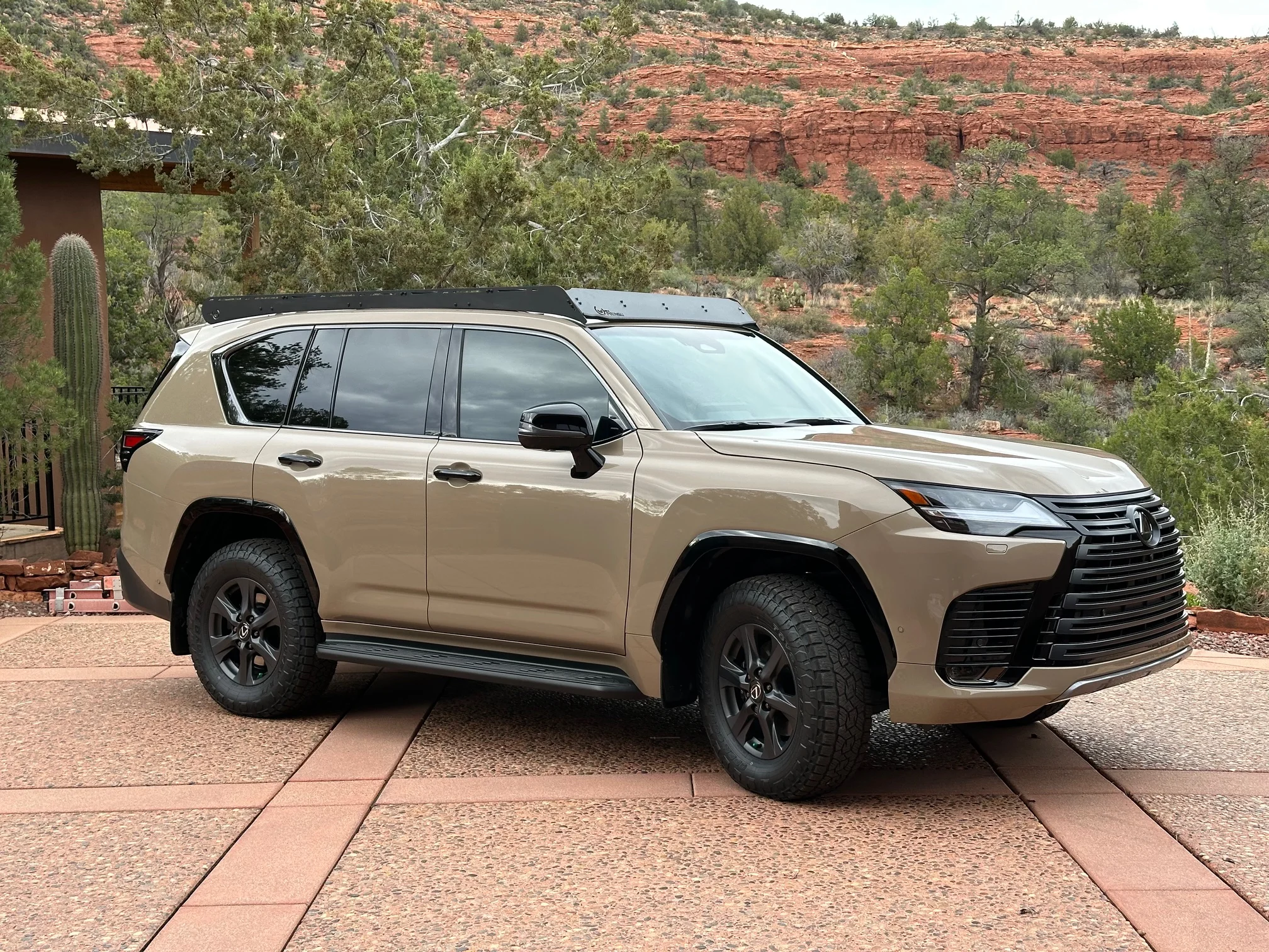

Today I installed the Prinsu roof rack made for the LX 600. I purchased it directly from Prinsu. It was not an easy install. I had to modify the mounting feet in the front and the spacers which go between the foot and the rail on the LX. It appears that the rail on the LX 700h Overtrail are slightly closer together by 1/3 to 1/2 an inch from the standard LX these were initially fitted for. I was aware that the web site said the rack was for 2022-2023, but elsewhere it note it as 2022 to Current.
Also, the install documentation has a number of errors in it. They say to measure 16 inches from the windshield, where as the proper install location is 16 inches back from the front of the roof rail on the LX. They also say to tighten the plus nuts to 20 foot inches. I even called support to confirm and they said yes because they read the documentation which is wrong. About 8-10 foot pounds was about right. 20 foot inches was not even enough force to get them started. They also say to use the phillips screws for the front foot because it is closer to the rail, but they did not include any of these with the install kit.
I have a few other tips if anyone else has plans for this and would like more observations.
Anyway, I got it done and it looks great.

Today I sintalled the Prinsu roof rack made for the LX 600. I purchased it directly from Prinsu. It was not an easy install. I had to modify the mounting feet in the front and the spacers which go between the foot and the rail on the LX. It appears that the rail on the LX 700h Overtrail are slightly closer together by 1/3 to 1/2 an inch from the standard LX these were initially fitted for. I was aware that the web site said the rack was for 2022-2023, but elsewhere it note it as 2022 to Current.
Also, the install documentation has a number of errors in it. They say to measure 16 inches from the windshield, where as the proper install location is 16 inches back from the front of the roof rail on the LX. They also say to tighten the plus nuts to 20 foot inches. I even called support to confirm and they said yes because they red the documentation which is wrong. About 8-10 foot pounds was about right. 20 foot inches was not even enough force to get them started. They also say to use the phillips screws for the front foot because it is closer to the rail, but they did not include any of these with the install kit.
View attachment 3883008View attachment 3883011

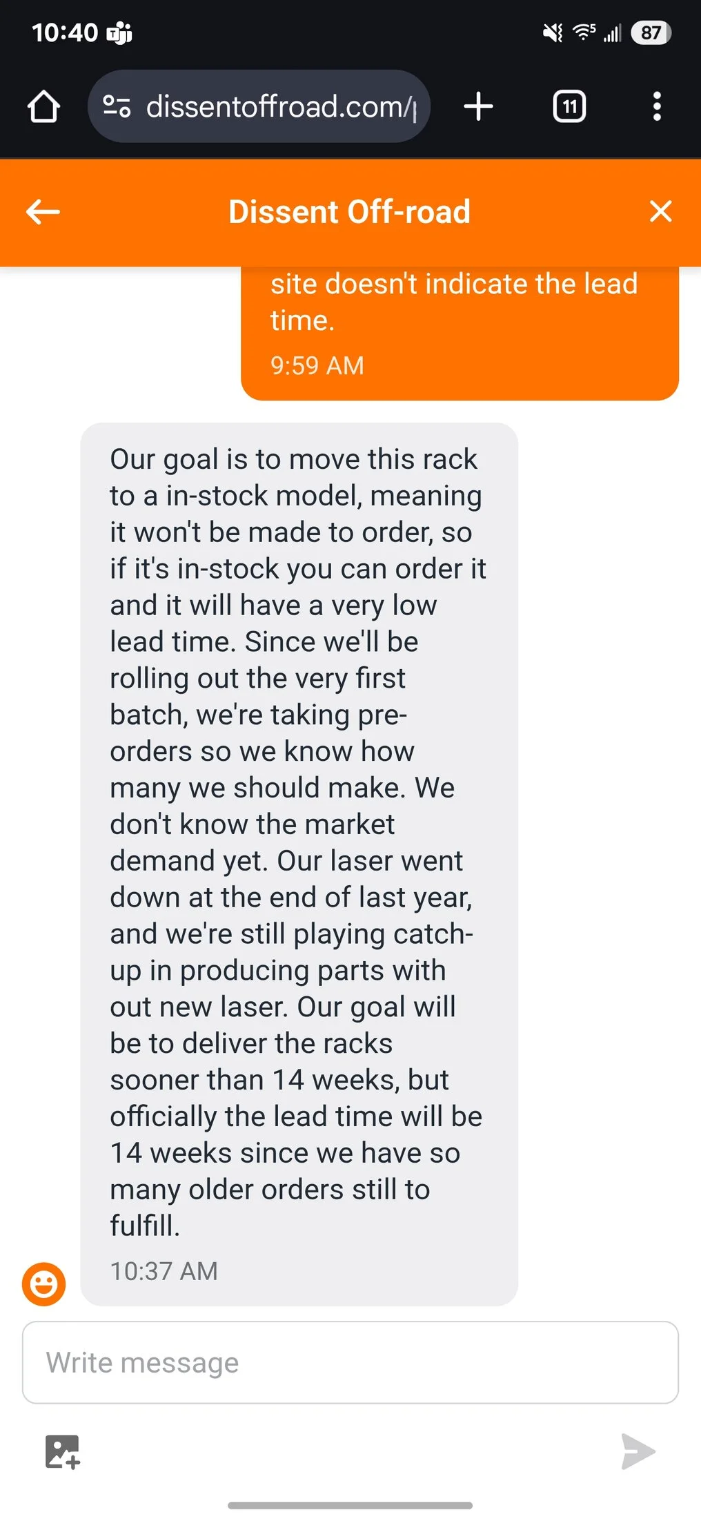

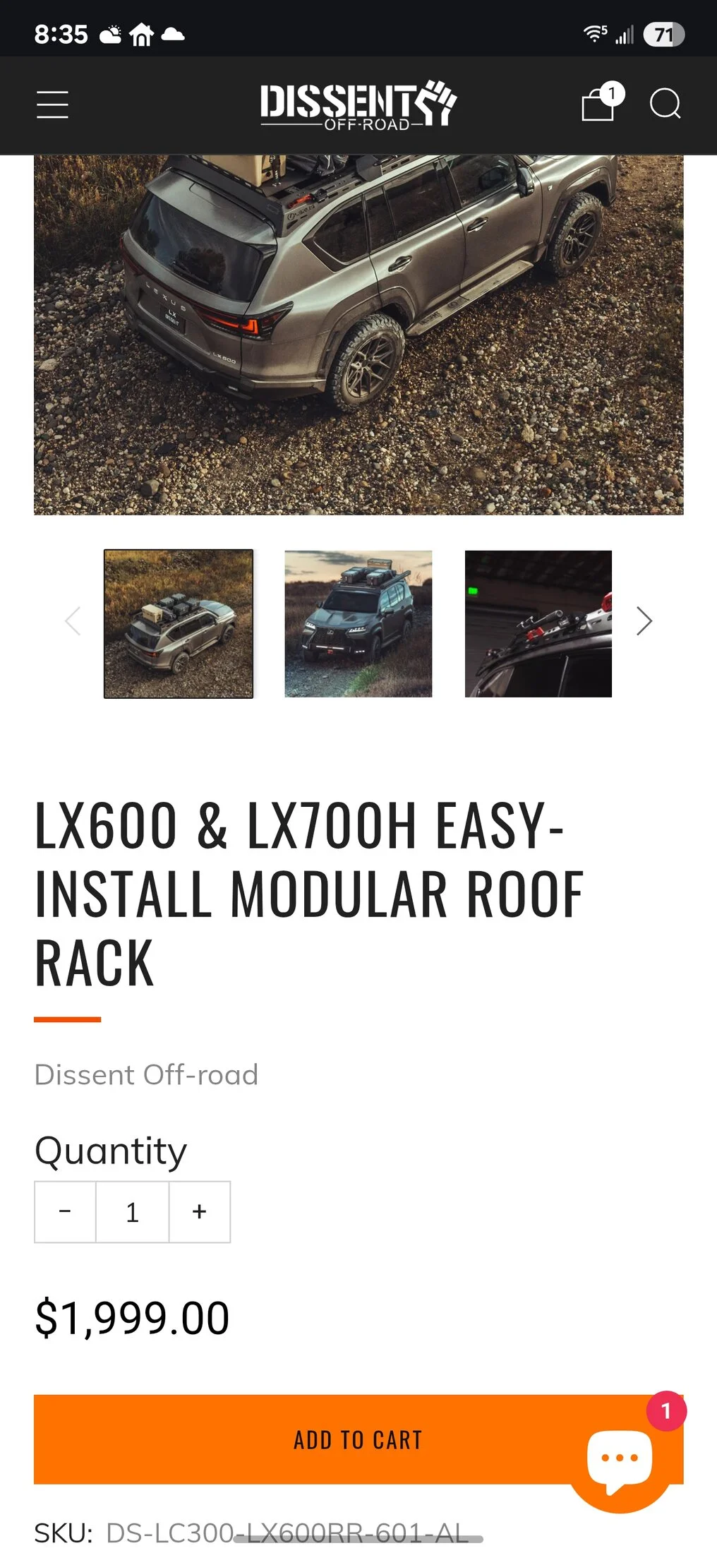

I like the look of the Dissent rack, but I consider it vaporware if you can't actually buy it. Their site calls that a prototype and if you click on the info they have regarding lead times, the LX700 is not even listed.. If it's real, they need to have at least a few in inventory at any given time.
Looks like you can finally add it to the cart (as opposed to their other LX offerings).
True, but if you click on the "lead times" link, it's unclear when you will see your rack! I don't really want to drop $2k if it takes a year. I feel that as a business, they need to be much more transparent about when a customer can expect the product.
Whole lotta nothing in that response. "Our goal...don't know demand...laser went down...don't know lead times...we are backed up with other orders..."
If anything is going to curtail demand, it's this approach to running a business. These guys have plenty of time to post videos on social, but not actually make the parts they claim to make.

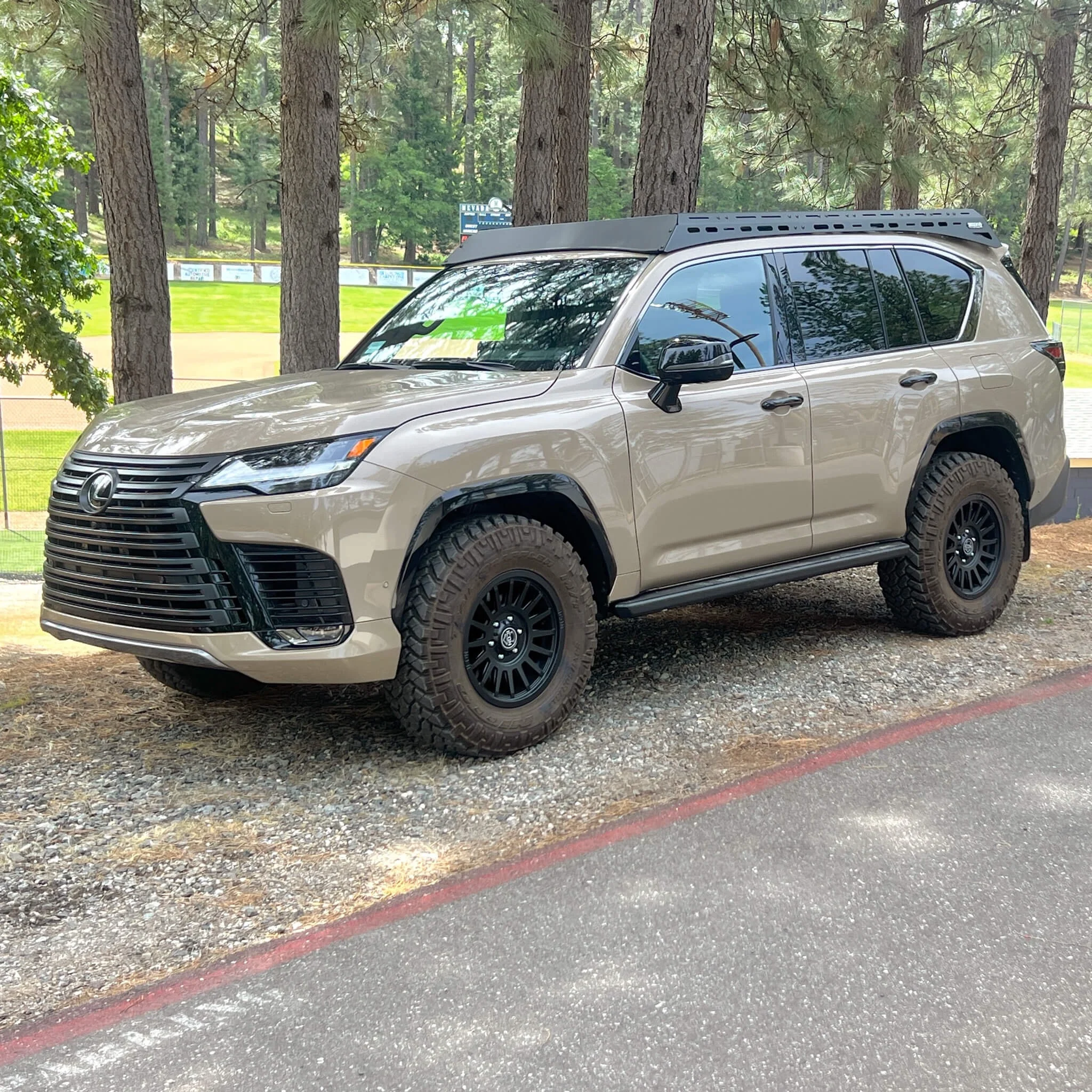

Where’d ya grab that from?? I really want to know about that tire size and wheel offset.
IKR, my Icon 17s are +25 (on my 200). I can't tell if those are 33s that look like 35s because they're MTs. Those sliders have me hoping Dissent will do some kind of package deal with the rack.
