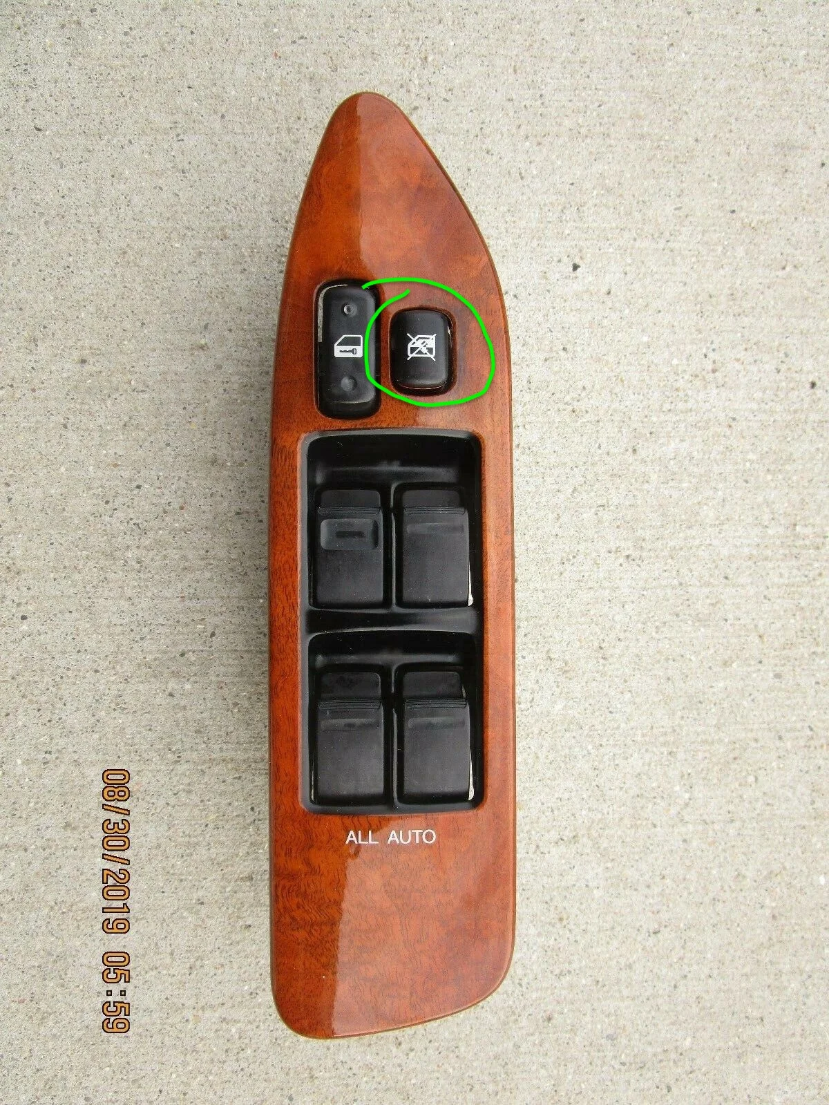

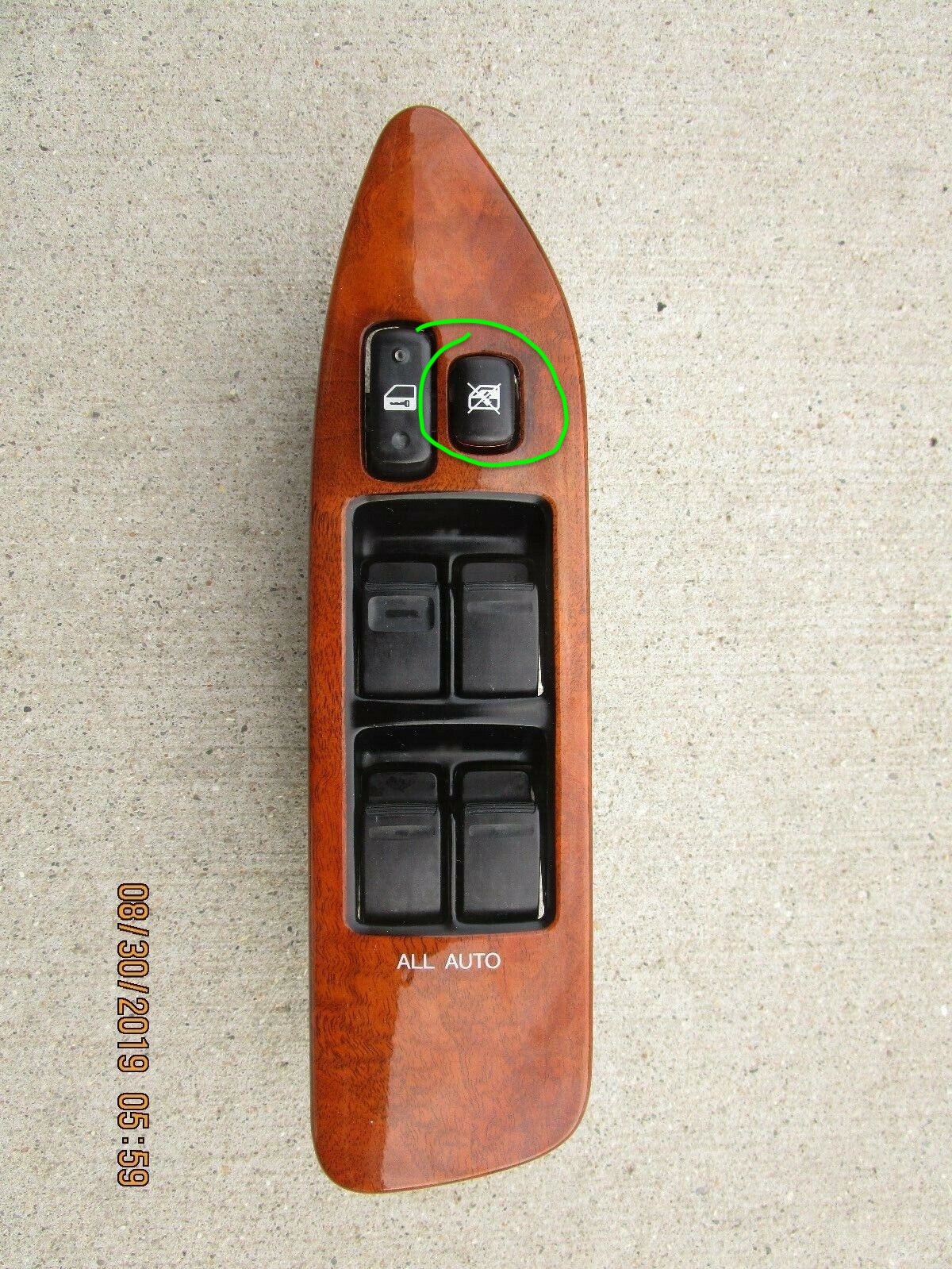

I got in my 2001 100 series one morning and went to roll down all my windows and got nothing but the driver side to roll down. I have done 5 seconds down 5 up all the way around many times and have had no luck. I pulled the boot in the door hinge out and no wear or tear to any wires in the boot or anywhere between plugs. No fuses bad. Driver side window works perfect from master switch but no luck on any other windows from their own switch or master. What else could i look for to fix this?
I forget if this button prevents the master from also operating the windows?
If somebody can confirm, when button pressed, those windows won't roll down even at master switch... then I'd suspect the button is broken somehow....
