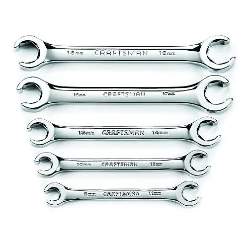

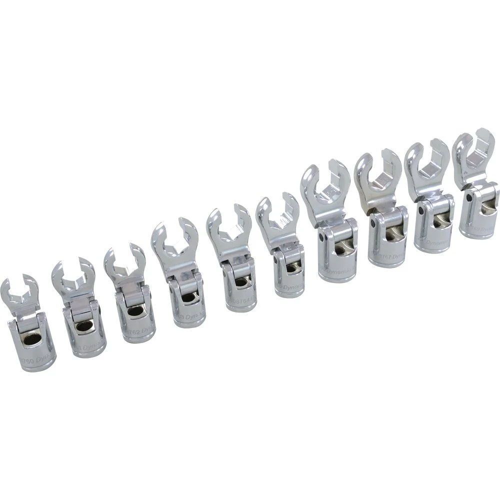

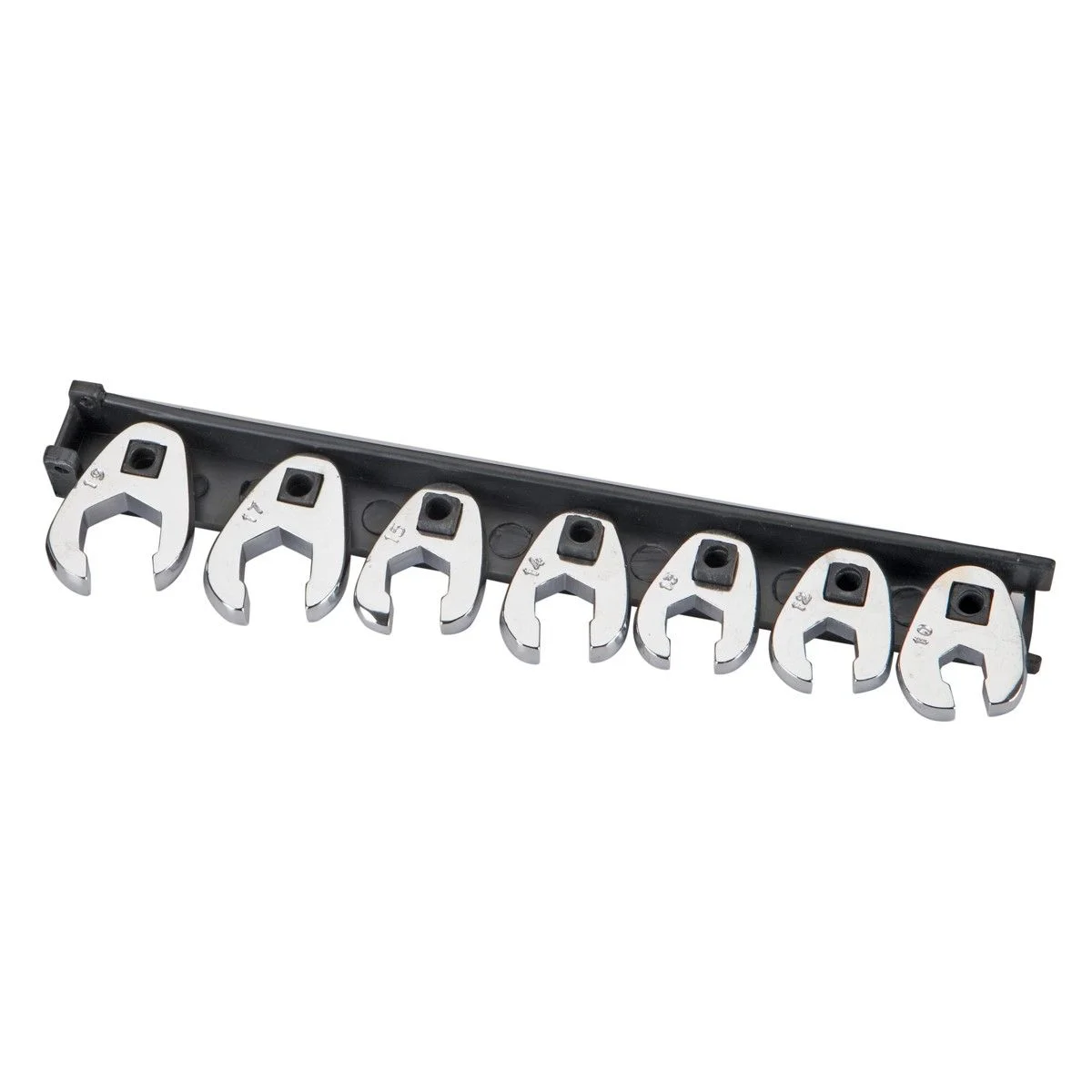

Flare nut tools are handy.
@2001LC thanks for the information. Harbor freight is not to far from me if it comes to that.

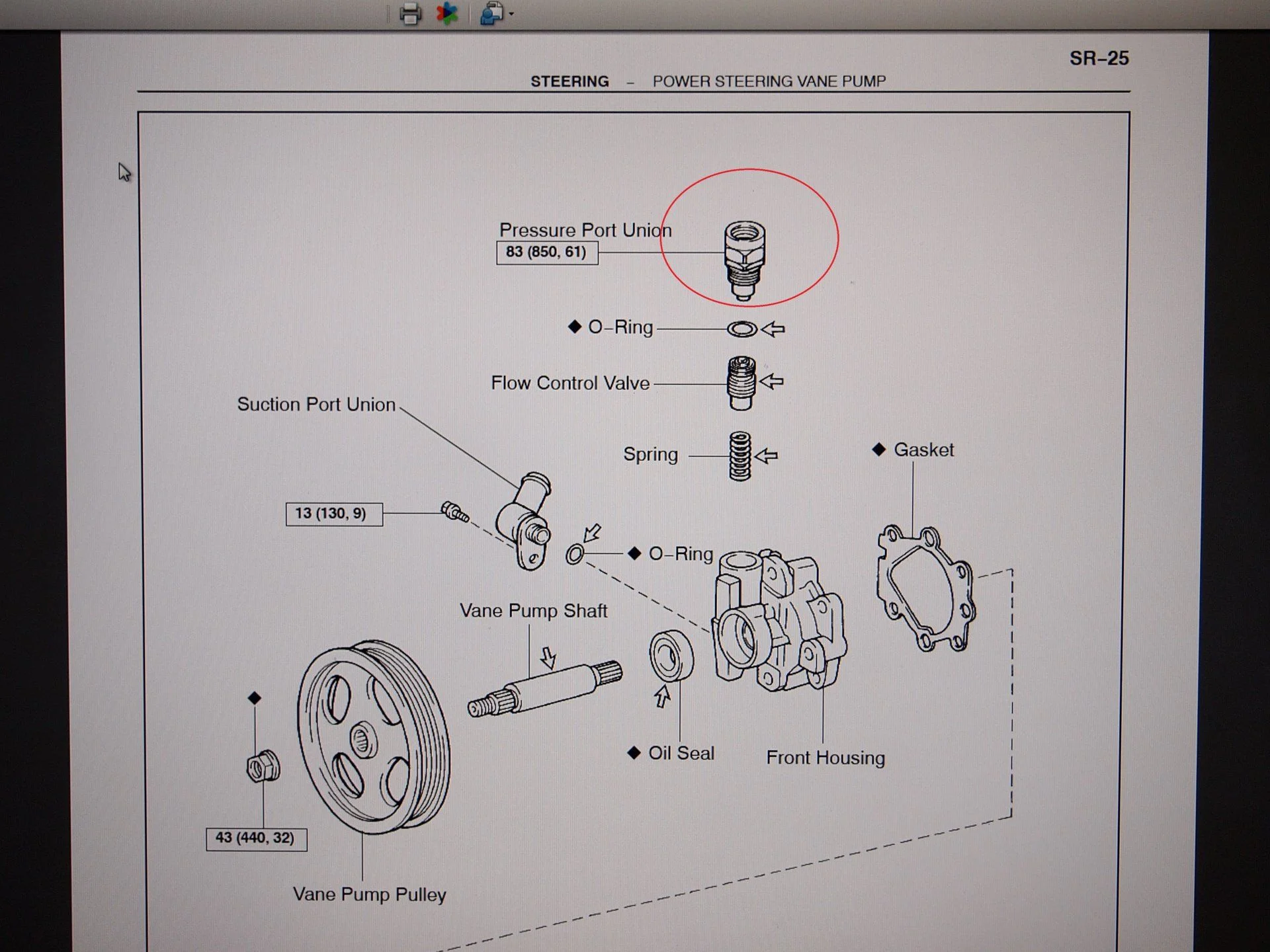

Make sure to hold lower part of nut (pressure port union) on vane pump as you break loose union bolt on top of HP line.
