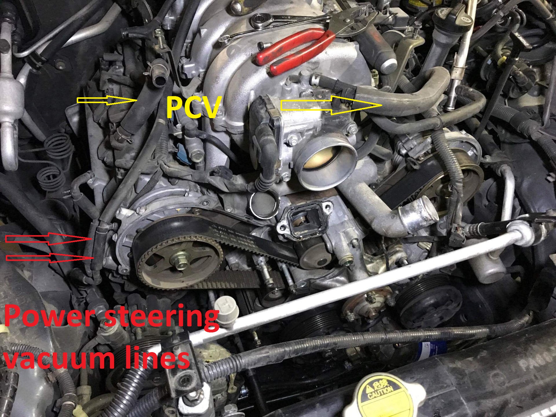

Idle up control valve: Is on PS vane (power steering pump) side of HP line. It has two vacuum lines attached to it.
View attachment 3831735View attachment 3831736
View attachment 3831737View attachment 3831738
