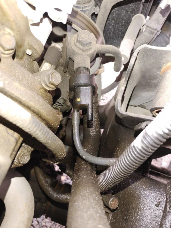

My '04 LC100 has developed a leak in the power steering hose assembly. The oe part ( 44410‑60593 ) is available but spendy @ over $500. The aftermarket part options are around $200.

Looks like fluid is blowing out that port on the valve where you’re missing a vacuum hose, not the PS hose.
Seems like everyone has an opinion but this is the only one with any logic.
That little air vane or whatever the heck it's called is supposed to have another line running up towards the intake . I could take pictures if needed.
