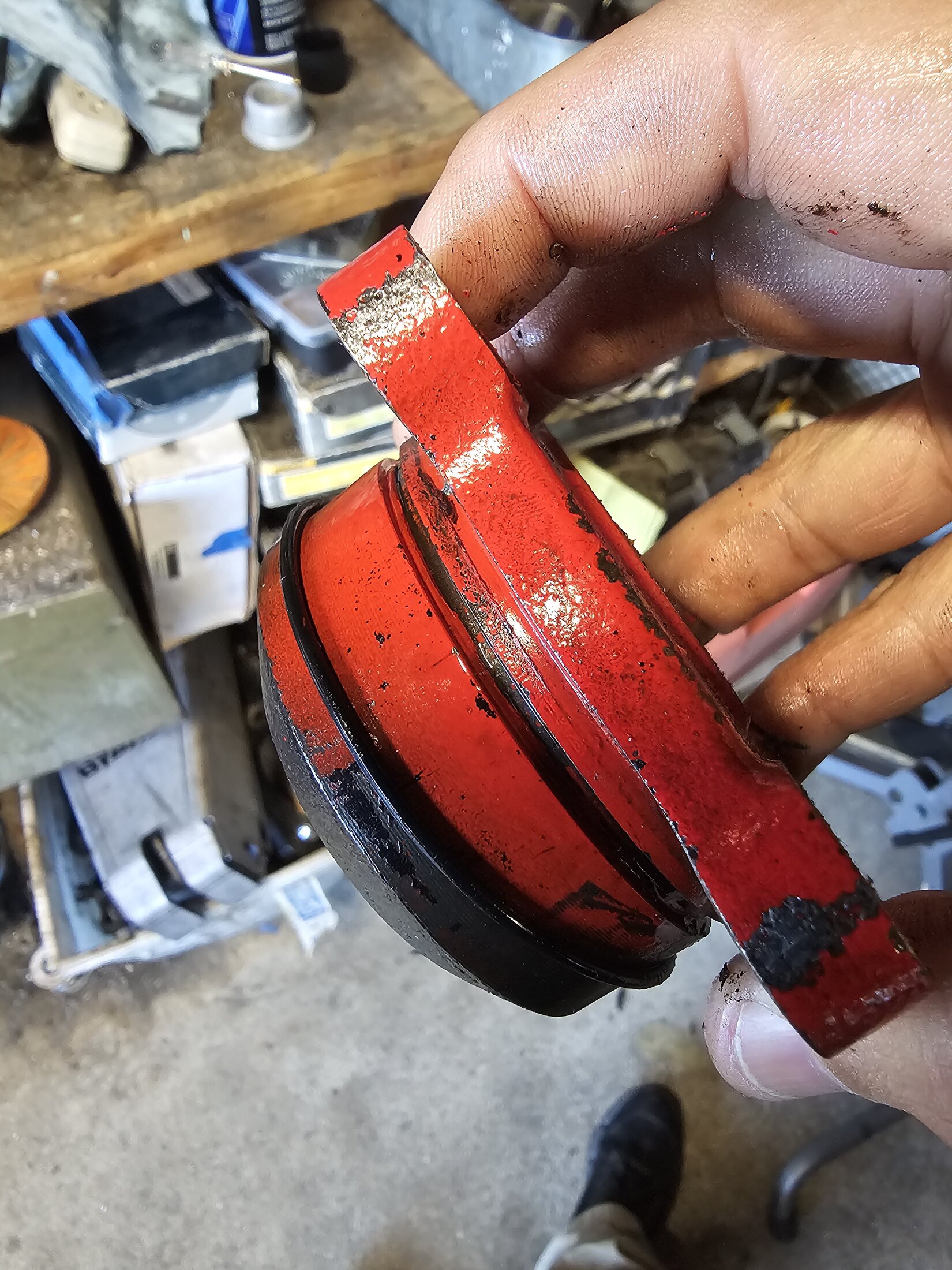

The redhead boxes I have seen have paint all over mating surfaces. So I am not impressed.
