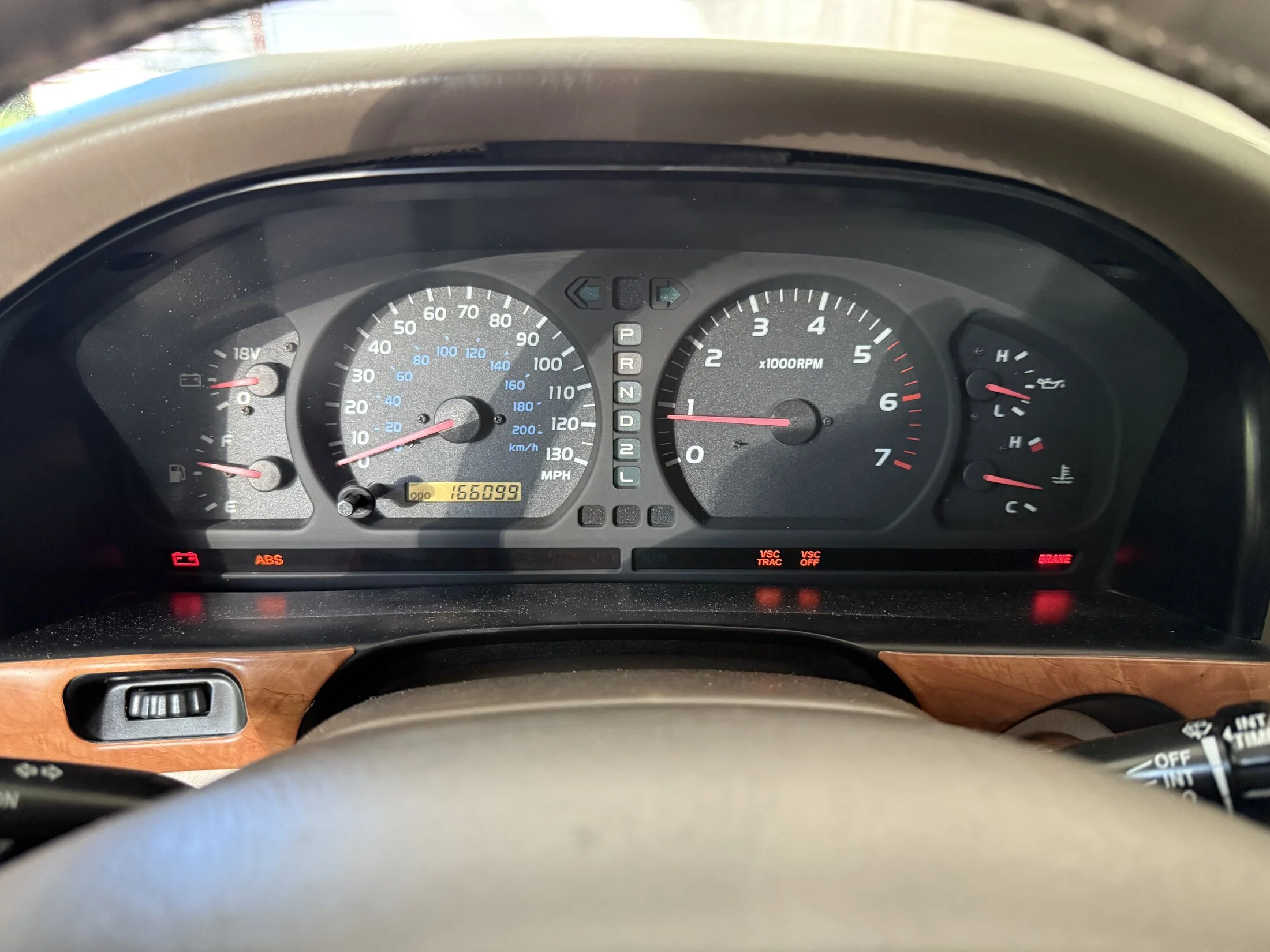

Decided to take it out yesterday and it wouldn’t start so I jumped it. It ran for a couple minutes before I took the cables off. Once I started driving it, I started to loose power on some things, starting with the radio, and the battery symbol started turning on and off. Came back home, checked the battery with my multimeter and was seeing ~10v, so I put the battery a charger this morning and the battery got up to 12.2v. Started up when I got home this afternoon, so I drove it and noticed the power loss was even more severe to the point I almost didn’t make it back home. Battery / ABS / VCS / Brake lights were all on.
