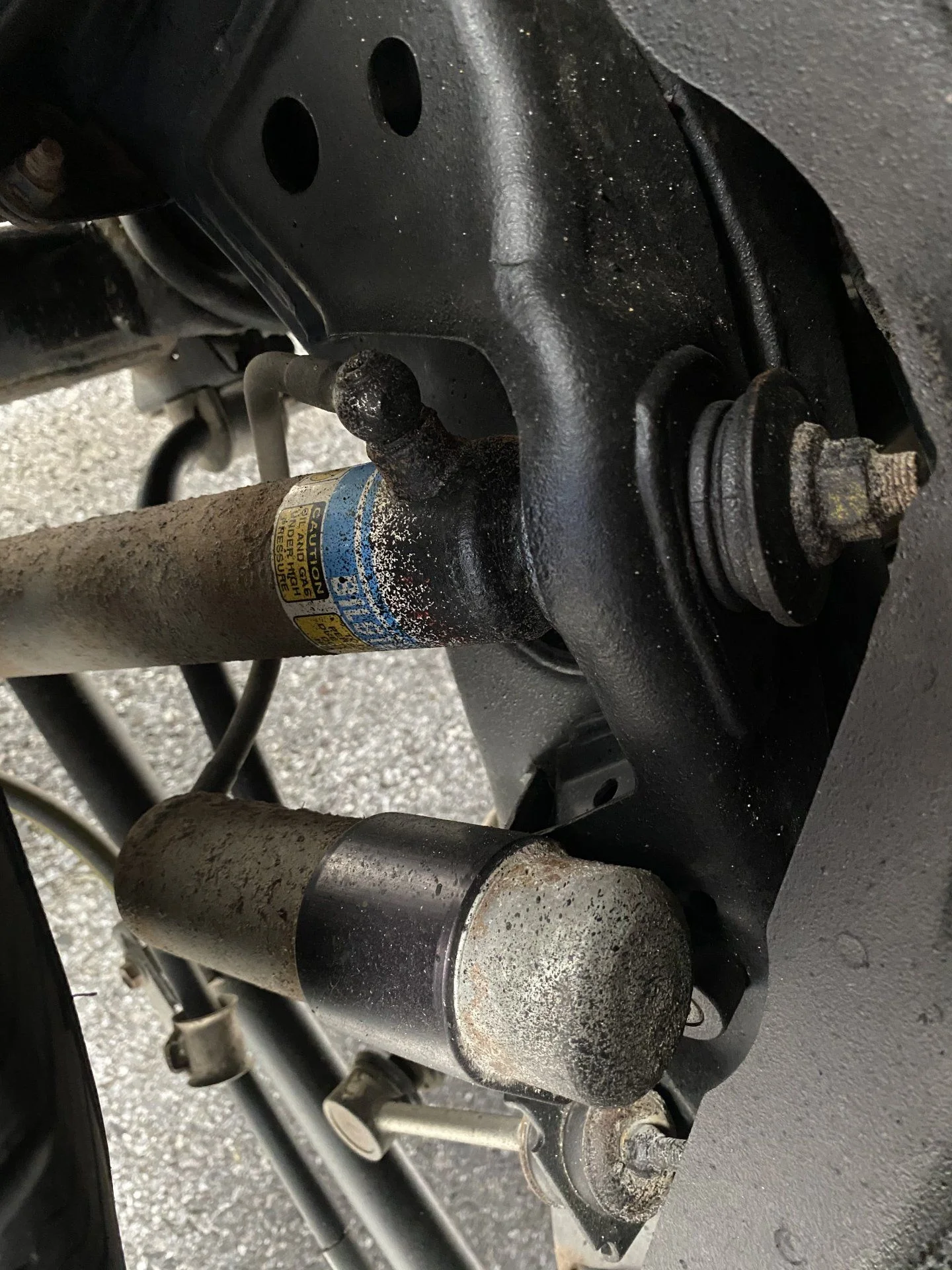

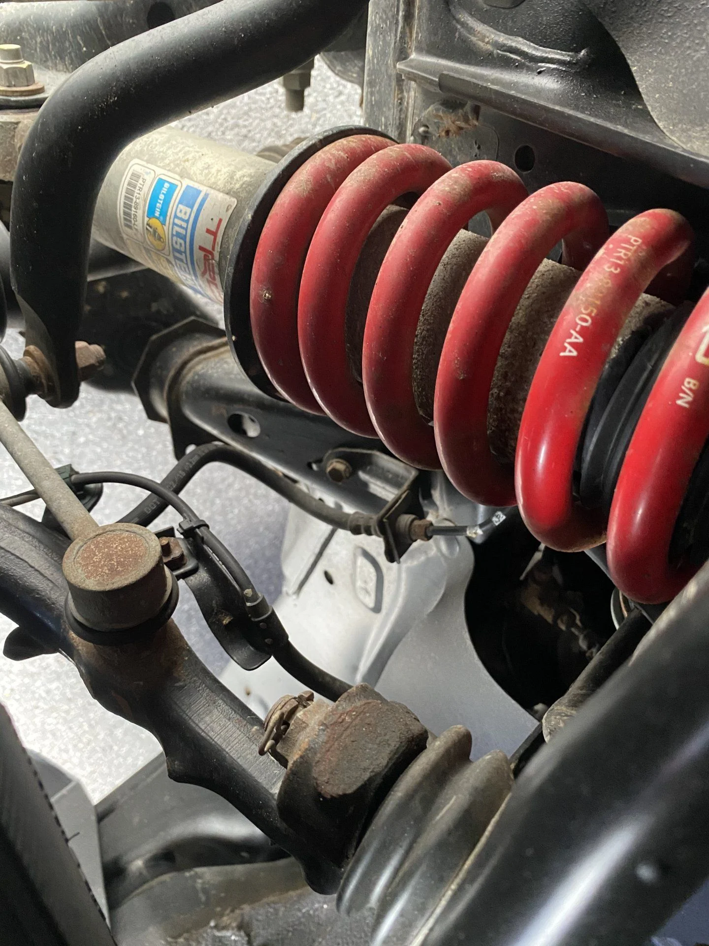

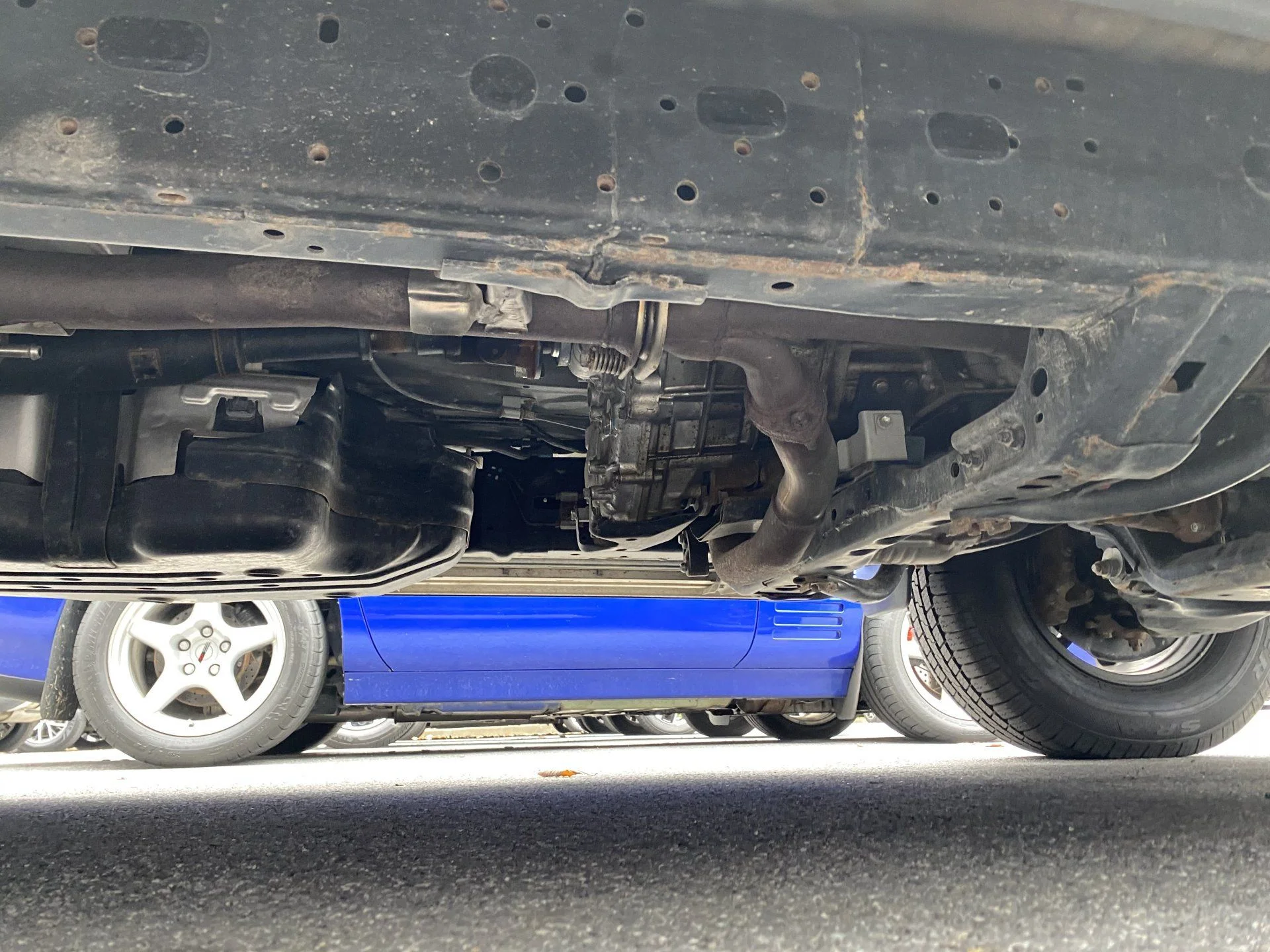

Found a 2016 4Runner Pro locally
58k miles
CPO by Toyota
Looks Stock and Rust Free
Curious how the suspension holds up at this mileage? Also the wheels had a weird weight setup. The wheel weights were double stacked... Tires hardly looked aggressive. New tires installed by dealership for CPO inspection
Anything I need to look out for? CPO or not, gonna be driving 25k miles a year and need a reliable rig.
That's not a rust free truck. You can see rust on on the rear axle shock mounts, frame threaded holes and frame welds. The rear axle has obviously been resprayed to make it seem "rust free". You can see the paint line right up to the level of the diff fill nut. Depending on where you live that could be considered a lot or a little rust. The shocks probably need to be changed out anyways. You're likely going to need to change since it looks like they replaced with street tires and new shocks so consider that in the price. How much are they asking for it?
$38,700. 58K miles
$38,700. 58K miles
Not a deal at all, I'd pass on it. And what's all that gunk on the rear bilstein? Road grime? Is it leaking? Paint overspray? Also what color is it? Unless it's Inferno (the special color for that year) I wouldn't even consider it.

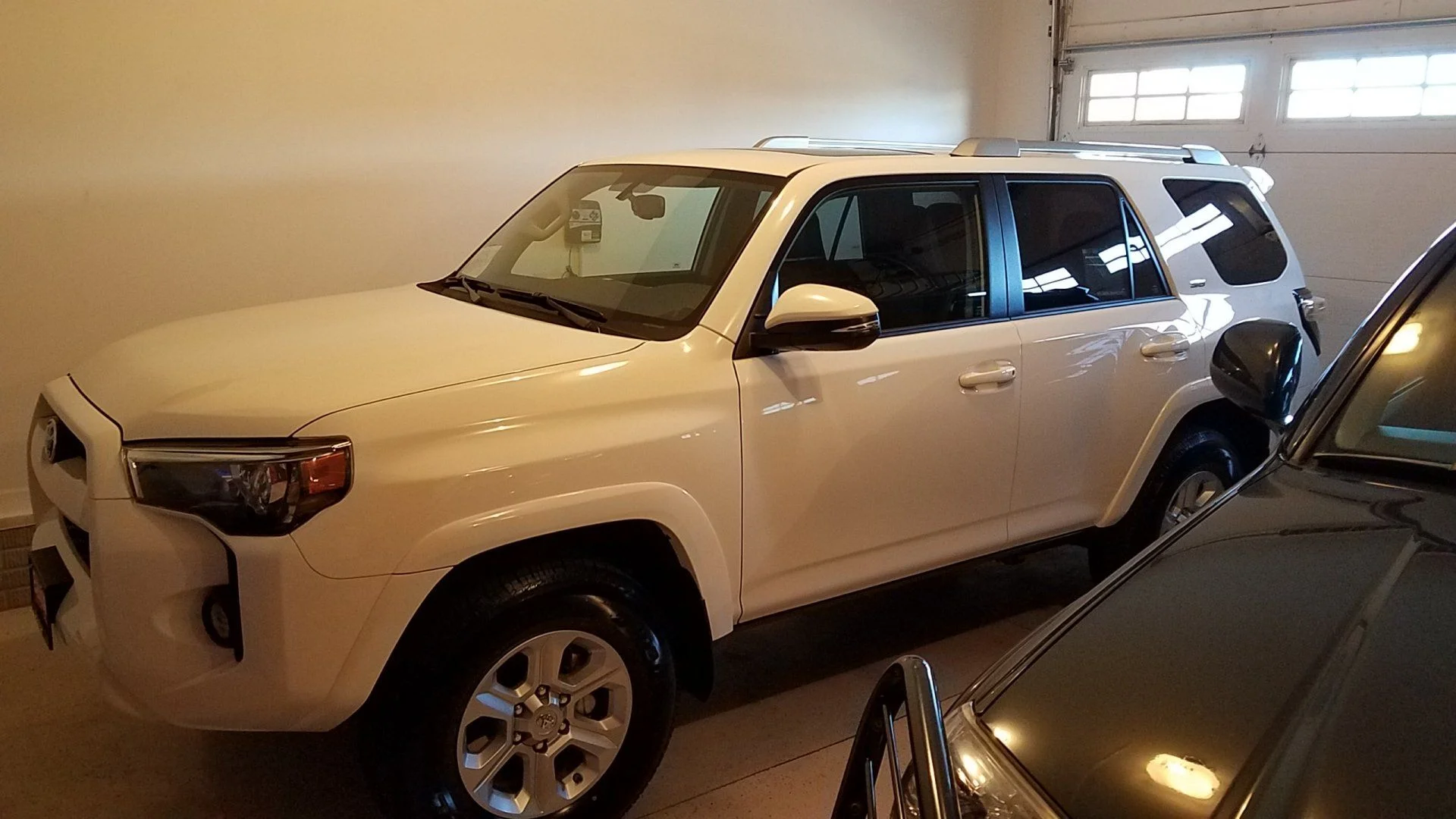

So the paint on the frame could be the "rust protection package" dealerships offer in midwest region. I say buy a new SR5 and build your own Pro. I bought my SR5 new for 35k and built what I wanted out of it.

Looks like an underbody treatment to me. I wouldn't worry about it. Go with your gut!

Obviously it's had some sort of undercoat sprayed on. Not my ideal choice, but probably not a deal breaker for me. What's odd is the picture I left in the quote. Something looks off about the frame where the shock mount is. Maybe it's just the lighting?
The early TRD Pro models have a pretty cheap suspension setup that's not worth much over any other model and probably a downgrade compared to a similar year Trail Edition with KDSS. It's a fine suspension - don't get me wrong. I'm sure it's a nice upgrade from the $50 Tokico shocks the other models come with. But really not in the same category as the newer TRD Pro fox internal bypass suspension. On that model it is basically the bilstein 6112/5160 combo on the older models but not height adjustable. Toyota used to sell that suspension kit for about $550. Not knowing the price - you could possibly find a similar year with KDSS. Or just buy a Trail Edition pre 2016 or TRD OR (new version of older Trail edition) - but not the new-new version of the "Trail edition" from 2020 forward that is now just an SR5 with accent trim. And then add your own suspension. I think you could pick up a similar condition 2015-16 Trail edition for around $30k. If that 4R is in the same price range - it's probably not a bad deal. If it's more like $40k - that'd be a hard no for me.

The earlier TRD pro just had boring Bilstein shocks upgraded over the standard OEM, it’s nothing fancy like the Fox suspensions on the newer models.
I think the Bilstein 5100s I had on my 2013 Trail lasted about 75,000 miles before they were destroyed completely.
