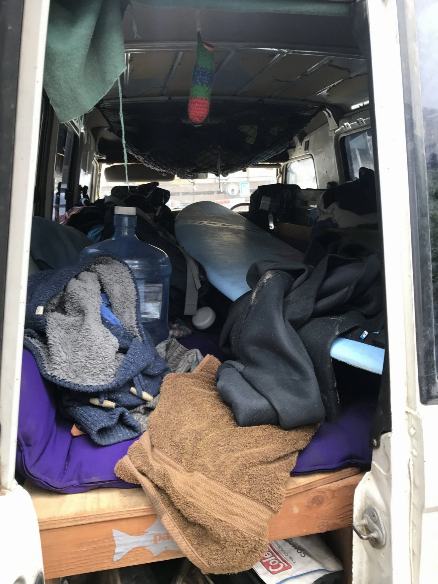

1. It was origanlly set up with the forward facing rear bench seat. If I purchased the side facing troopy seats are there already partitions to simply bolt the seats in? Or do I have to fab up mounting brackets? It's been converted to camp in the back so I couldn't see the interior walls to confirm.

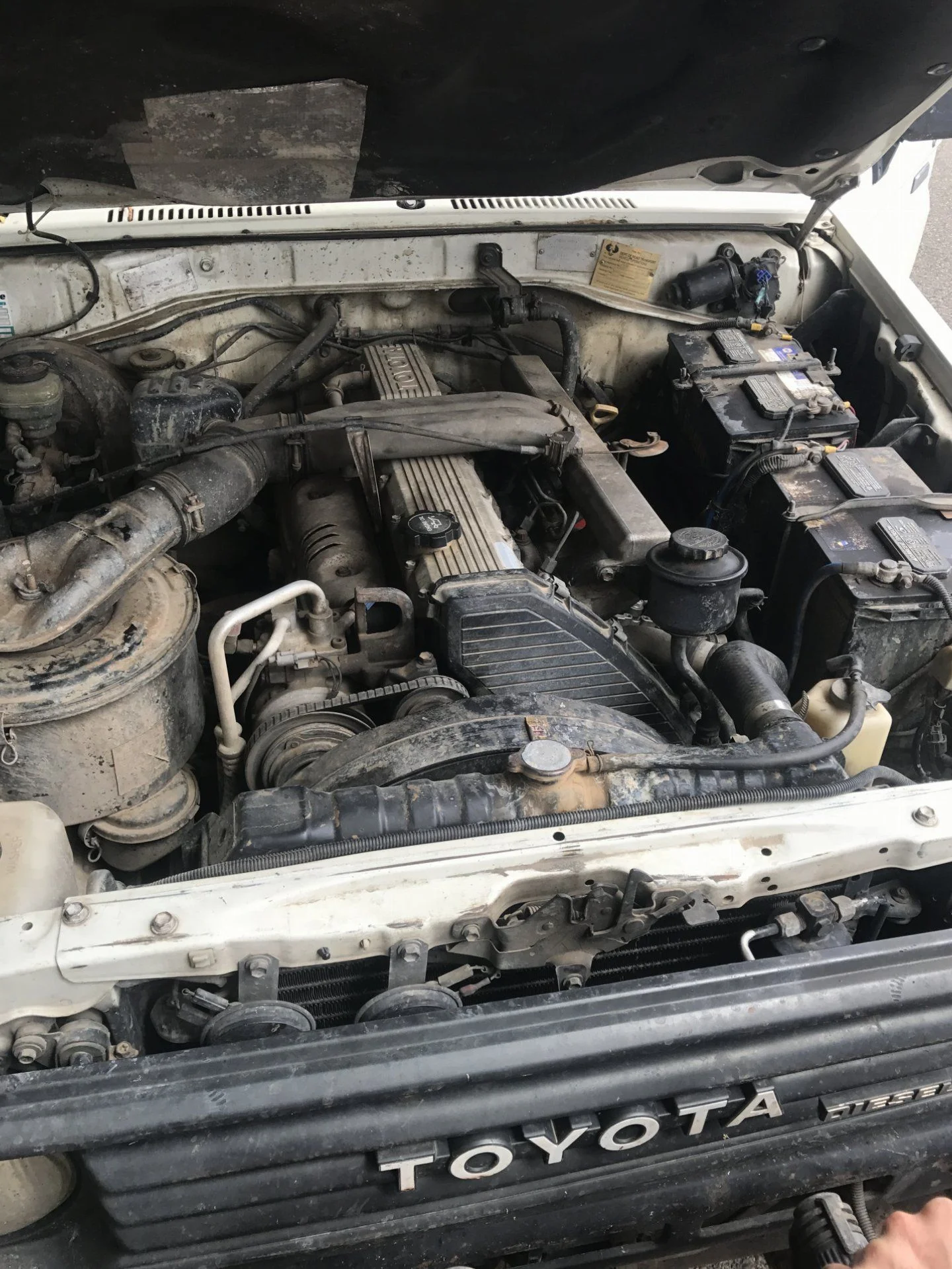

No turbo so the engine is probably healthy.

Rear seats....it depends on how the Troopy was originally sold/ optioned. I would be prepared to make brackets.

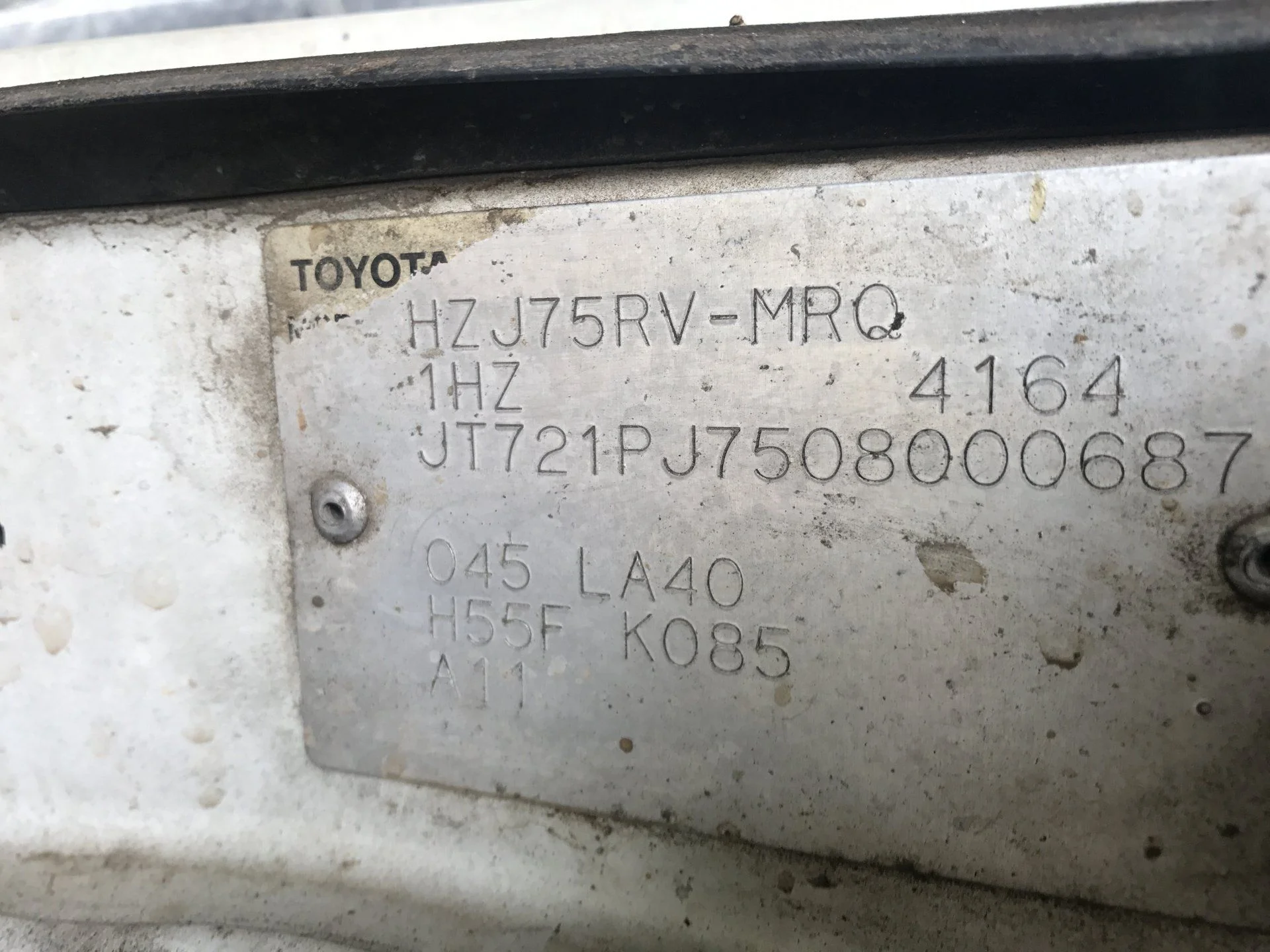

Tranny.....that Troopy has the good one I wish I had. Based on the data plate it was delivered with an H55.

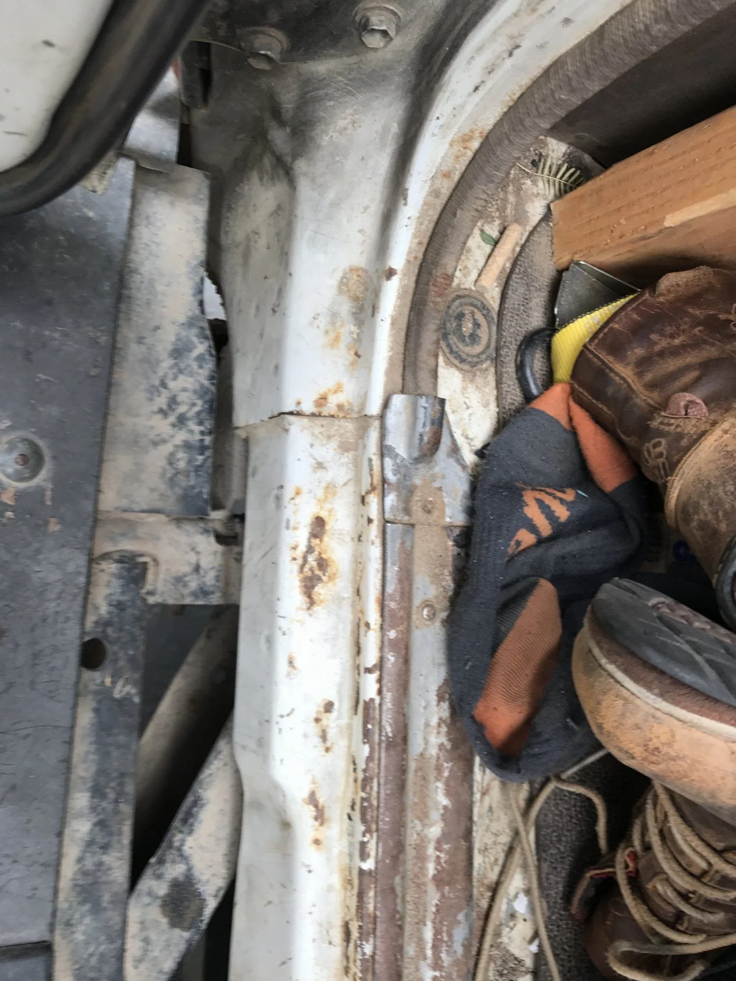

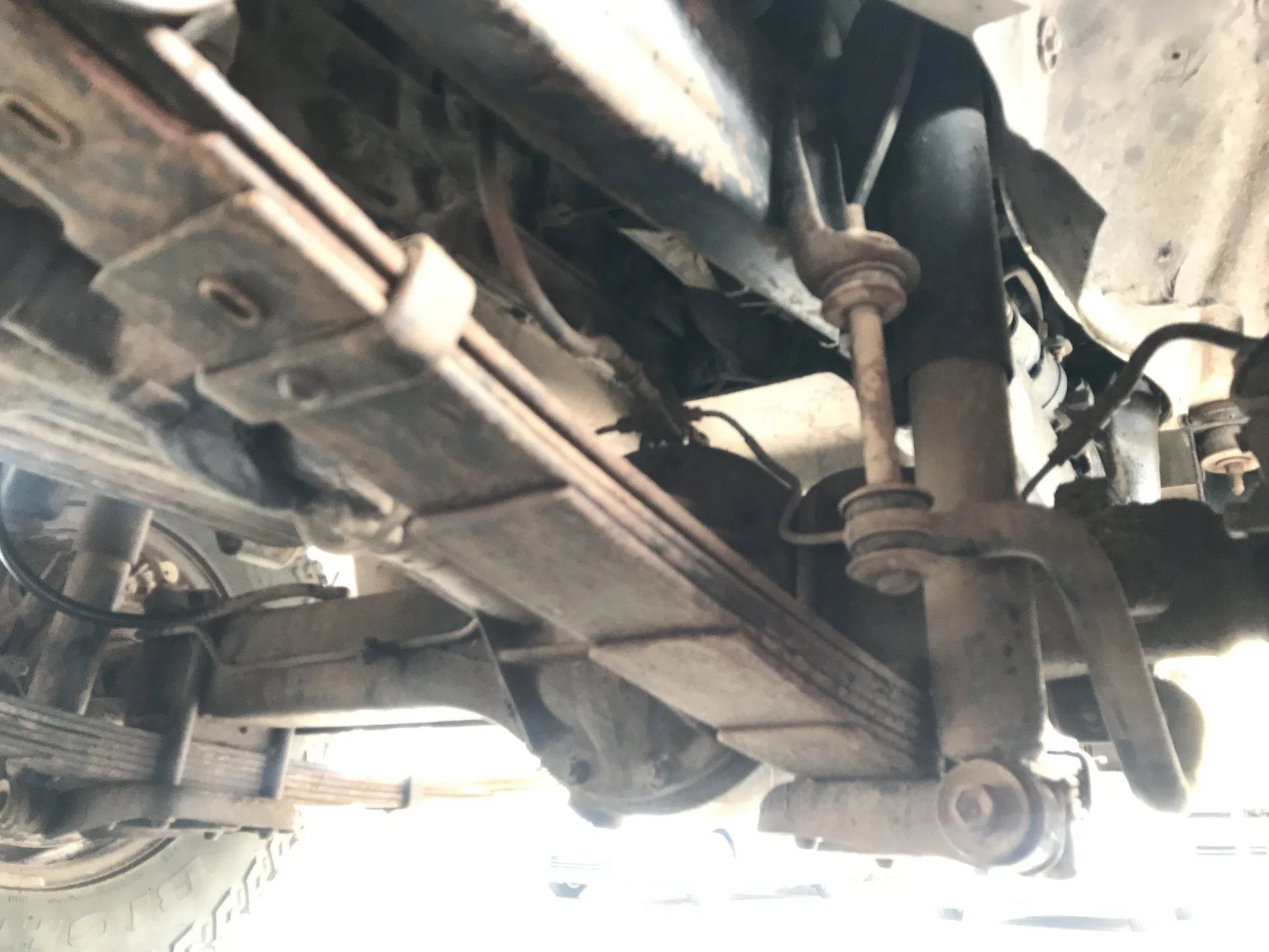

Ditto on the rear sill and quarter rust. Take out the rear lamp assemblies to see how much metal needs replacing. You WILL have to tackle some rust but it looks in decent shape otherwise. Check compression on the 1HZ before committing. Check for excessive drivetrain noise or whine/rattle in the transfer case. Look at the coolant and for any leaks around the water pump. These are built like tanks and outside of bodywork, most issues are fairly obvious when poking around.

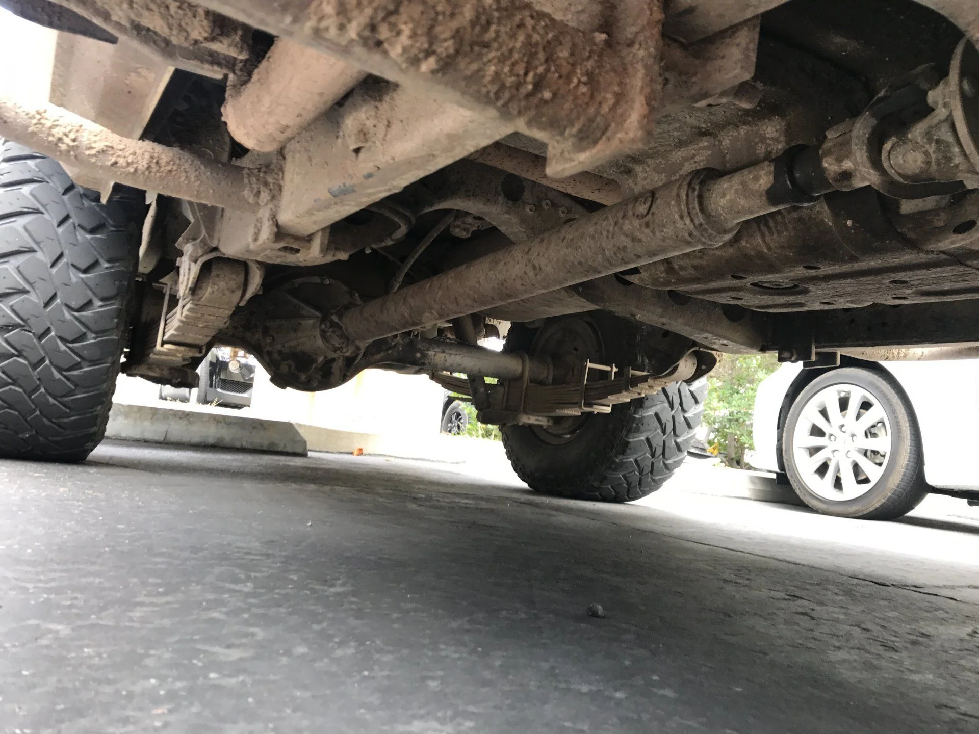

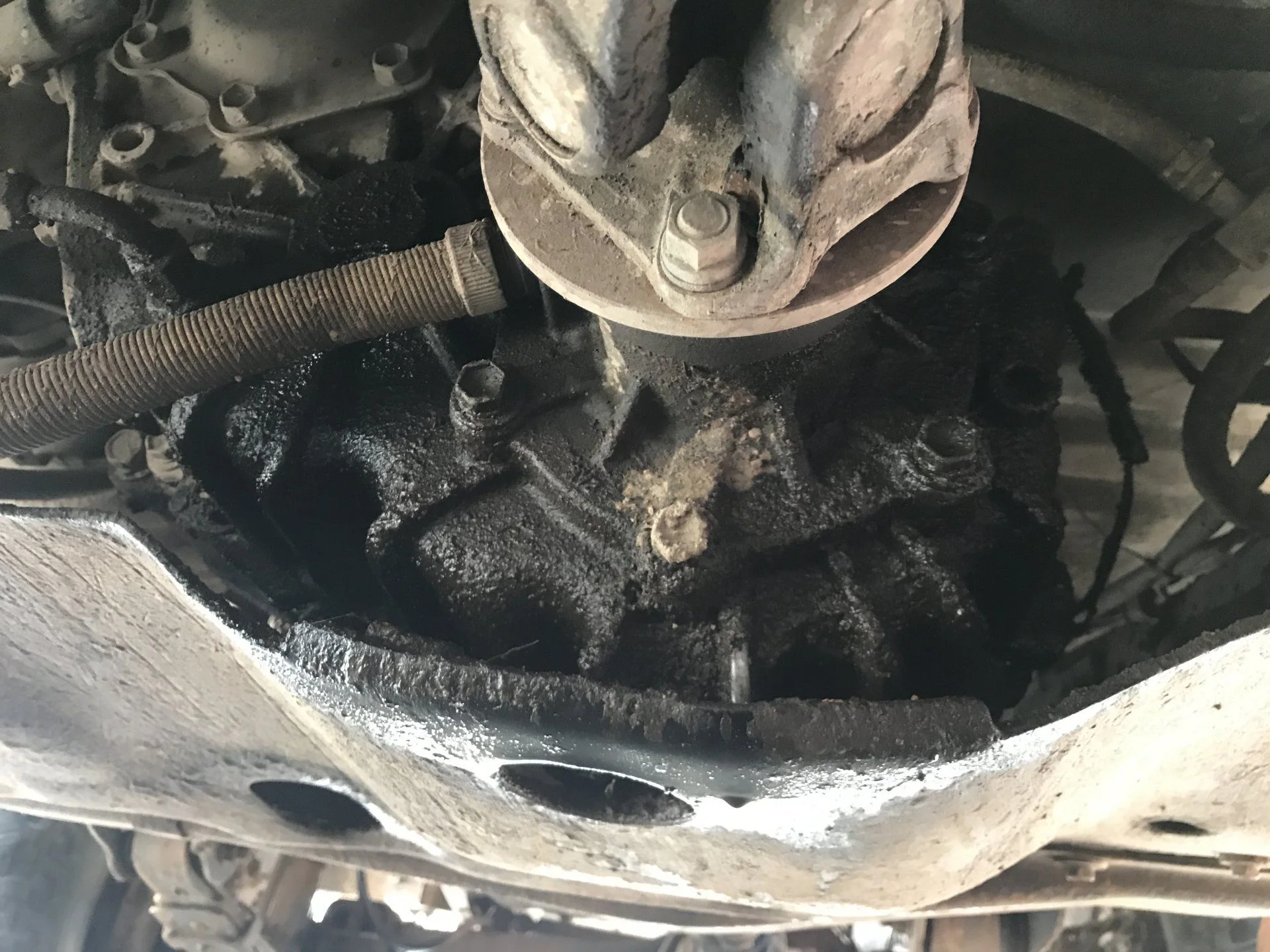

It is past the 25 year mark, so it can be registered in the US. I too would probably jump on that if I were in your shoes. I do see some oil leakage near the drive shaft in that image you posted, so that's clearly one area to dive into post-purchase. Also unless the current owners have done the regular maintenance, I'd probably go through and replace most of anything rubber in the engine bay (belts, hoses, etc.) I'd switch to stainless brake lines if they're not there already, replace those shocks, clean the engine and undercarriage to check for any other leaks, and probably redo the wheel bearings/repack hubs if they haven't been done recently. That's a fair bit of work unless you do it yourself, but that would get you a reliable Troopy that would go for another long while.

It has the H55F, which is a good thing. Spares are easier to get for this transmission in North America. On the other hand, it is more robust than the R151F that equipped later units.
The H55F slips gears in old age. Check it.
The transmission and transfer do not show oil leaks, nor the universal joints.

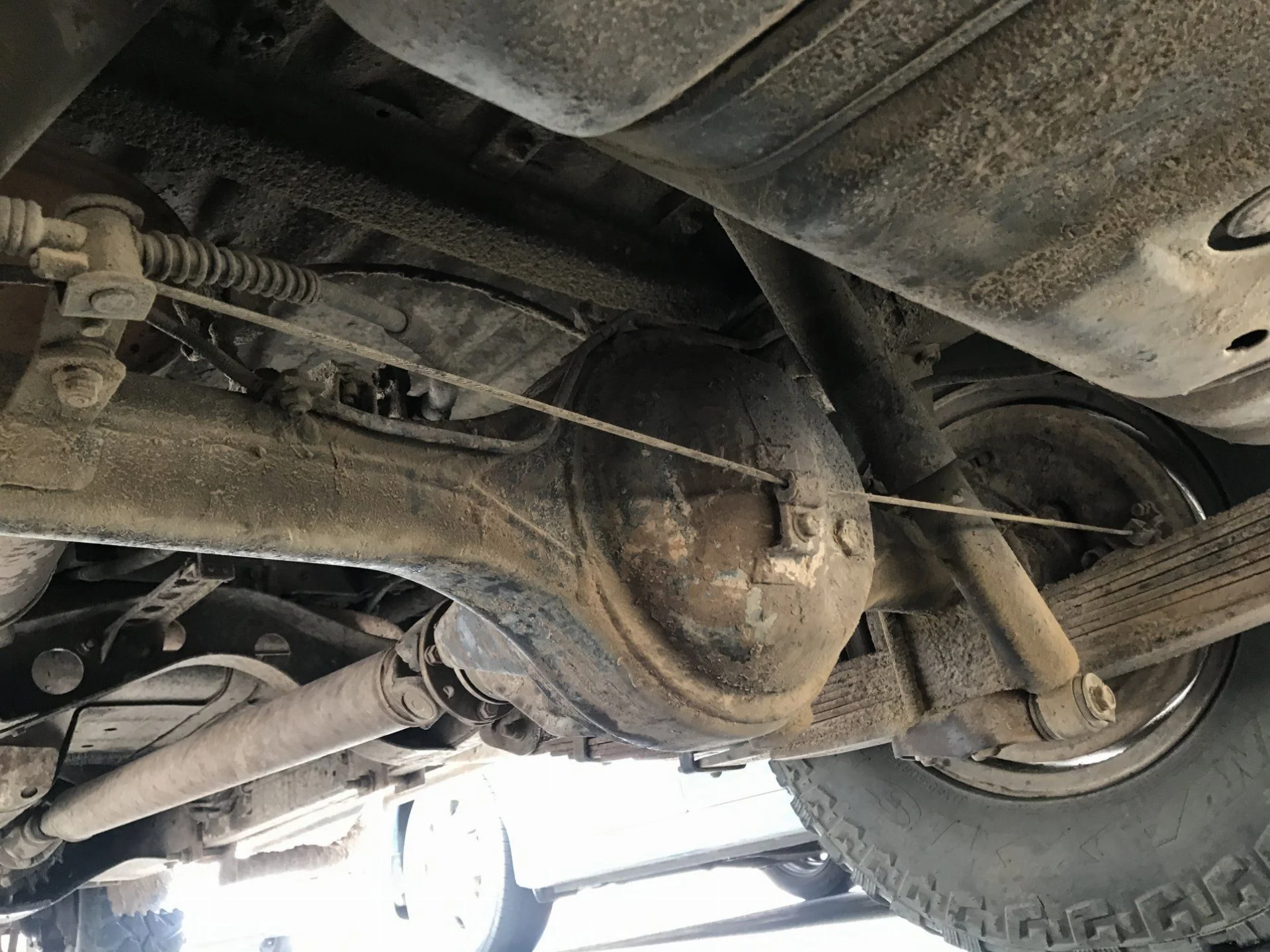

K085 suggests a limited slip differential in the rear axle. You should check that with the current owner.
There is rust in the usual spots, nothing to worry.

The forward facing rear seat option is uncommon. I think its the best option to have as it comes close to making the troopy car like when needed. Side facing seats are not kind in frontal impacts.
The front passenger seat should also fold forward and swivel to allow rear passengers to enter/exit.

Was limited slip an option? Any downfall if it does?
It was a factory option. They are great until the clutches wear out at which point it just becomes an 'open' diff. They take a specific LSD diff oil. Only downfall is replacing it after it's worn as there are not easily procured e-locker assemblies for the larger rear diff. I'm replacing mine with a Harrop.
Yeah , that sounds like a great to do list.
It appears that the excessive oil leak is likely do to the seal between trans and transfer case. It looks like at one point it has one of the aftermarket bypass hoses that sends fluid from trans to transfer case so transfer case is fuller and seeping out of the o ring at top of transfer case. From what I could tell and what one of my mechanic buddies told me quickly... if anyone knows what I am taking about, let me know (I think specter sells them but don't even know what it's called). It looks worse than it actually is from the photo.

Water pump and timing belt should absolutely be the first on your to do list.
Double check for leaks around the injection pump, it should be an obvious leak out of the top or on the wheel well side.
Those bypass hoses work fine...as long as they aren't leaking.
