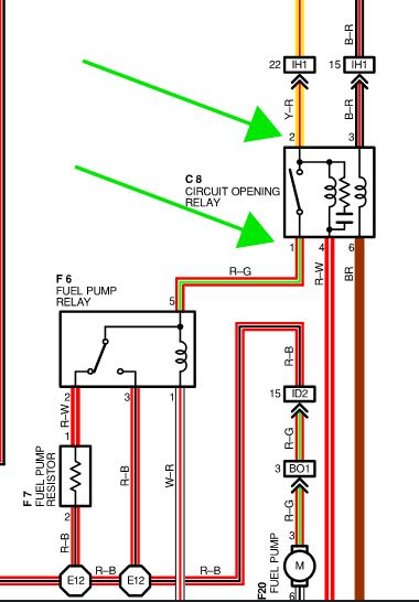

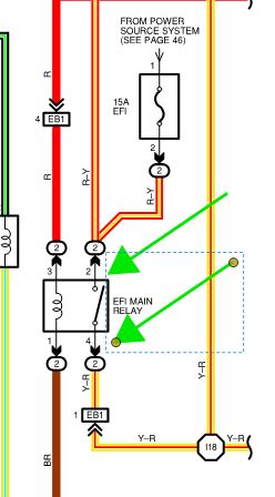

If that doesn't work then trace the EFI power circuit back from the FPR to the Open Circuit Relay. It's behind the dead pedal side panel, check your voltage at terminal 1 and terminal 2 when cranking If it's still low, then trace it back to the EFI main relay test terminals 4 and 2..
1) CoR
2) EFI
If the voltage is low at terminal 1 but not terminal 2 of the circuit opening relay then replace it. If the voltage is low at terminal 4 of the EFI relay but not at terminal 2 then replace it.

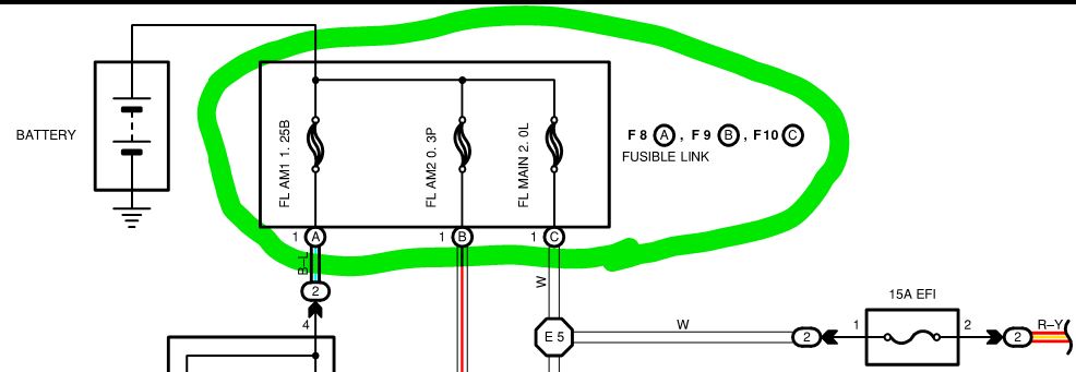

If both those are fine and your battery terminals have been cleaned recently then it's likely your fusible link.
