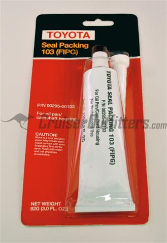

Just as an FYI your pan does not have a gasket, it uses what is known as a FIPG. You can buy a tube of it from your Toyota dealership.
OEMFIPGB
OEMFIPGO
Form-in-Place-Gasket (FIPG)
OEM Toyota# 103 - Black - 3.0oz (82g)
(Fits all year Land Cruisers, for use on oil pan, camshaft & water pump)
Part# OEMFIPGB - $14.50

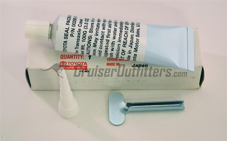

OEM Toyota# 1281 - Orange - 3.5oz (100g)
(Fits all year Land Cruisers, for use on axles, transmissions and t-cases)
Part#
