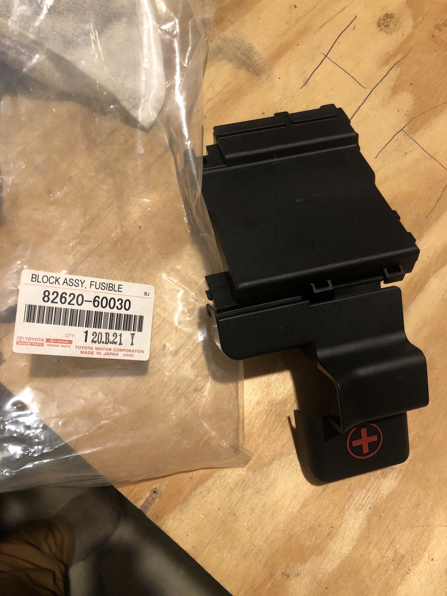

I never found a good one for mine either but just this week I received a new fusible link (82620-60030, less than $30) and it has the cover attached. My guess is that they’ve all broken off before we owned the trucks. Mine is a 2006LX though so yours may be different.

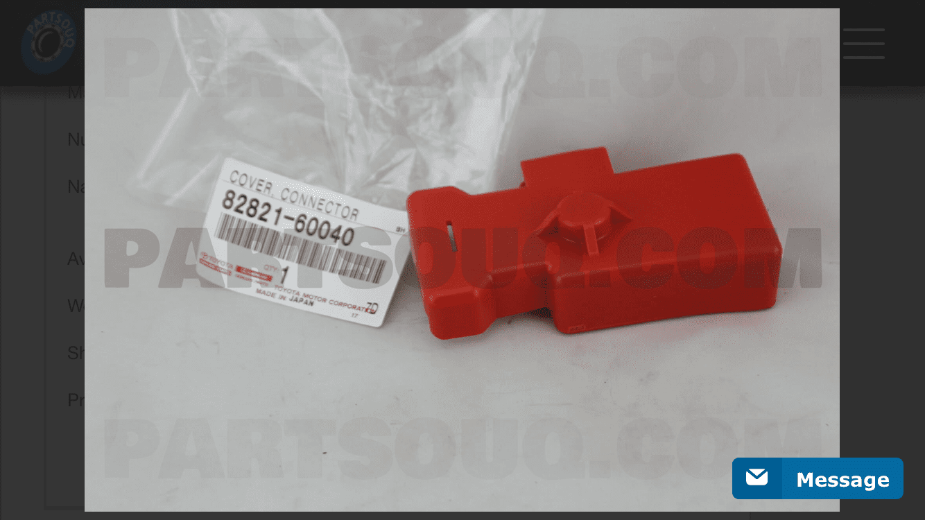

Exactly what I need, but it looks like the changed to that style in 2003.

PartSouq. $24.84 (plus $13.10 shipping). I’m pretty sure that’s my base shipping charge so I could have added it on to a bigger order without shipping going up much. The part weighs very little. Ordered last week on Tuesday evening, arrived Thursday.
