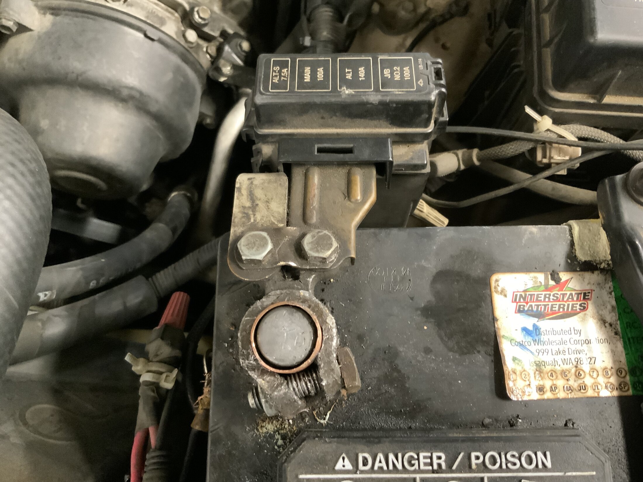

I need to replace the positive terminal
Mine is different from stock, not sure if it was replaced before.
Look like the two pieces can be stacked toghteher.
Any help would be appreciated

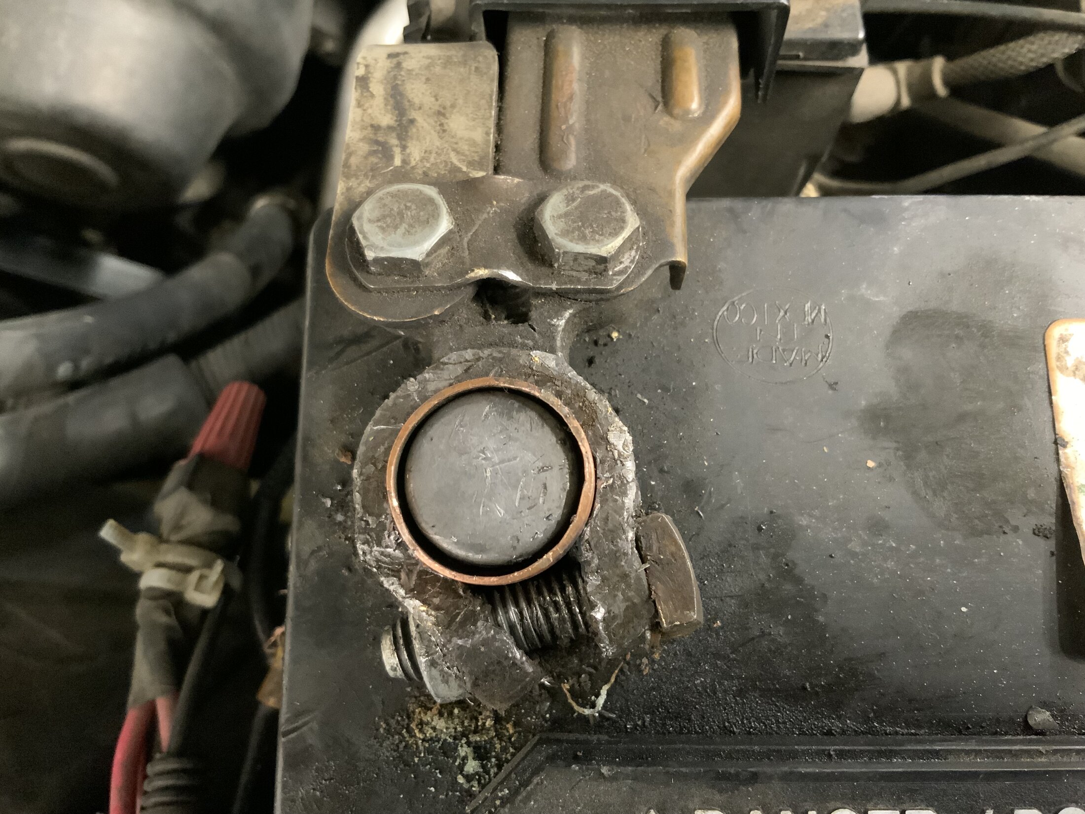

the OEM battery positive terminal is a one wire connection, mine has two.
Can the two wire connectors be combined into one?
Do they sell battery terminals with two connectors?
obviously not stock

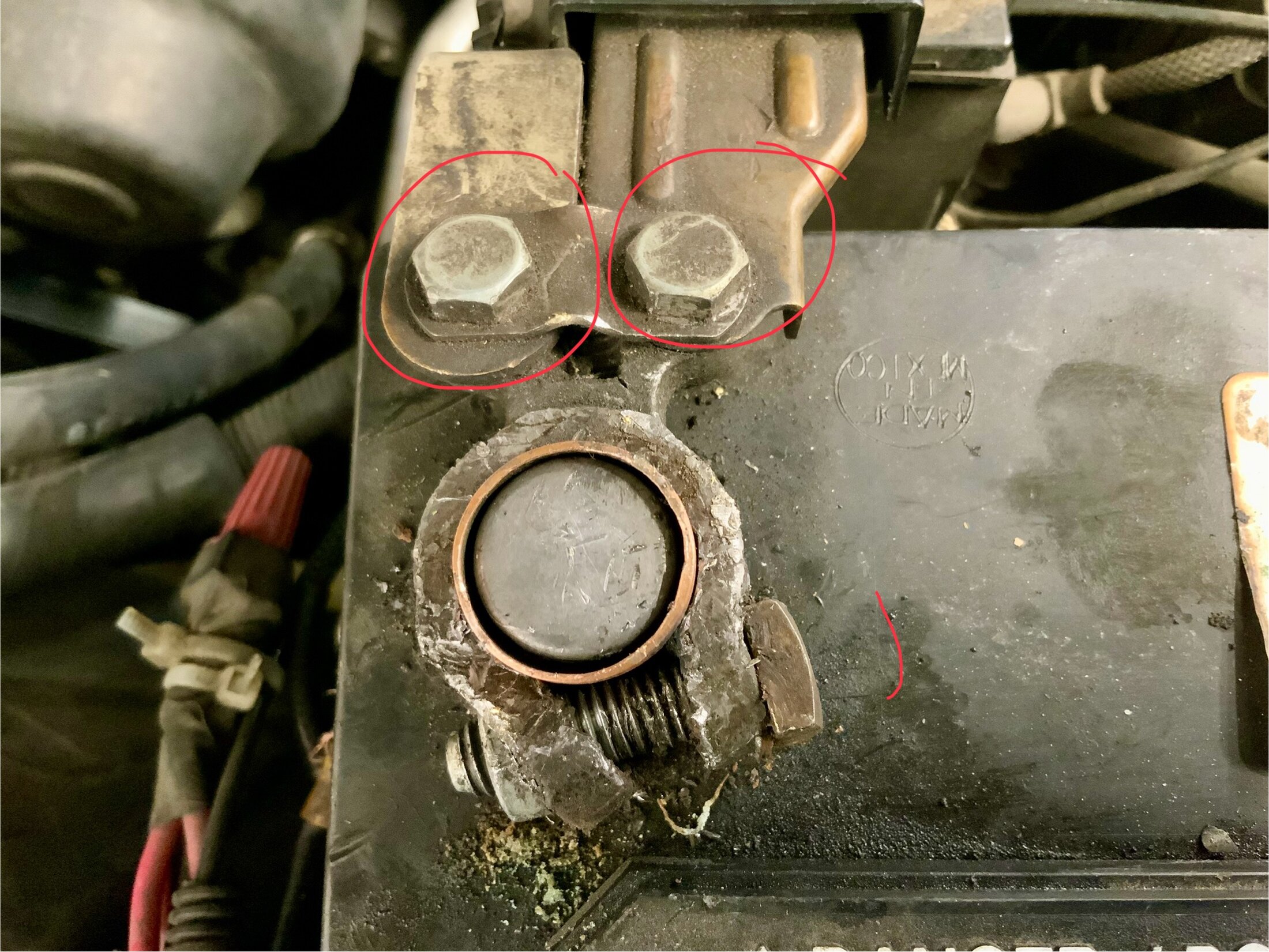

to get by, any auto parts house sells terminals just like that
that is what you have, when using them you would typically cut and strip the wire and put under the band clamp, you see a recess under and the clamp has a raised center for the wire. A PO used one of these and just used the 2 bolts on the band clamp to attach the wire lugs
auto parts store also has terminals with a post and wing nut

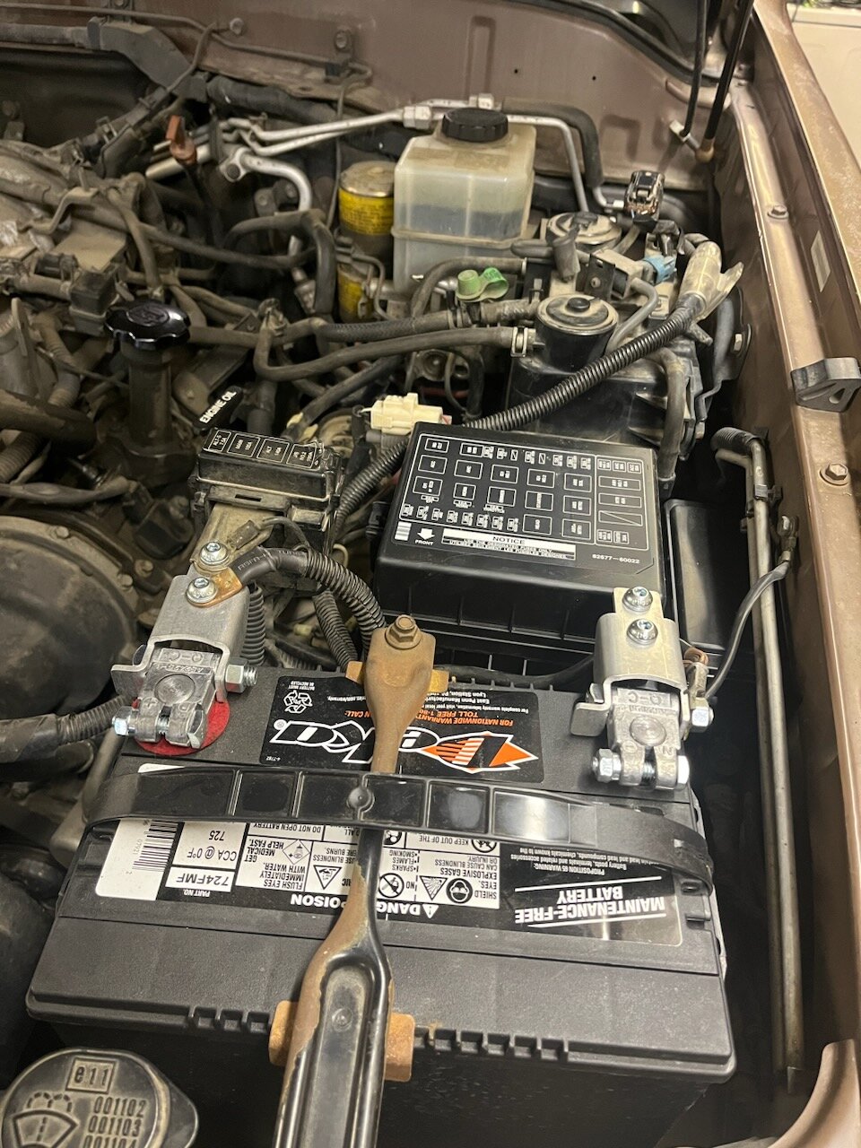

The OEM setup is as follows:
In your photo, the terminal on the left goes underneath the one on the right and the two get sandwiched together and then connect to an oem terminal with one bolt through the aligned holes in both pieces. The OEM terminal goes on the bottom of the assembly and the assembly bolt comes up thru from the bottom with the nut and washer going on top.
Mine isn't stock anymore but someone else could probably provide a pic of the oem setup.

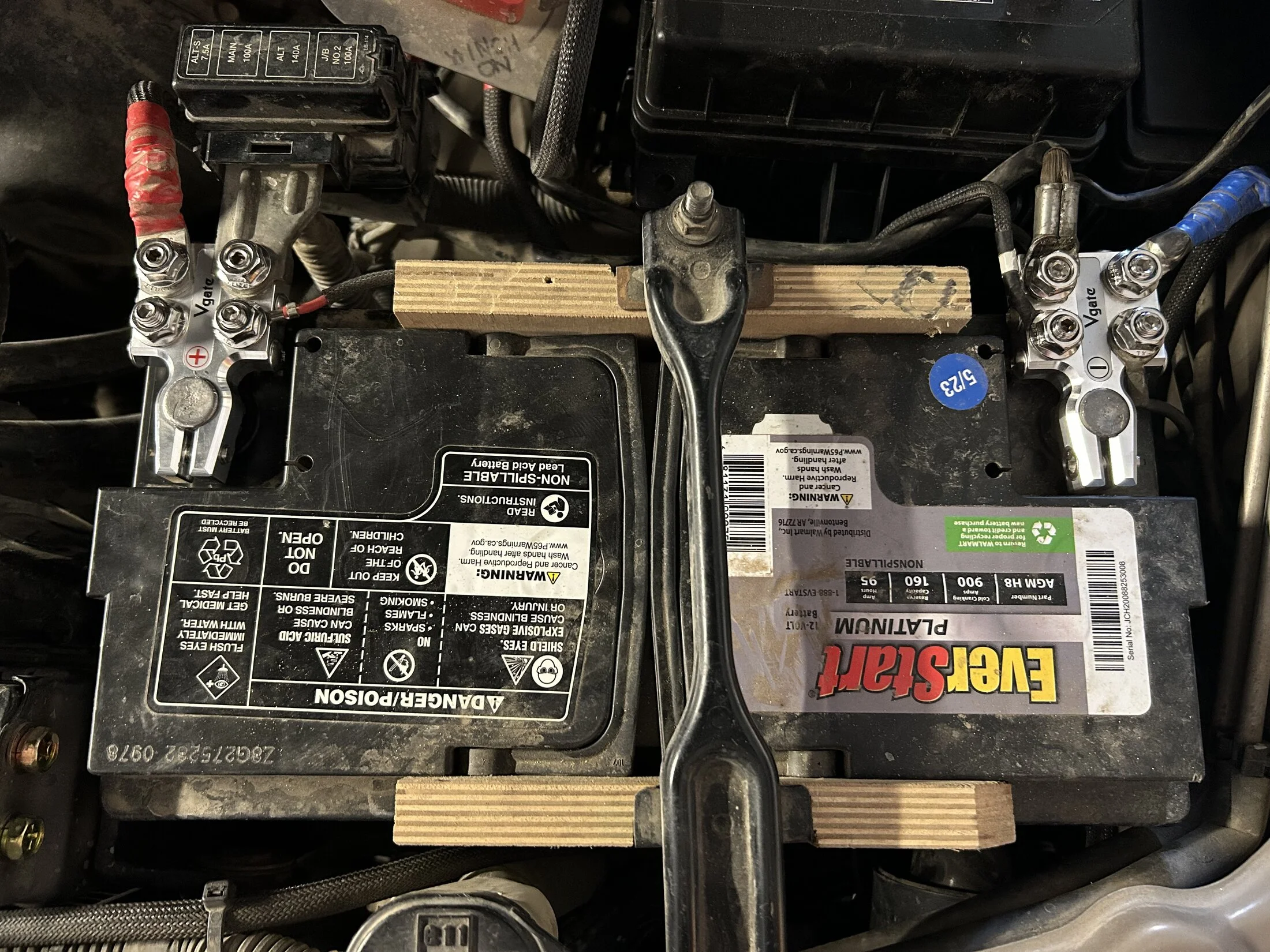

I switched (won’t call it an upgrade) to the VGate terminals from Amazon in order to fit more cabling. They seem solid. I had to cut an Allen wrench short though in order to be able to tighten the negative post. It lives in my truck now.
