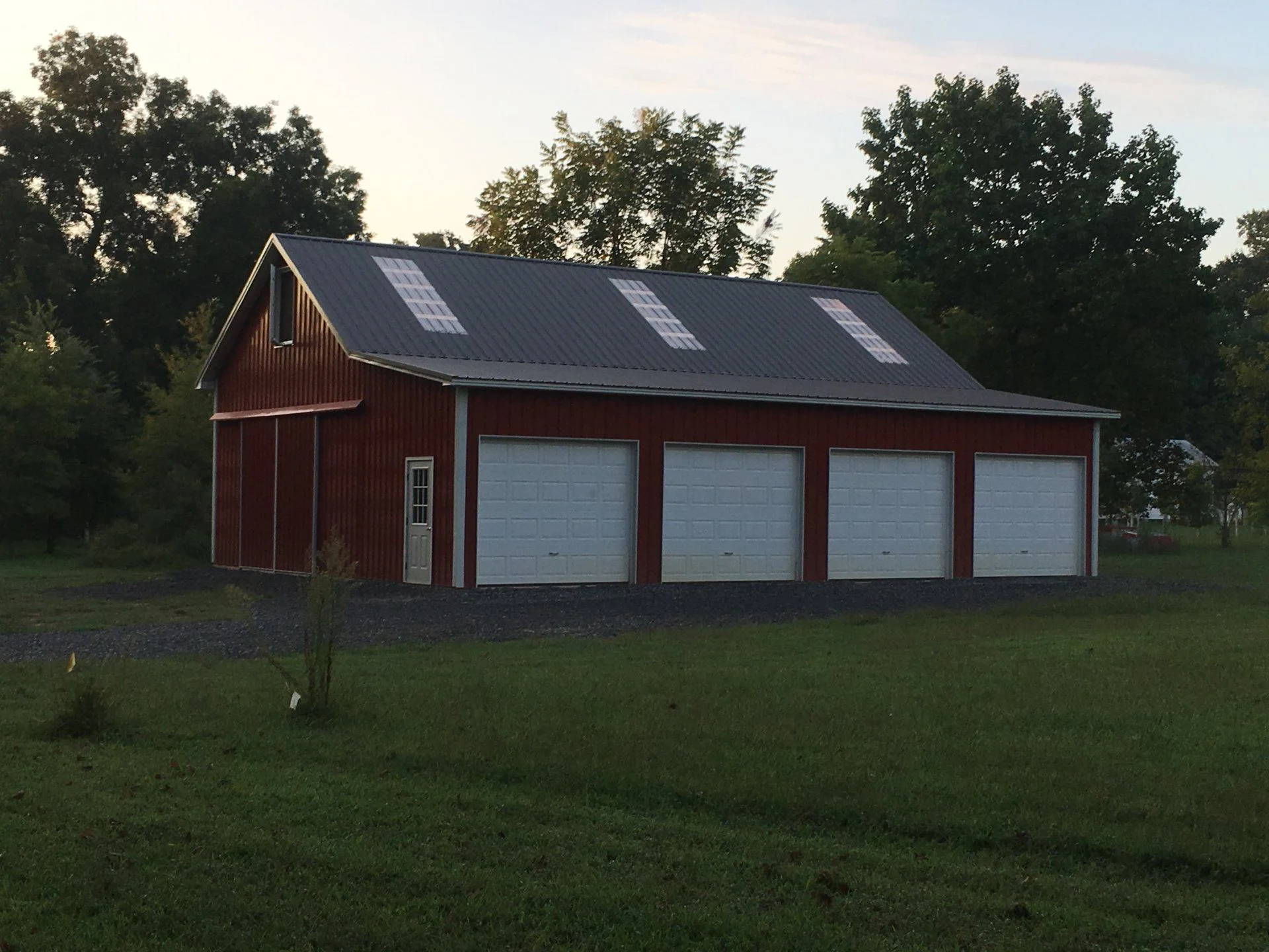

The picture below is my 36 x 48 barn. 12' ceiling in the center section, 10' in the 'leanto' section.
4 10' x 8' rollup doors
1 3' x 6'-8" man door
2 12 x 12 sliding doors ( this is a very bad Idea and will never do it again)
2 windows on each end and 2 along the back side.
R-7 insulation under the roof panels.
4" concrete
all prep work and permits.
$48,000
Good luck

Hi Bob, your barn/garage looks great! Thanks for the valuable information.
