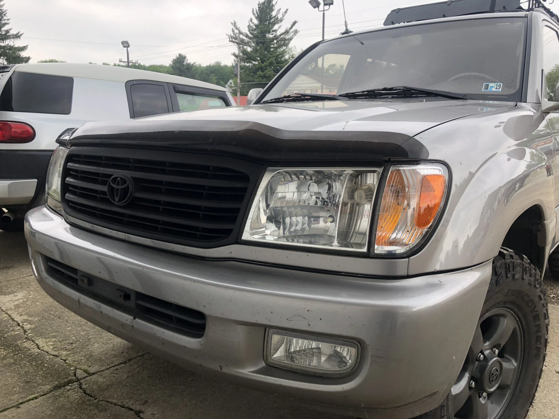

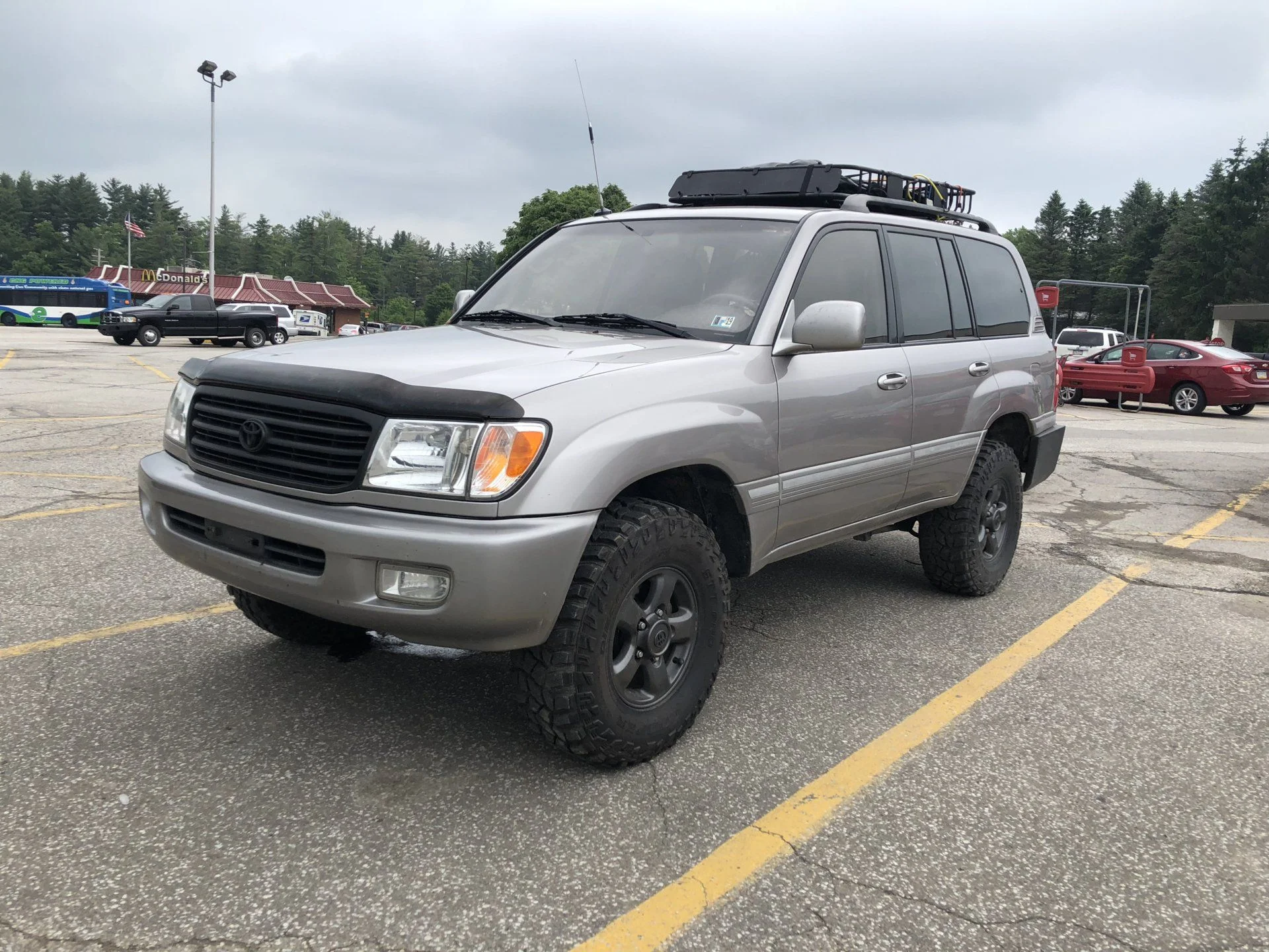

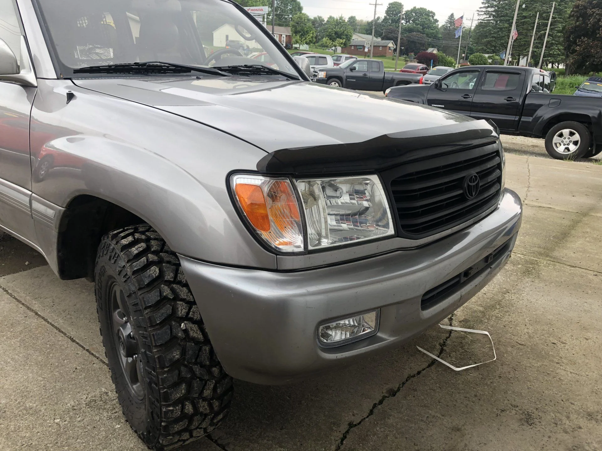

couldnt handle the chrome anymore
How long did it take you to do that? Looks good
Super easy: Open hood, remove three screws at grille top, release two clips at grill bottom, grills lifts right out.
Take off the emblem if you want (three more screws), clean off dust, and paint. Use many many light coats of Plasti Dip. Warm the cans in hot tap water before spraying for the best finish.

like 20 mins to paint it. I sprayed it with bug remover then a remove all degreaser let it dry then sprayed it on top of a garbage can. You kinda want to put it on in layers like mist it over and over and it kinda fills in everything. Best part is if you want the old look back the stuff just peels off
