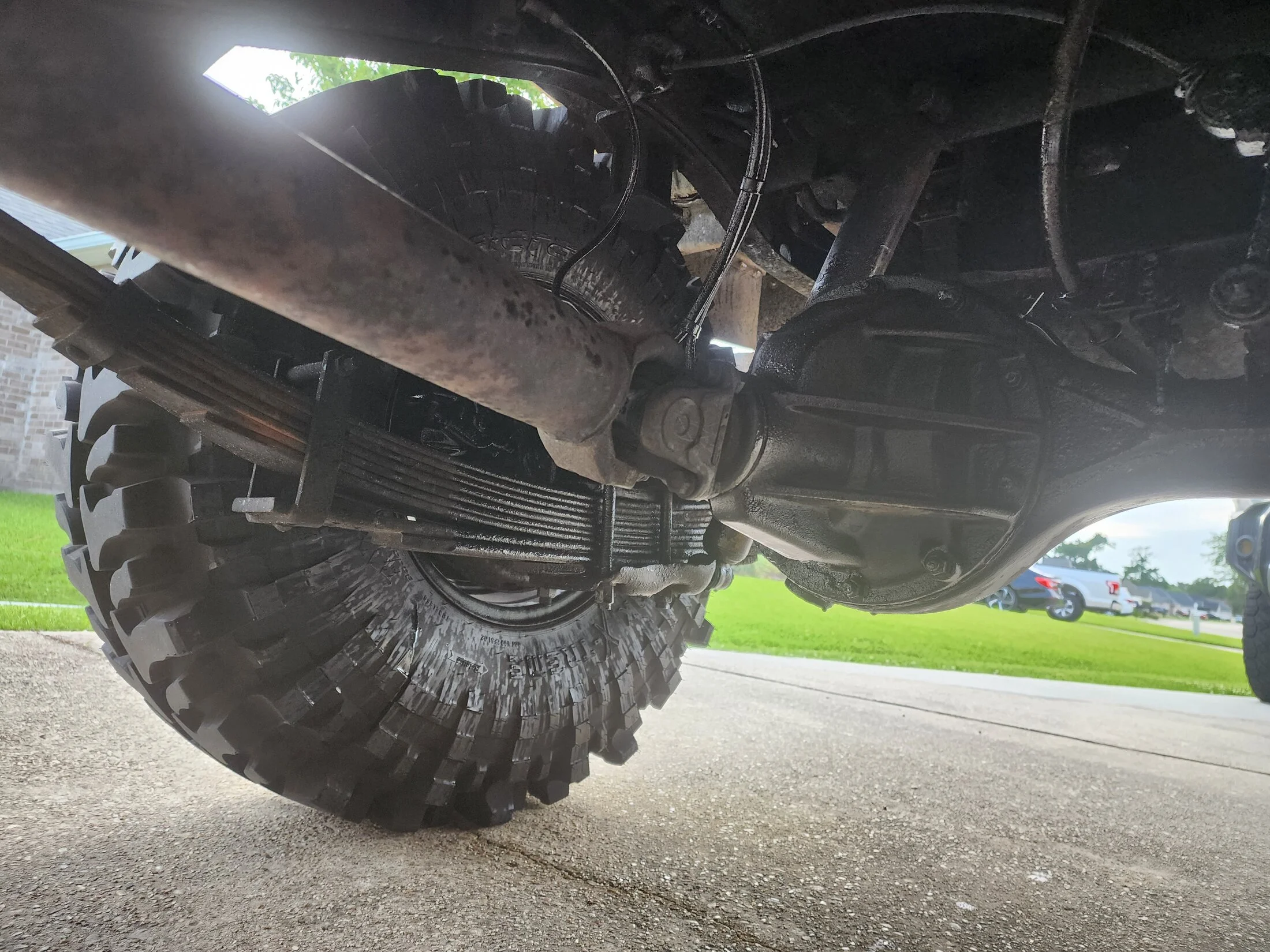

I hope to have a buddy help me pull this seal , but wonder what caused the seal to fail.. wondering if I need to order the bearings too while we're in there
I have a 16th of movement in all directions but in or out. It does make a but of noise when underway but think that's due to low diff fluid right now its slung all over the underside of the wheels ..thanks in advance .. Dave

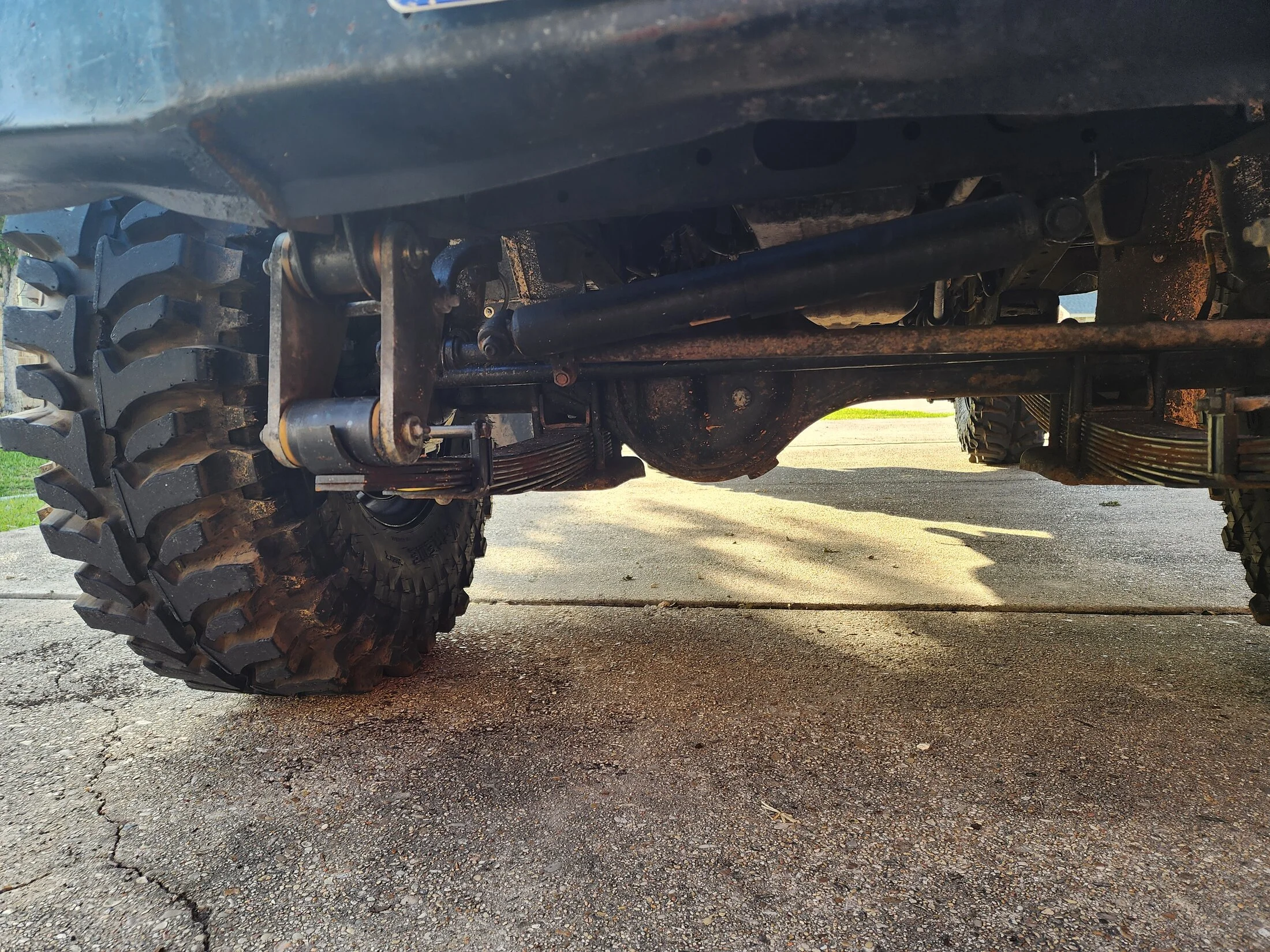

Pics of the truck and axles would help identify the axles. That and we all like pics…
The title is showing 82
Ill have pics of my pinion leak but I want to get better detailed pics of the extra brackets too .
The bracket for pinion brake is still there but no disk , the rears have the drum park brake brackets .
The axles are full.floated too and the bed was not original it was an UTE setup .
Ill take better pics to show body mounts and look for frame tag tonight

Looks like an axle seal leak to me not a pinion leak, most likely a clogged breather and leaking when it gets warm. Its a standard 9.5 cruiser diff, most likely not a solid pinion spacer so take that into acct when you swap the seal. Do your own research on this. Outer seal on a full float is often removed, at least that's what I do. Oil the bearings not grease. Im talking about the little seal that goes inside the spindle. Ymmv, Pull the stub shafts and replace the paper gasket and back seal on wheel bearings, insure wheel bearings are good properly tightened, lift up, see if there's up and down or side to side play. Adjust wheel bearings and adjust accordingly. Make sure mating surface for paper gasket is flat and clean, insure studs are tight and not pulled, make sure cone washers are installed. When you say "pinion brake" are you talking about bracket on back of transfer case? You might need to find a local cruiser specific shop to help you out. Your brake pads are saturated and need to be replaced also. Or clean your breather, give it a good decrease, fill diff, drive and see if the leak continues, replace rear pads after leak is fixed. Beware your brake ability is bad with saturated rear pads. Rear full float seal bearing kit should be very standard on 40/80 series. Call a cruiser vendor that knows what you have and can assist with correct parts. Might be a bent rear axle housing also. You will know when you put the rear shafts back in the diff.

I have info from previous owner that the wheel ends and axle bearings are all replaced less than 2100.miles ago . Pictures were sent , but I will follow the instructions to check the back of wheel bearings and paper seals
Guess what he did at that time ? He routed the vents to a higher point within the engine bay and I suspect its kinked where its tied off with zip tie.

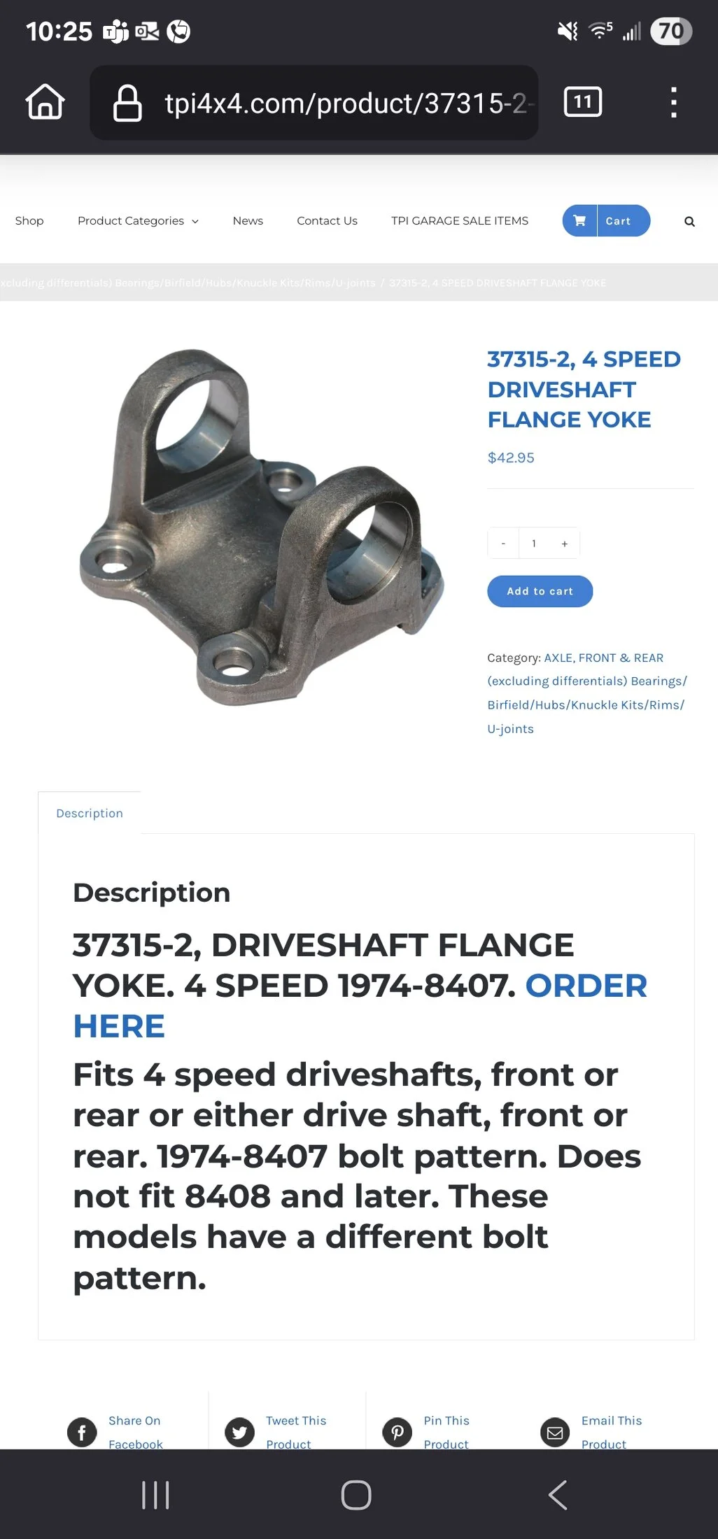

I had it in hand and replaced it. I aint playing. I bought parts for all the things like that as soon as I decided to buy.. I have belts and bearings sealed in bags.. What I dont have is that stinking pinion yoke .. lol TPI is not in today and I left a vm. I cant find the dems to verify anyone has another that is the same..
If it hasn’t been modified, the yokes are the same from 74-84. You can use the bolt pattern chart Kurt posted on his website to see if yours is still the original size.
Thanks , I went looking on the store front and couldn't find his original copy . I went digging and found this picture and then this one too. No years on the listing so many others use web based pics over and over without paying attention to details . I feel its the same one in the pic but if its the right one really. I wont know for a few days

It was the pinion seal the nut had backed off and was finger tight . The axle guts were fine and not leaking and intact . They were less than 2500 miles new but as anything goes if I didn't do it, I had to check as someone suggested . I did go ahead and verify the paper gasket too .
