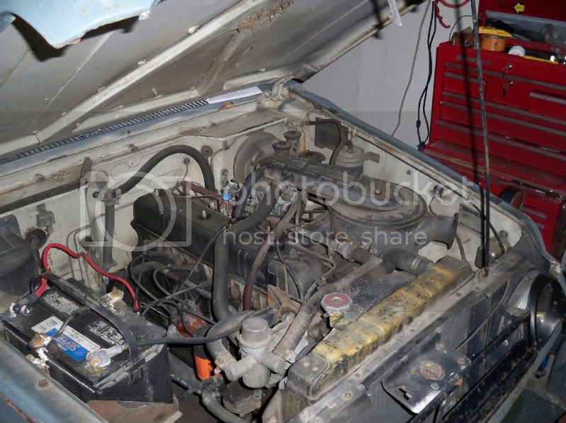

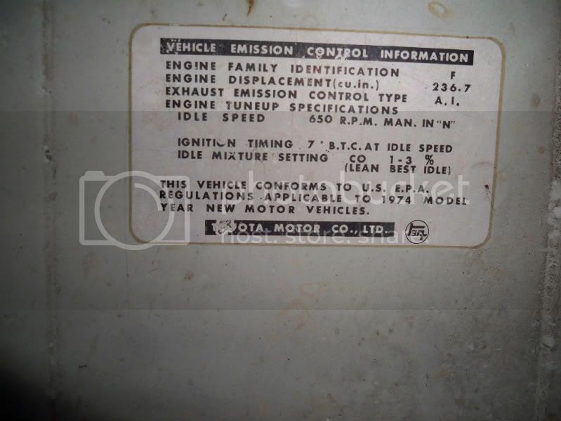

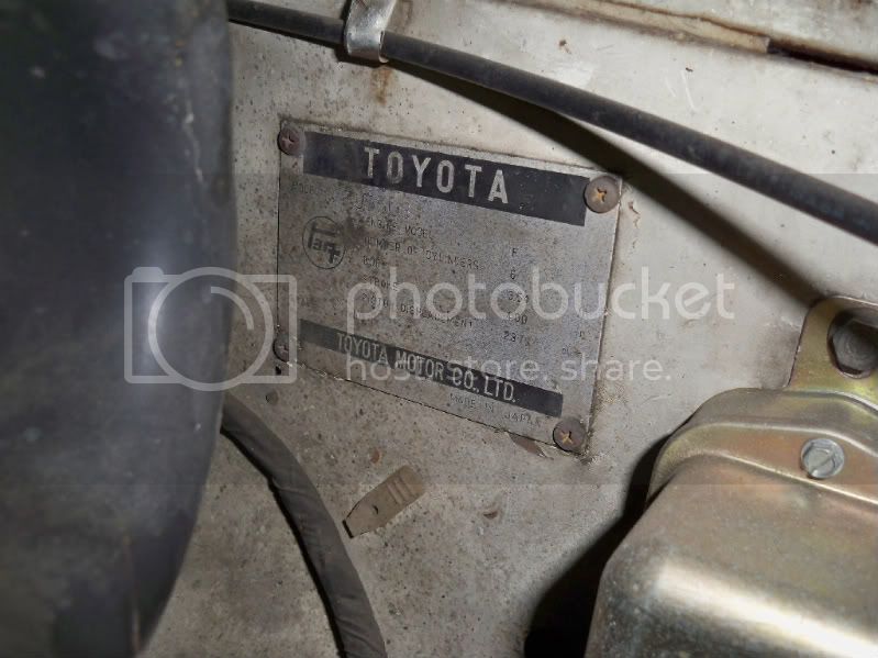

1974 is the year of survivor Pigs. Stock would have had the 1.5F, not the 2F.
Did someone transplant a 2F in there? If so, I would stick to that w/ a 4 spd...
PS: Where in CO are you?
Castle Rock ~ 30 miles south of Denver.
Good point - I thought the 2F came on the '74. I'll check this evening. I suspect it is stock. How's the 1.5F?

The 1.5F is good! Check normal maintenance things like filters and timing. If she is still a dog, check compression...

Yes, they are pretty strong and can be beefed up with parts from Longfield. Check out Woody's rig. He has modified his axles so his work would give you a good basis for comparison if you decide to stick with the original axles. On the engine, the 1.5 f is characterized by a f designation and an oil filter on the right (passenger) side of the engine. You can find the engine serial number by looking for the flat on the engine just ahead of the starter. If the serial number starts with an F and the oil filter is where stated then you have a rare beast of a motor. It has all of the oiling improvements of a 2 f and the displacement of an f. Some consider it the best f series engine made.
The nameplate in the engine compartment said displacement was 236.7 in3, so 3.8 liter. The filter is on the passenger side, I do recall that. I'd be interested to hear how the smaller displacement F is the best of the bunch. It desperately needs a tune-up. I'll save judgement until I can devote some time to checking compression, gaskets, state of tune, etc.

Yeppers, sounds like you have an f 1.5. It is the best (plenty of debate on this subject) because it has the better oiling system of a 2f and smaller lighter pistons that are 4 rings versus 3 rings on a 2f. Thus it will not beat up the crank as much with heavier pistons. It also has the thicker wall of an f. The 4 ring piston will float and seal better in a worn engine.

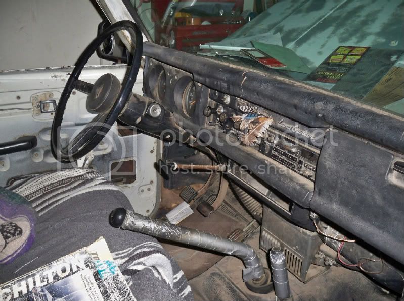

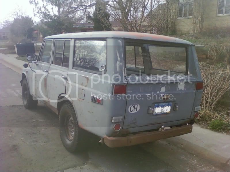

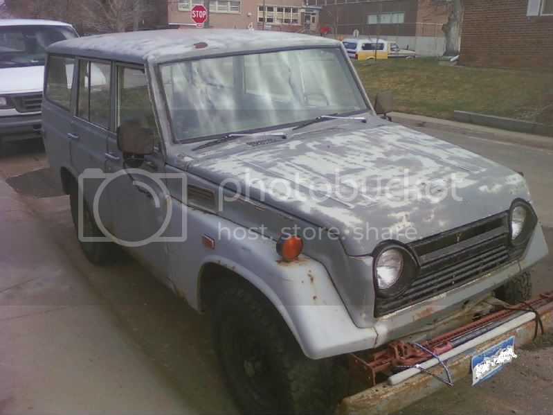

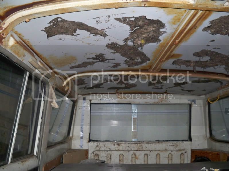

Well, Phase 1 will be to declutter the non-essential stuff (feathers and all :rolleyes: ) and to check the vitals of the engine. Here are some pics in the mean-time:
Roof Line not too shabby...
That's a Honda tape deck!?
