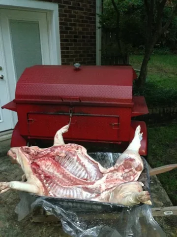

We are cooking a pig this Saturday and wanted to get some tips, hints, instructions etc.
The pig weights in at about 120 lbs and we need to eat around 5:30 or 6.

120lbs is about the same as what we had at LR. It really needs to be on and cooking by about 9AM for that schedule. Try and keep it around 250*-275*. Start it meat side down and cook it that way for 5-6 hours and then flip it. Salt the HELL out of it when you put it on the grill. Keep a thermometer in the deepest part of the ham or shoulder and try to get the meat north of 190*. Last thing, if anyone might want to eat any of the skin, I try to crank it pretty hot of 15 mins or so to crisp the skin.
HTH
Ramon
Yeah, last thing Andrew. I don't add much sauce while cooking it either, contrary to others' opinions, unless it's a real lean pig and want to get some extra moisture in there (I also crank up the butter in the sauce if that's the case).
One last tip, when you are pulling it, be sure to mix ham/shoulder/bacon/rib meat in each pan - IOW, don't pull one area of the pig and put it in a single pan. That good belly fat meat needs to be equally distributed amongst the balance.
