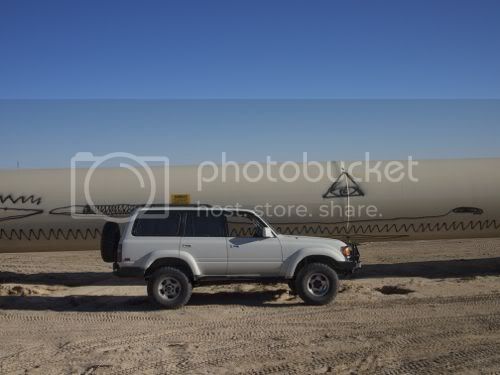

picture request-2 inch lift with 33's
Bingo.
I know how it feels. 33s look cool enough but the extra height really gives you that big-tire-itch...
Here you go. Note - 30MM spacer in front. Actually 3" lift in front with spacers.

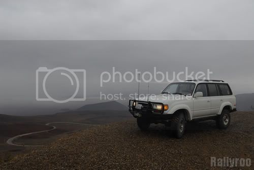

ditto....running 35's on stock gearing as well...OME Heavies....when I bought it, it had 33's. Here's a picture of both for reference. No question for me. 35's and would not look back. only minor rubbing on the flares at full flex but those are coming off soon anyway.
33's
35's

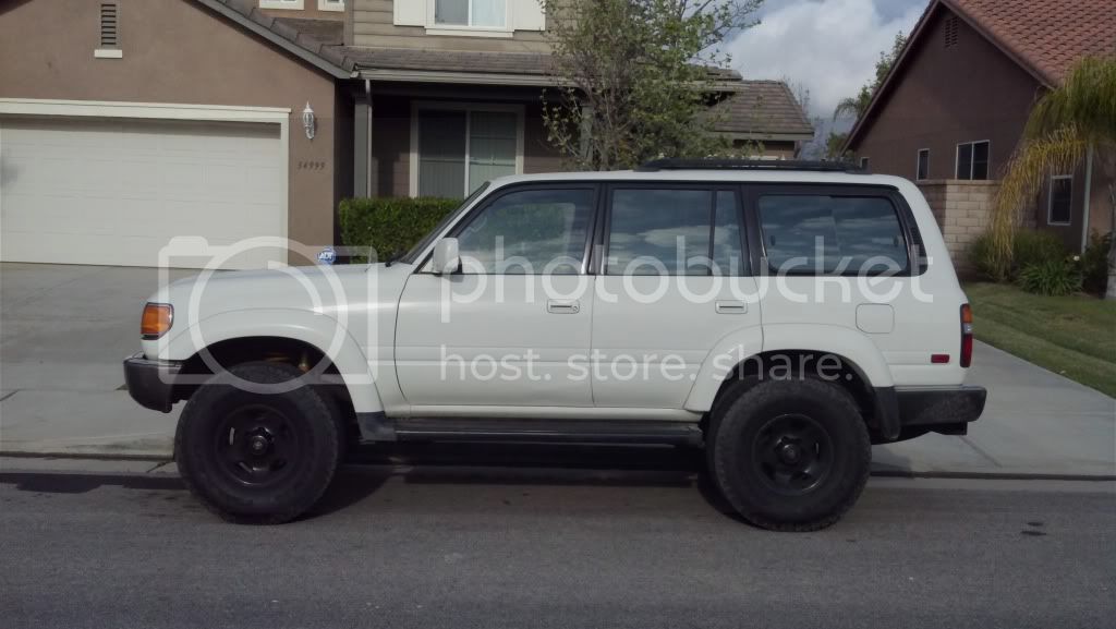

35's and TJM 2" lift:

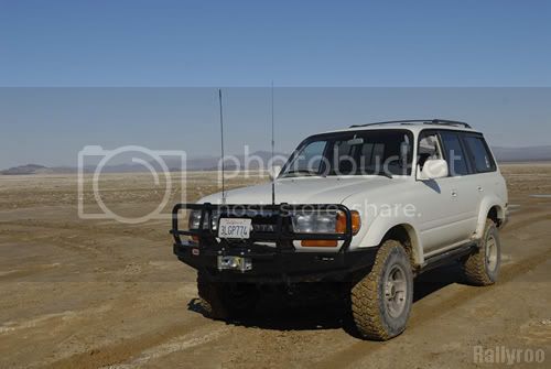

Here is mine 2" Iron Man and 315's. I have driven it up mountains and on every type of terrian and have been very happy with the performance.
