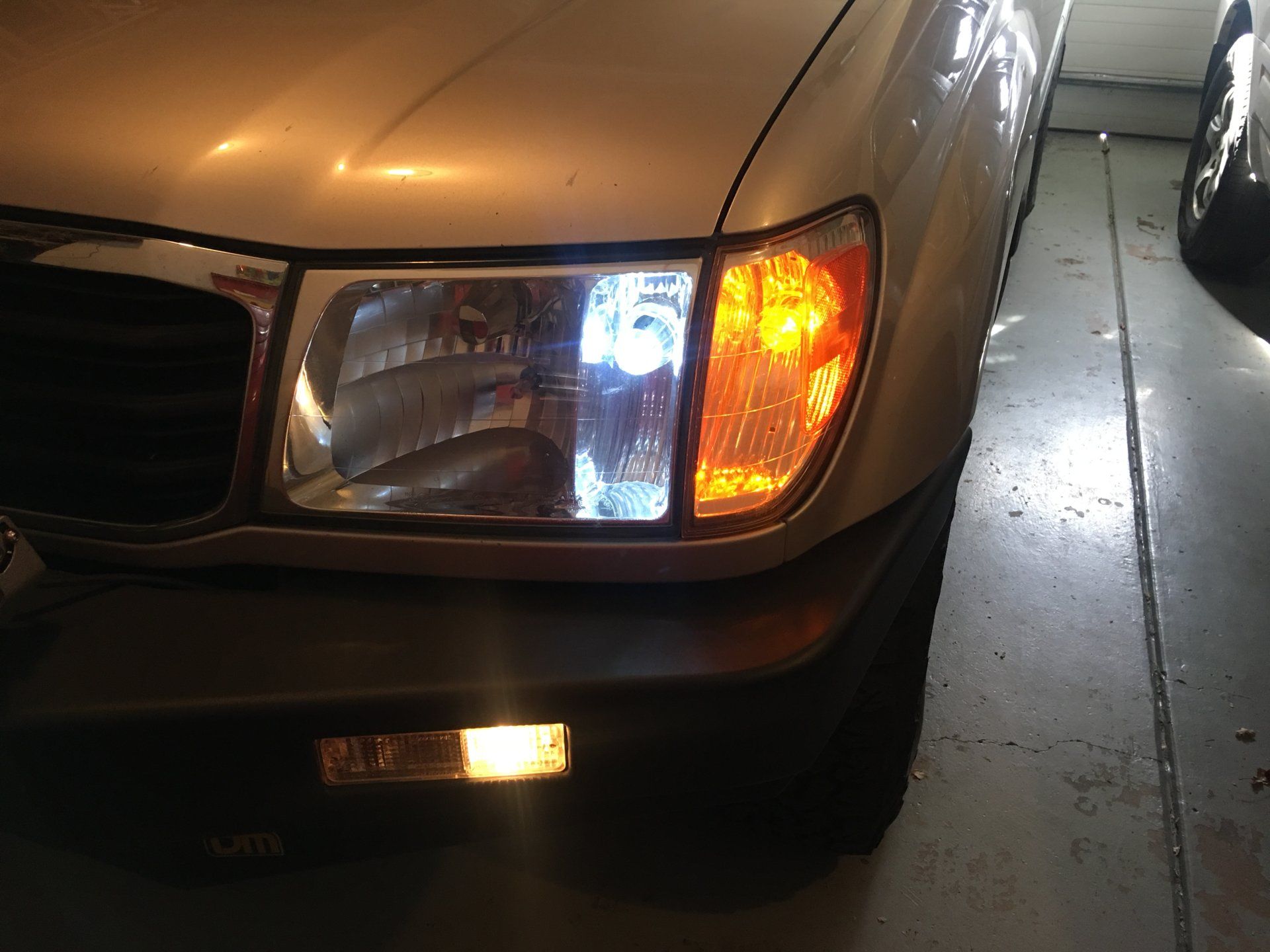

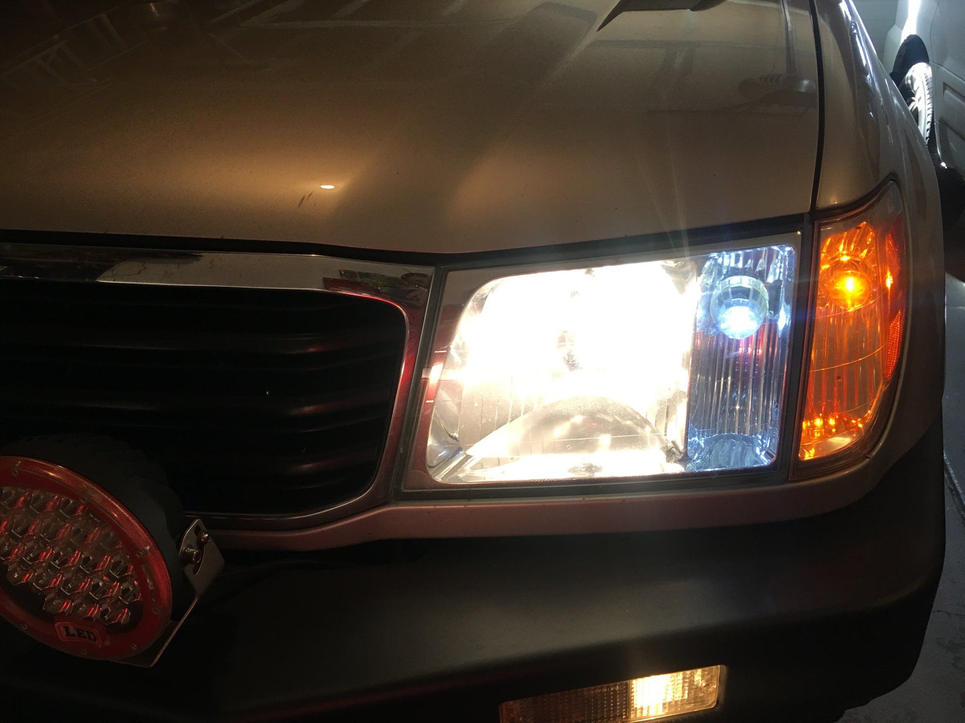

Parking lights are more blues than headlights, but may match a led headlight upgrade better. Option for red map light, Door lights it covers them all. love it; buy the whole kit comes with some spares.
Thanks for the pics!! Red map light to preserve night vision? I guess I could use it like a mobile red light district to pay for all the Slee bumper/skid plates I want

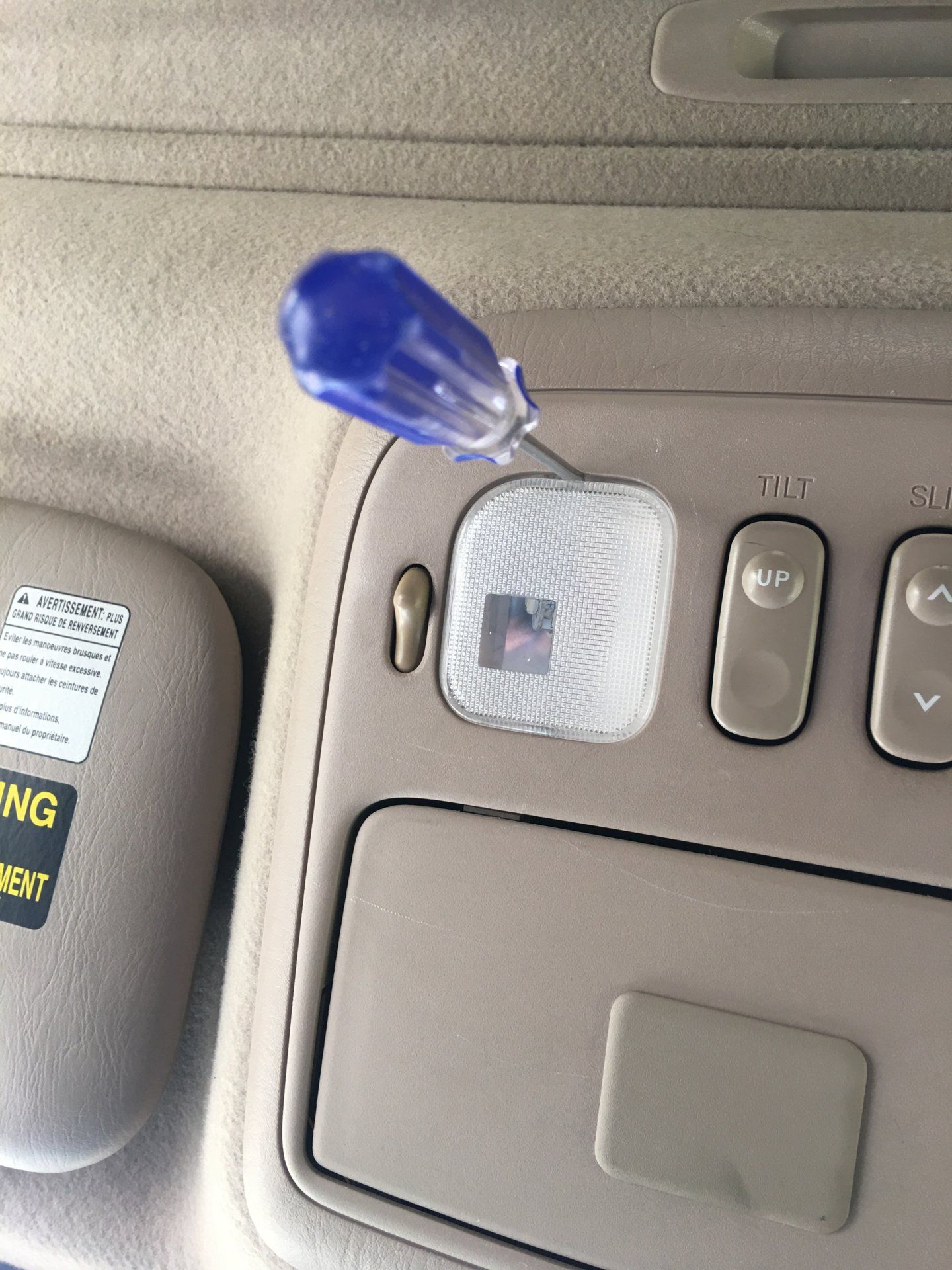

Colo Kid how did you take the lenses of the map lights off so you can change the bulbs?

Didn't ask me, but you need to pull the whole overhead cluster. Open the sunglasses holder, remove one screw, pull cluster down (4 clips). Then there are 3 electrical connectors to completely remove cluster. The map light fixtures are held by screws from inside cluster. Test for correct polarity before buttoning up completely.
Good luck,
Dave
Actually it is much easier. Small screwdriver you can see a small slot. Pop it out and your good . If I can do it you know it easy
Thanks, my eyes are not as good as yours, and I did not see a slot to pry on. I edited my post so nobody follows my bad advice. Sorry.
Dave
Thanks guys! Ill give it a look again. At first glance it wasn’t intuitively obvious.
