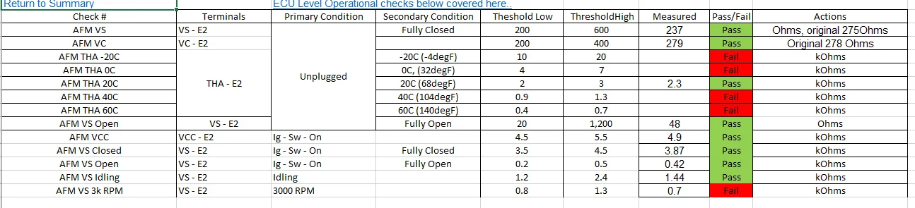

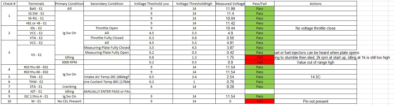

Here are the initial voltage checks.
AFM test... I did test fully warmed up, need to enter that into the sheet...

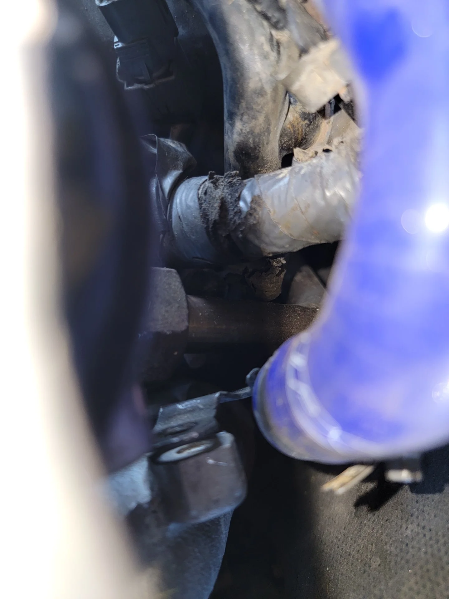

I went through the TPS checks again. I had done it prior but didn't have the spreadsheet so wanted to get the actual values in there. Upon inspection I found this gem...

There is the other angle...
I think that’s the EGR in the first pic. Looks like the wiring loom is a little unwell.
Agreed. A friend offered up a harness in good condition. I am going to spend this coming weekend pulling the old one and making sure what goes back in there is in good condition.
Frank
