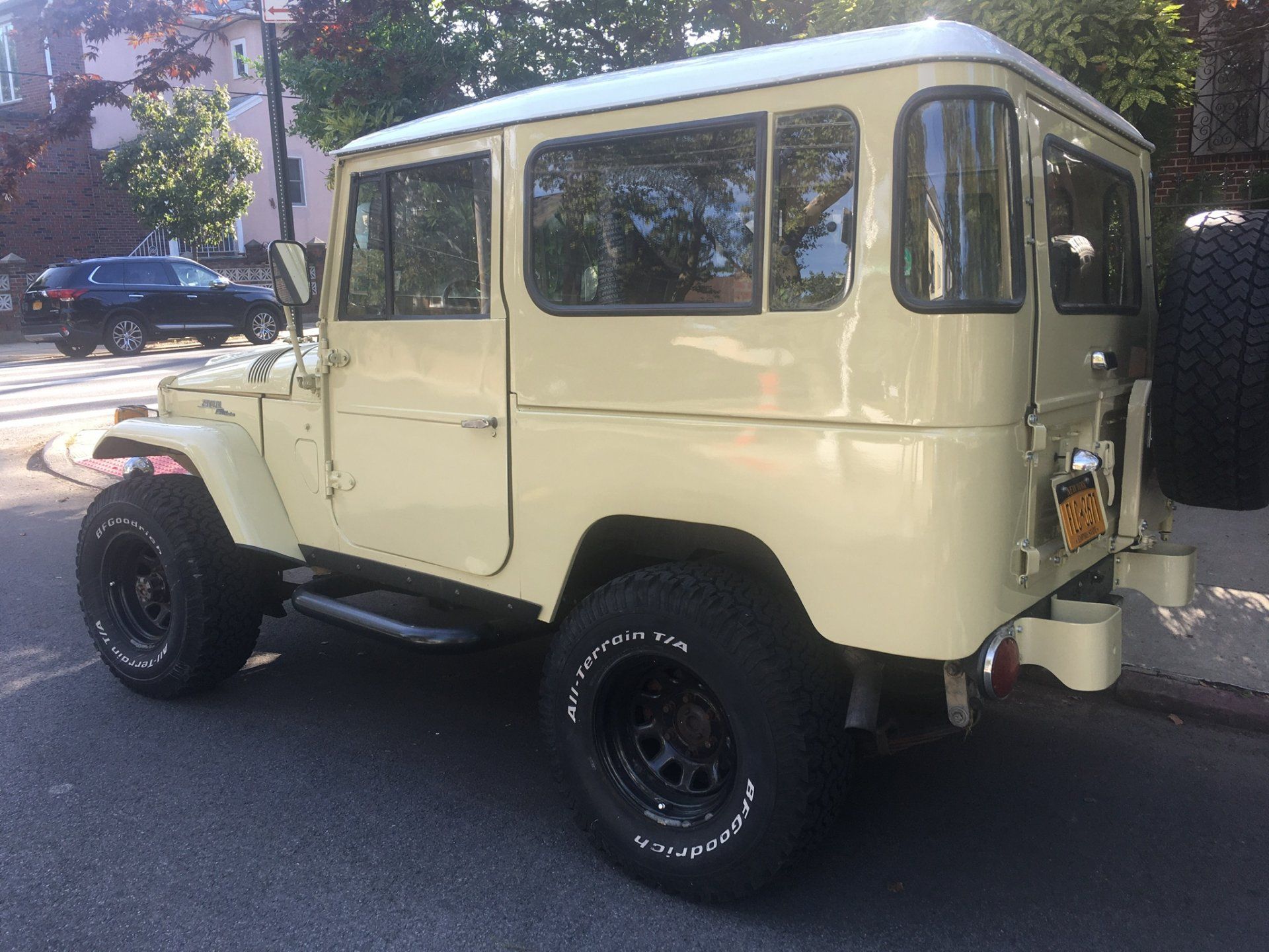

I had less rust than you, but some Bondo and I had my rear sill quarter panels replaced using real steel for both the panels and sill. Body shop felt it was a better way to go because the didn’t know what they would uncover once they started patching.
The real street parts did need tweaking, but overall they thought the quality was good.
With everything off the truck the fixed a few things as well. I guess in the end I wanted a total solution - fix it all once.

Thanks for the feedback - your 40 looks awesome. Definitely one that I would find myself admiring in a parking lot.
I’m leaning towards doing the full repair - quarters and sill - just might have to wait until the fall when I’ll have a bit more time and simply run it without the diamond plate on it this summer as motivation to fix the ugly.
