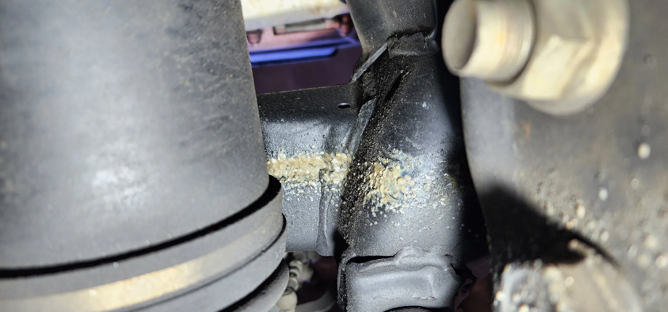

Hello all,
While changing my oil on my 2005 LX470 this morning I noticed a line of white grease that appears to have been slung from the CV joint. I could not find a crack in the boot anywhere, but it can only be coming from there, right?
Possibly a very tiny hold on either side of the metal band. find and clean it well and add a tiny drop of super glue!
