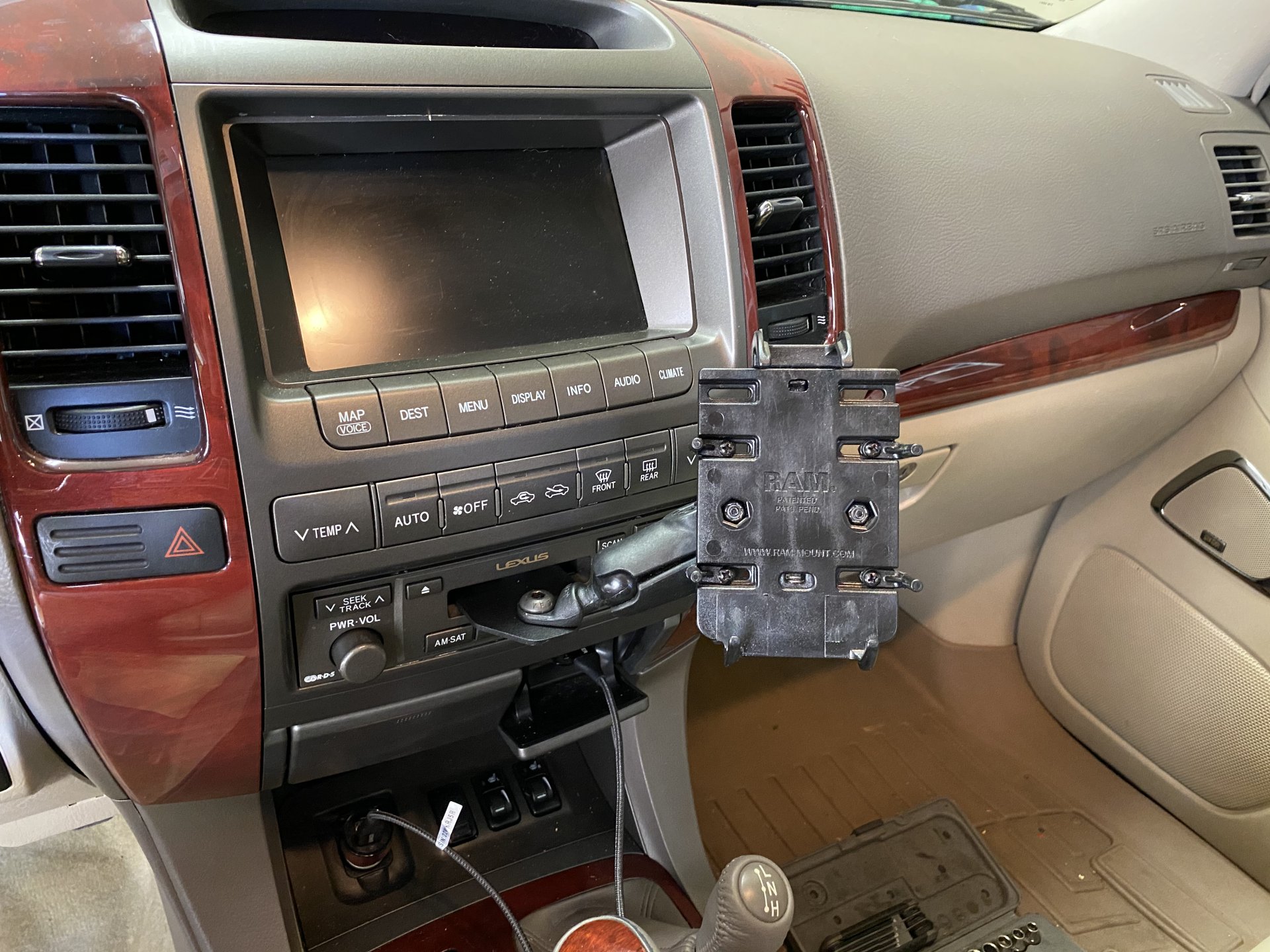

Meh, all you have to do is put a small chunk of rubber fuel line over one of the Ram mount nuts to push against the dash a bit. That preloads the Panavise mount and then it doesn't wobble. I've been running that same setup for years with zero complaints.
I have the Panavise and I am well pleased with it. I mounted a magnetic plate directly to the panavise with scrwes and it is super solid. I would suspect the extra weight and length on the ram mount arm is causing the issue.
I ran it in my Tacoma for a short while and came to the same conclusion. Not even close to rigid enough and a hazard to passenger knees.

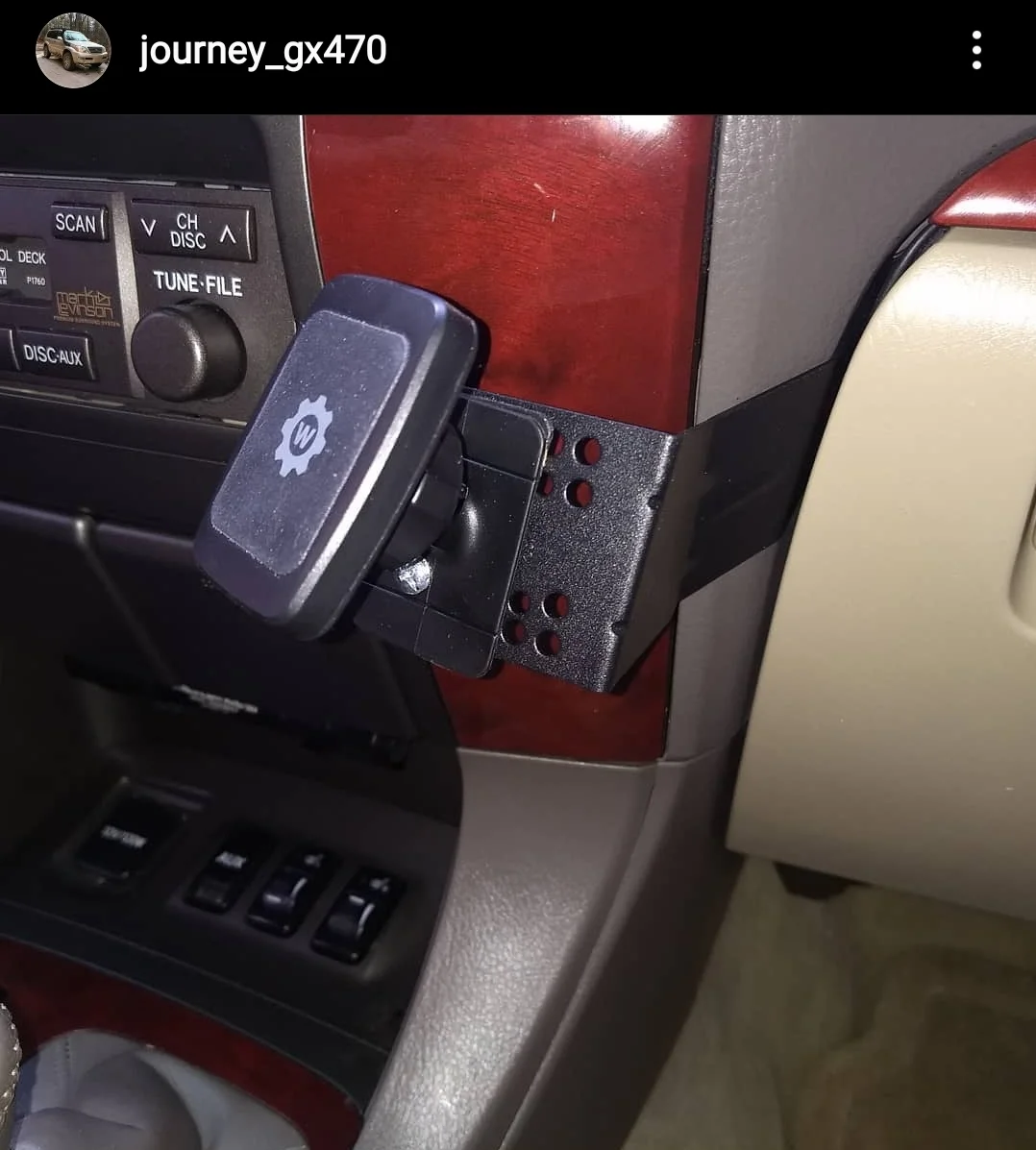

I am running the owl expedition mount in my GX and pretty happy with it. Who needs a tape deck anyway…

This is the first time I've seen this mount and I would 100% go with this over a Panavise. Such a cool product!
